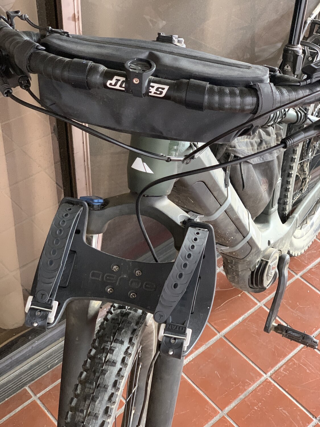

I retrofitted an AEROE dry bag cradle on the fork arch using a diy aluminum bracket. Performs very well.
I like what you did there. Differently food for thought. BTW is that a Supercharger? The LBS is saying that the Jones H Bar cannot be fitted with the Nyon cockpit.

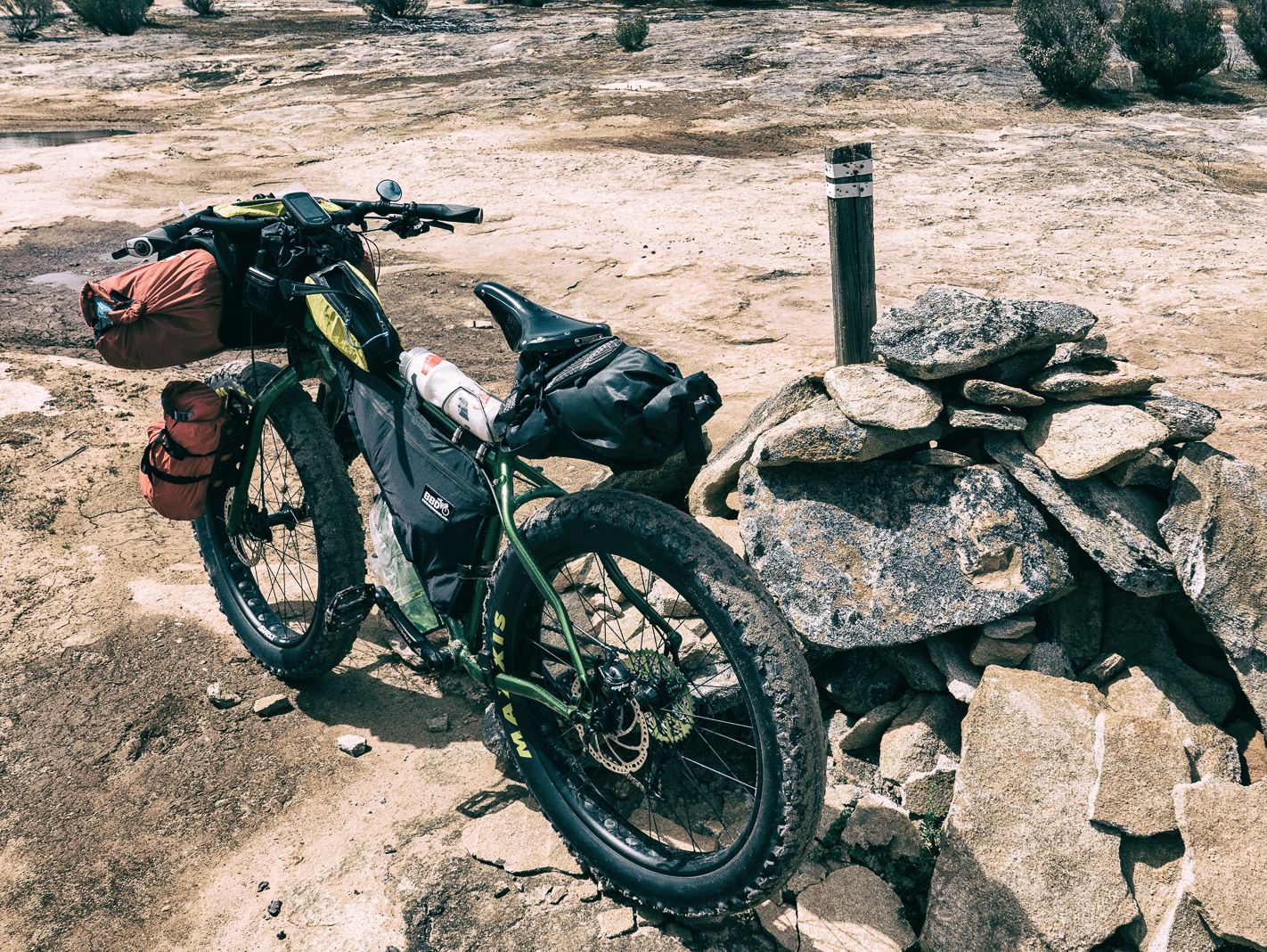

I have used Salsa Anything Cages on my Salsa Mukluk and never had an issue with them. You can see them in the photo in my opening post. Mind you, that is on a rigid fork. I guess I will find out how they go on the suspension fork. Image of an early setup of the bike when I was on the Holland Track in Western Australia.

I am curious as to why the frame bag is an issue on the SuperCharger besides the limited space. I do appreciate that it would have to be loosened off at the top tube to access the battery mounted there. That said, I am not likely to go with a frame bag anyway, as I do travel light, and as I will not have to carry multi-day water supplies on the SuperCharger, I am pretty sure I will have more than sufficient carrying capacity with panniers being used if really necessary.
I have a rack on the Salsa when I have had to carry water for multi-days riding (will not be an issue with the ebike due to the need to recharge and due to a change in route planning). For what it is worth, the maximum water I have carried is 35 litres + 20 days of food, but that was on my Surly Long Haul Trucker with an Extrawheel trailer. The first few days were slow ones, but :)

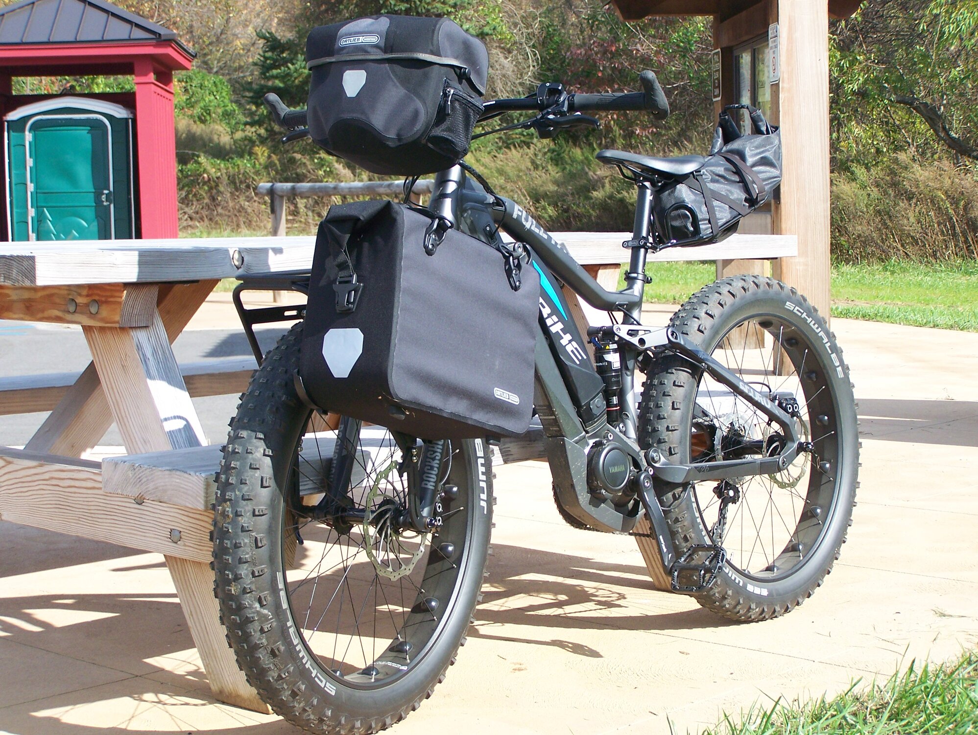

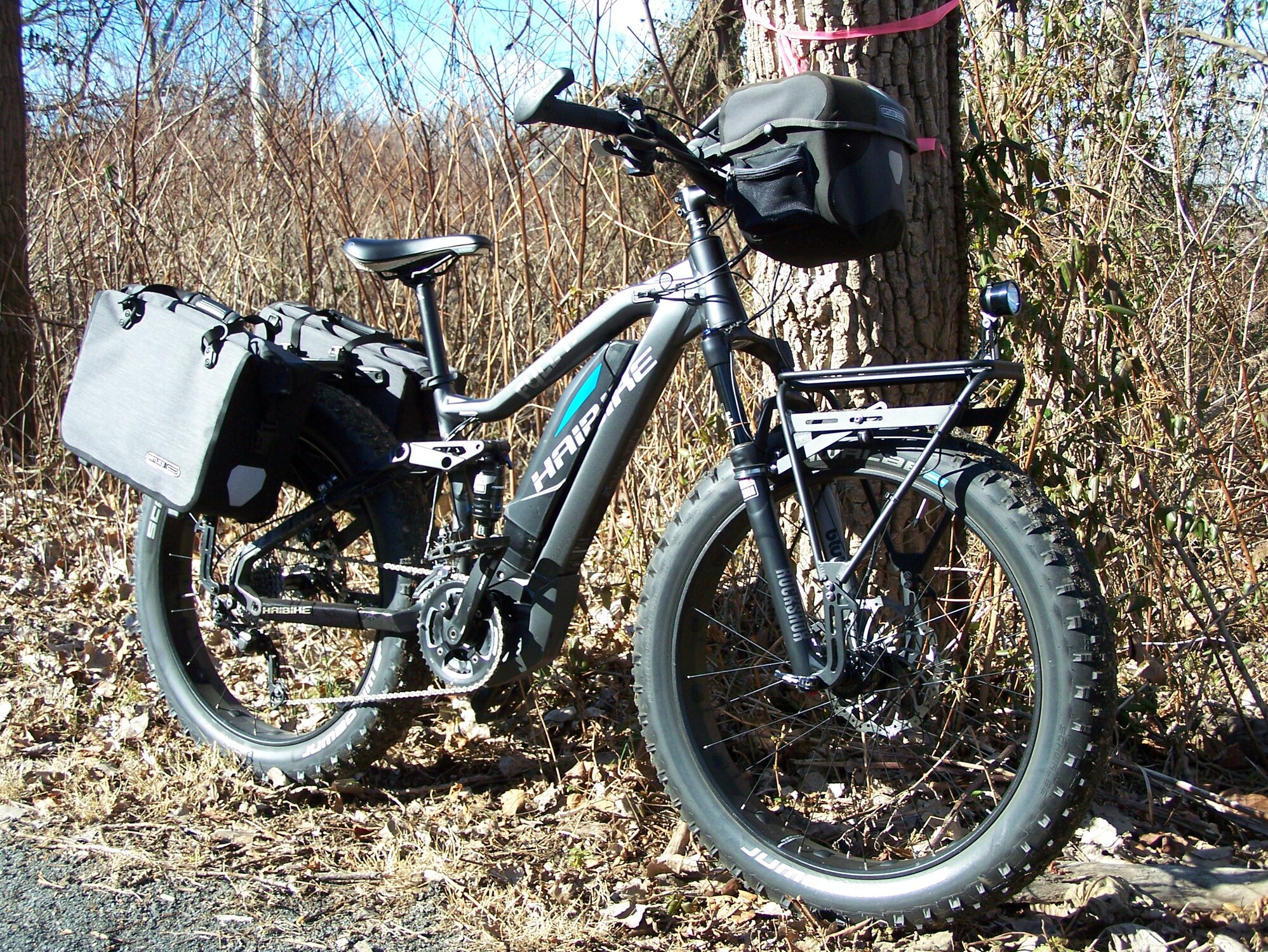

Old Man Mountain Fat Sherpa Racks, Front mounted (photo 1, original configuration) and Front & Rear Mounted (photo 2, my final bike setup).
I'm old school too and find the ease of use and capacity of a good rack mounted pannier beats the new age bike frame mounted bags, 7 days out of the week. Unless of course, you are single-tracking a cliff face with just enough clearance for your bike to go through. ;)
The front and rear racks on my Haibike have their weight of rack, bags and gear placed directly on the special made thru-axle that go with this brand rack. The stays just steady things upright. Note, the front rack is mounted on a Rocks Shox Bluto suspension fork.
I use the front rack for my SON28 dynamo powered headlight, while the rear sports a SON tail light.
I figure the way I've outfitted this Full FatSix, it is a go-anywhere bike, minus fording streams and other waterways (Ebike No-No). Snow, sugar sand, gravel, asphalt and concrete roadways, it matters not.

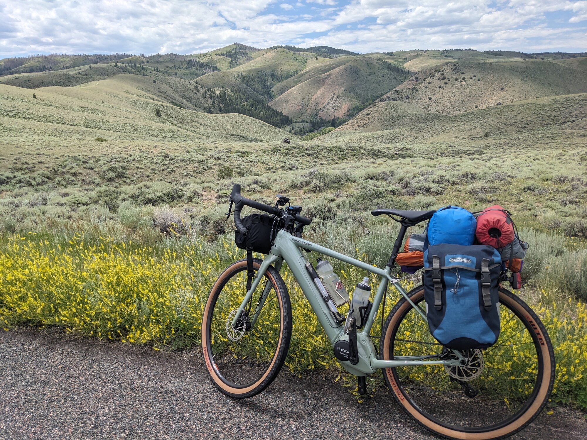

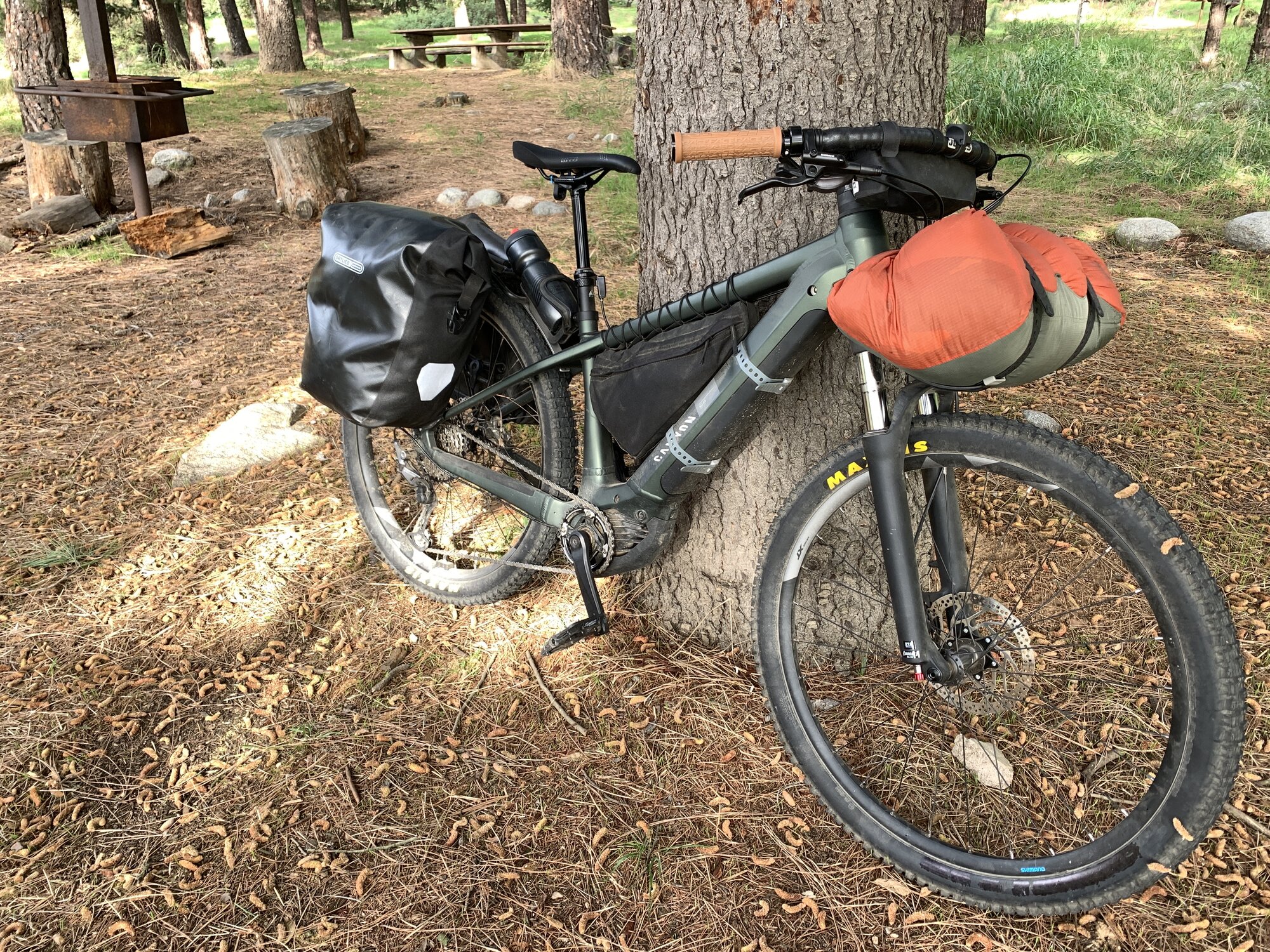

I’m a long-time bicycle tourist with a new e-bike this year, a Cannondale Synapse Neo SE. The bike, which no longer appears to be available, is a 650b gravel bike with Bosch mid-drive and 1x11 SRAM drivetrain. I got very lucky and picked it up a my local REI for about $2000 off, as it was a return from someone who rode it once in 2020.
This summer I loaded it up for an overnight tour in Wyoming. The tour didn’t turn out as planned because I made a stupid wrong turn, but I did ride the fully loaded bike 27 miles with 1800 feet of altitude gain, at up to 35 mph, on paved and unpaved roads. The bike rode really nicely, I must say, and there were some steep sections.
I’ve been touring since long before bikepacking was invented, and I’m sticking to conventional panniers and racks - or I should say rack in singular, as the fork has no eyelets. So everything went on the rear Blackburn rack: Ortlieb panniers, tent, bag, pad. Carrying those items plus my usual selection of overnight gear including dinner and breakfast, total bike and gear weight was about 68 pounds with empty water bottles. I did not take the charger. At only 4 pounds heavier than my loaded Salsa Vaya, it was lighter than I’d expected. The bare Cannondale is a 40-pound bike.
It’s been years since I rode with that much weight in back and just a small handlebar bag in front, and I expected some instability. But the bike rode fine, remaining stable at 35+ mph.
