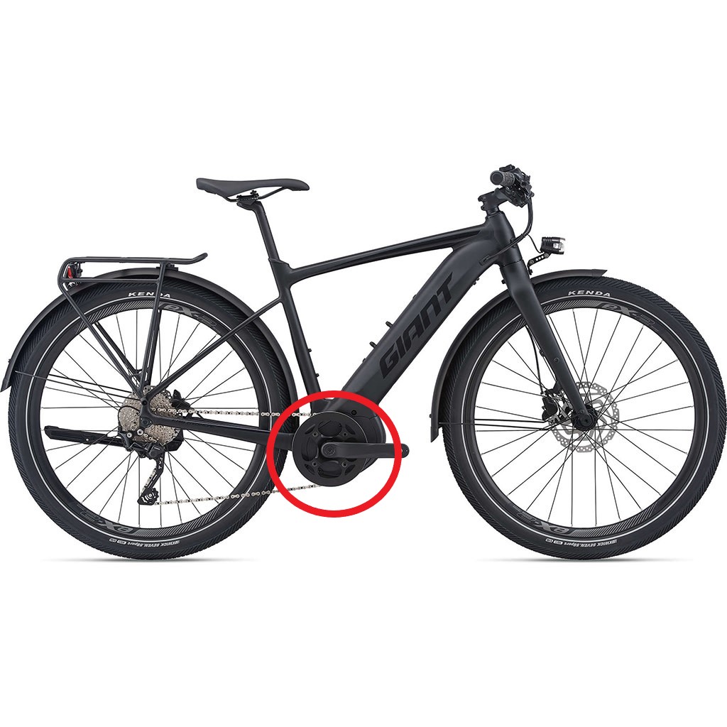

Was wondering where to search bigger chain rings, availability is very poor locally in Finland.
I'm also quite new to bike hardware and parts so I don't know which front chainring would fit in my bike.
I know it's fitted on 4 screws and that the original chainring size is 42, id like to go for 48 to 52~ish sizes, the prices for some models are ridiculous
and I wouldn't like to risk buying 150$ chainring that doesn't fit. 🤔
Any recommendations for retailers around EU and some help for finding proper chain rings would be greatly appreciated!
Oh and also, if I buy a bigger chainring, does it mean that I would have to replace the existing chain as well?
Thanks

118 chain links would do? How many are there in your existing chain @Kondekka?

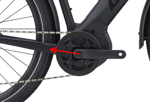

The second matter is: will the large chainring fit your frame? Because I doubt it. The 48T, 104 BCD Decka's chainring has the outer diameter of 203 mm. Use a tape ruler and check if the big chainring would not hit the chainstay before you spend your money... (It is very easy to give advice without seeing the e-bike).
More than 102 mm?
I haven't checked how many links I have, manufacturer lists that the product originally has 122 links, I think it's less than that after installation though. 🤔
I do need to make sure that I have room in the frame for the chain ring. I'll make sure to do that soon. Thanks for pointing this out @Stefan Mikes.
If you increase the chainring size from 42 to 48T (if doable), you need to increase the number of chain links with 6. It means you will need a 11-speed, and probably 138 links expensive e-bike chain, and shorten it to the proper length.
I've been busy lately, but I did check the bike... Not looking good, there's probably 1-1,5cm of space for the chainring. I would have to start hammering the frame to fit a bigger one.
@Stefan Mikes thanks for saving my ass again :D... I'll have to re-think my plans. I probably have to give up the idea completely.
