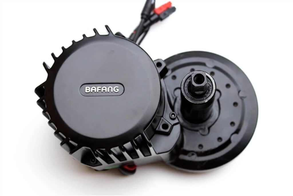

Luna sell a bare bones BBSHD motor for $499 to upgrade a BBS02 bike. It’s supposedly a direct easy swap. So if you can find a decent BBS02 based bike for a good price you can easily upgrade it to bbshd.

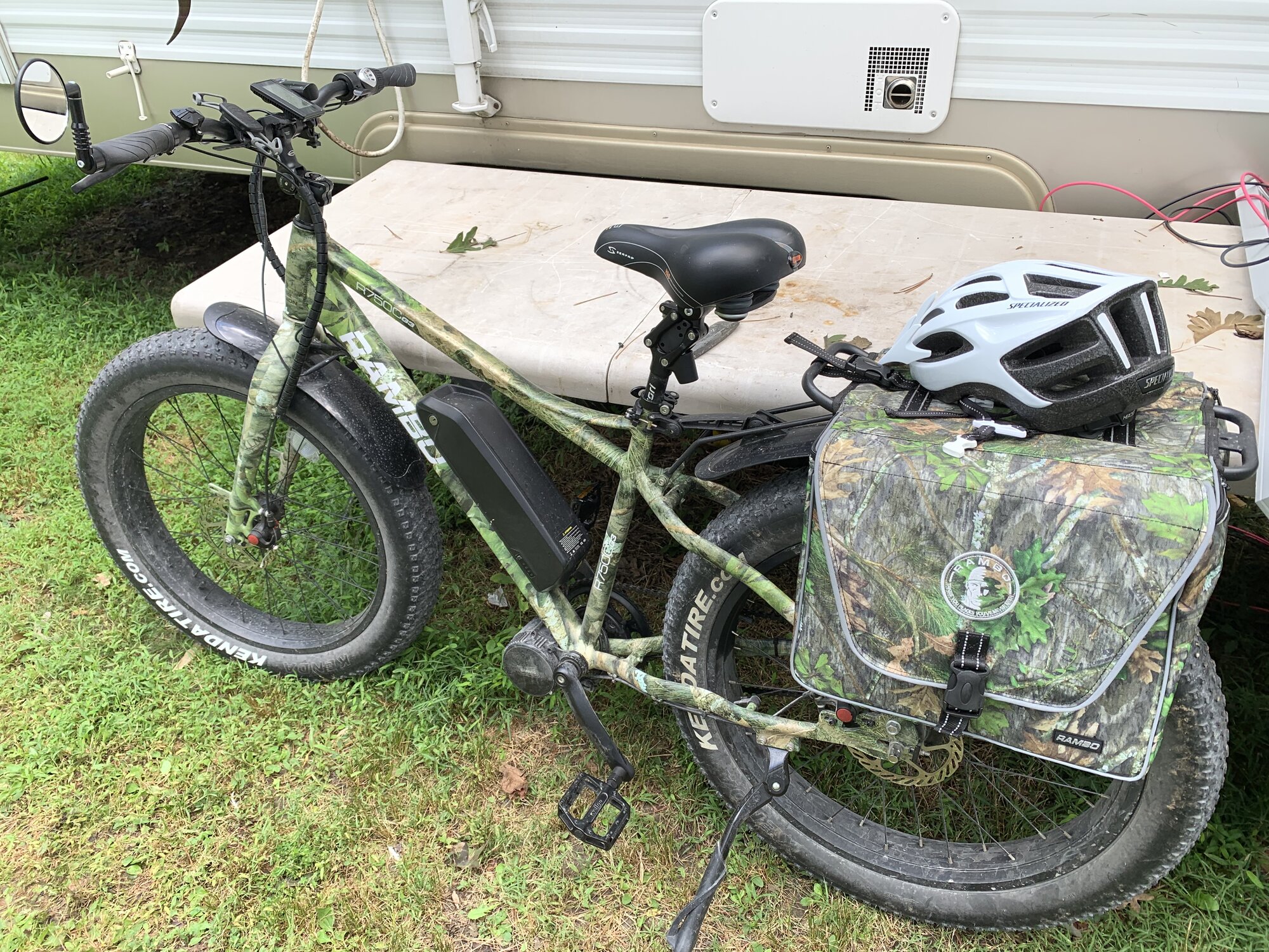

Mine is a 2018 Rambo r750g3. It was low geared for off road riding and pulling game out of the woods so I had to upgrade the front sprocket to 52t for road speeds. I was fortunate that a hunting/archery shop stopped carrying the Rambo’s several years ago and he was just trying to get this one out of his shop. I got it last summer for $1200 and plan on eventually upgrading to a BBSHD. I did put a comfort seat, suspension seat post, adjustable stem riser and swept back handlebars on it.
I also just ordered a spare 48v 20ah battery for it and the parallel cord with Anderson connectors to run that battery and my original battery in parallel. So I’ll have 30.4ah to play with now. https://bafangusadirect.com/collections/all/products/parallel-battery-connector-cable

I found someone locally who builds Bafang bikes who had the cable and the custom Luna coding box who removed the Rambo 19mph speed limit programmed into their controller for me, and put a 25mph limit in it instead and changed around the 1 through 5 assist levels. Big improvement.
I also added 3/4” spacers between the pedal crank arms and the pedals so my heels wouldn’t keep hitting the crank arms with every rotation.
I also replaced the original Juggernaut tires with Origin8 Supercells for road use with less rolling resistance. They retail for $50-$90 each online but I found an unused pair on FB Marketplace for $20.

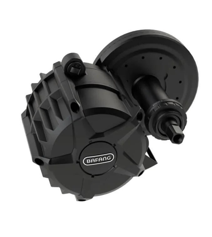

your Eunarou is a better than the Rambo and has some extras but your mistaken on the torque sensor, Eunorau Fat HD have a cadence sensor,speed sensor and a gear sensor,the BBSHD motor cant support torque sensors. One other thing to note is Bafang have just updated and changed the shape of the 2022 BBSHD,how this will effect getting parts and replacement motors in the future is unclear right now, who knows,maybe they will be interchangeable?
if the bike has an integrated motor frame like that Accolmile posted above the BBSHD will not fit,the cavity is to small, for your Rambo its an easy direct swap!
View attachment 92708View attachment 92712
In the 2021 update i think they have a torque sensor (how this is possible with bbshd) idk according to electrified review. Maybe new models have torque sensor?
Thanks for the tip didn't even notice the motor was integrated with bbs02 may over heat in there as well. No wonder it looks smooth. Ashame looks don't equal function. They said they could have to me in 3 to 5 days...smh always something d@mn d@mn d@mn!
Nothing against Brent he is awesome but not known for super accurate specs lol, they are wrong,they don't mention what motor is in that bike because they don't even know it's a BBSHD,they probably thought it was an m620 but i can tell you100% the bike will not have a torque sensor. I also own that bike, that's just a grey Biktrix HD lol,the brakes are still labeled Biktrix! You cannot have a torque sensor on a Bbshd or a Bbs02 but the g510/m620 and m600 are torque sensor.
