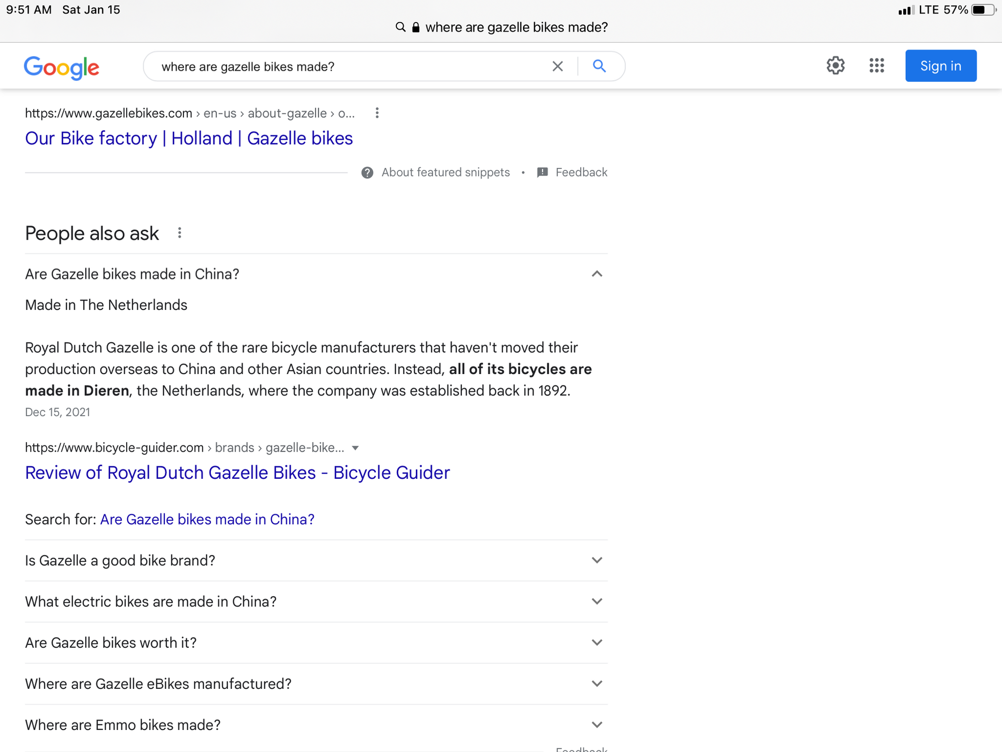

Maybe you should do research before you speak next time….
Yes and Moustache bikes are "assembled" in France. Nevertheless many component parts are "manufactured" in China so what does the term "made" really mean? Also I think you really need to test ride a few of those bikes to find out how diverse that group really is.
I’d guess shimano stuff is made in china but bosch stuff is made in hungary and frames are made in the netherlands. There is likely no bike 100% non china made due to what parts are needed but the gazelle has a way higher non china content then most and it’s built in the netherlands.
And you are right , there are many choices and not one bike fits all. I’m sharing my experiences with this model. Like me, do your research and decide what best fits your need.
