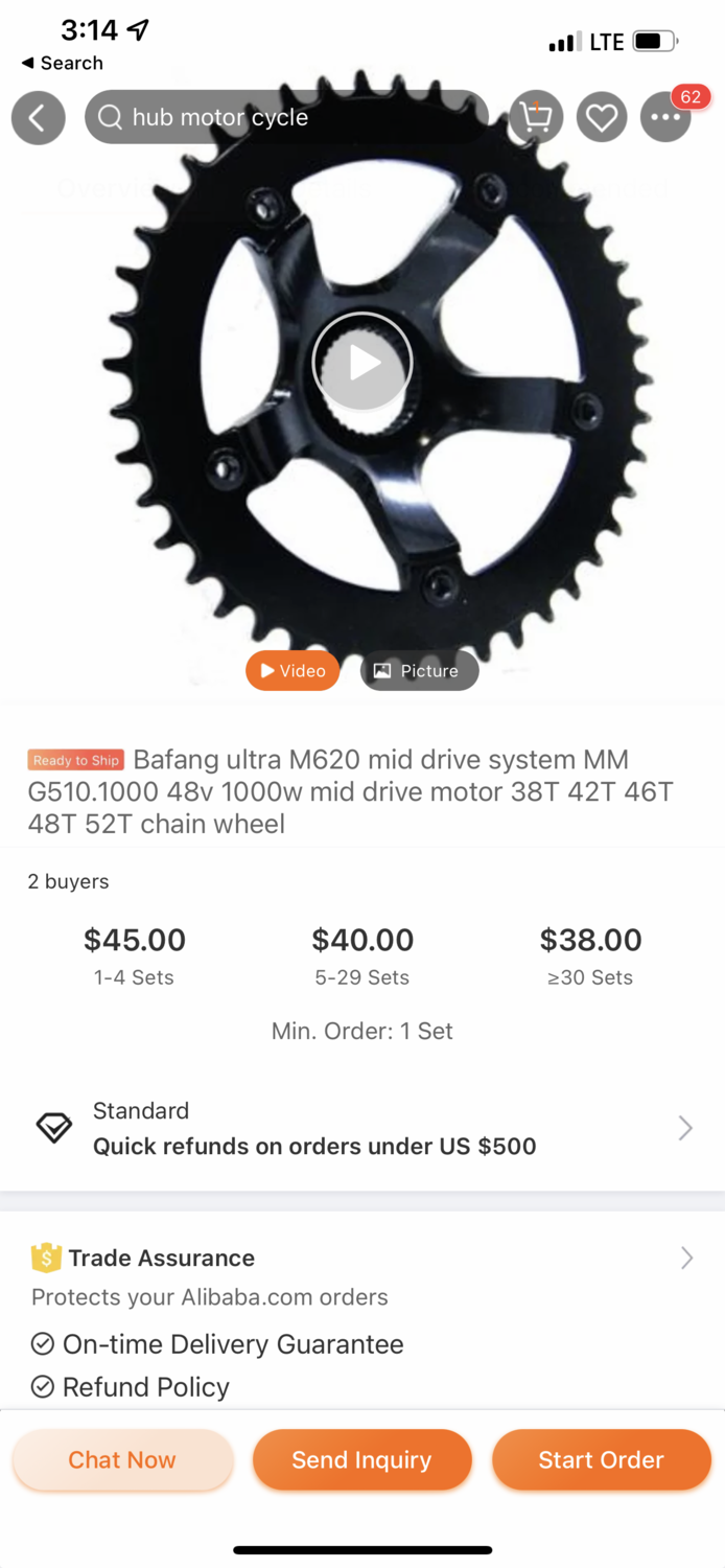

Question i saw that you mentioned getting a 52t chainring for your biktrix ultra, i have an fs pro and want to upgrade the chainring as well. Is there a specific type that i need to buy? Not sure if you remember where you got yours but if you do that would be helpful so I can buy the same one. Also any issues at all with fitment or reliability etc? I found this on alibaba do you know if this would fit? Thank you for any help!
