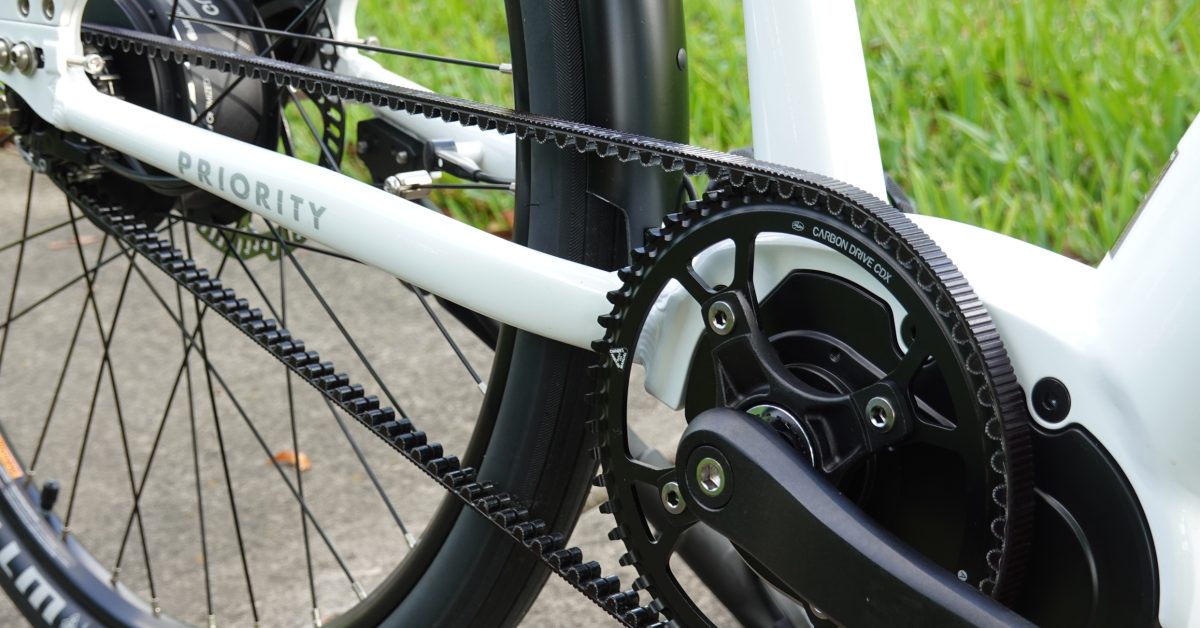

A timely article from Electrek regarding Belt Drives. ;)
Advantages of belt drives on e-bikes
Firstly, belt drives are incredibly low maintenance. Unlike chains that require frequent oiling and cleaning, belts can largely be ignored. If you ride through thick mud, it’s probably a good idea to knock the dried wads out. But other than that, you’re pretty much good to go with some good old-fashioned neglect.
Next, the presence of a belt drive usually means you’re going to get some kind of neat-o internally geared hub. Since you can’t use a standard derailleur like on a chain drive, you don’t have to worry about adjusting your deraileur and messing with finicky gears. Instead you’ll likely have some cool hub like an Enviolo CVT or maybe even a Rohloff if you bought a really nice bike.
Some belt drive e-bikes, especially the more affordable ones, stick with a single-speed setup. That’s how the Ride1Up Roadster V2 keeps the price below $1,000, by the way. So you’re out of luck with those if you were hoping for an internally geared hub. NuVinci continuously variable transmissions from Enviolo rock!
Even without maintenance, good belts simply last. Gates Carbon Drive, maker of some of the best e-bike belt drives out there, has systems that can last for 50,000 miles (80,000 km), believe it or not!
Belt drives are also cleaner, which is great for commuters. You’ll never get a grease mark on your nice slacks or ankle.
They’re smoother and quieter too – an important factor for e-bike riders that enjoy the quiet nature of cycling at speed with barely the whirr of a motor in the wind.
