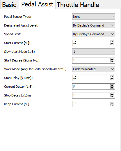

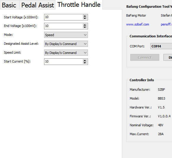

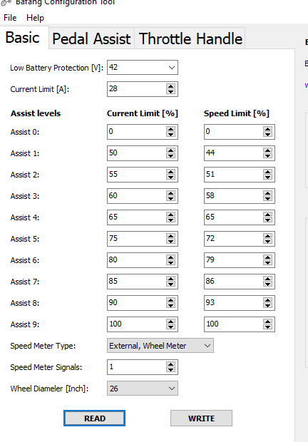

these are the controller setting the BBSHD came with

I'm confused - are we talking about the battery or the controller?
I have changed a couple of parameters in the controller settings that were set to values the main programming guide didn't recommend https://electricbike-blog.com/2015/06/26/a-hackers-guide-to-programming-the-bbs02/
