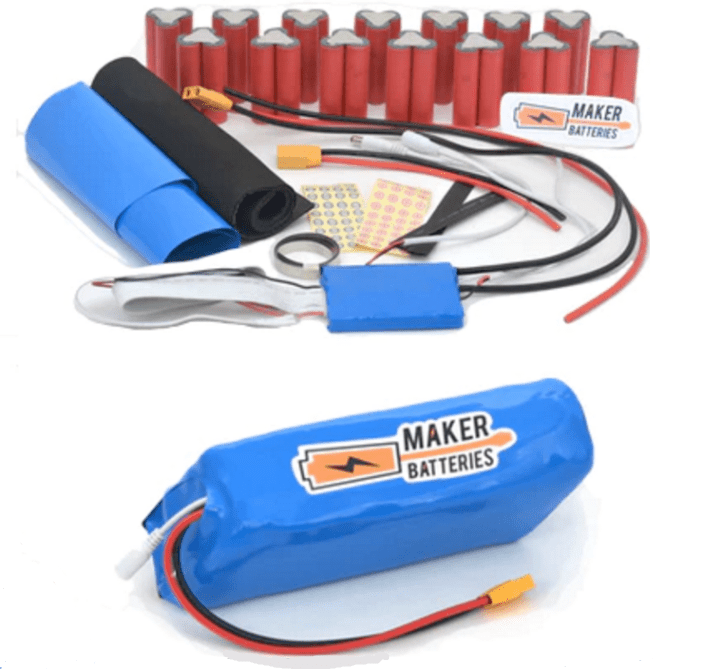

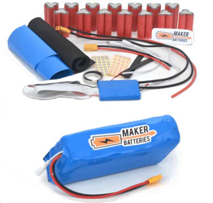

This was a Micah Toll failed kit. But an interesting technique. My sample has never been finished. We’ll see how my 100 5 year old batteries, stored in 50F, test.

Isn't this another Mikah kit?
It doesn't look to have gained much acceptance.
Oh FFS. Isn’t that what I wrote? ;) Whose looking for acceptance? :rolleyes:That was 5 years ago. It went nowhere. The pricing was the issue for most. Look back and you’ll see I typically discourage building DIY batteries!🤭
