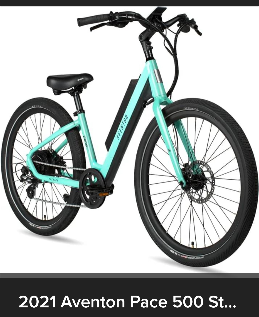

Battery for the Pace 500.2?
Exactly what I am thinking. I need him to clarify things. Thanks for the heads up. I remember mentioning to him that the Demo probably has a weak battery blah blah. Then he mentioned v2/v3. And then I know the v3 would need an adapter or conversion to fit the Pace 500.2. Now that I know all this maybe ask him for a better v2 battery OR just use what’s attached and I will use my Core battery as well. Hmm.

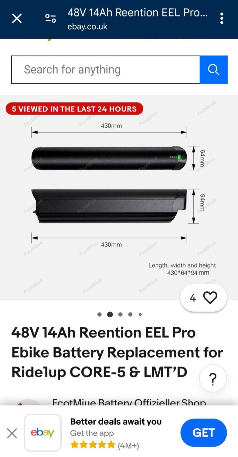

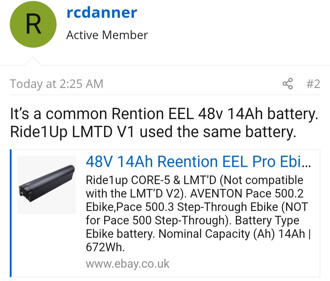

The Reention EEL battery and the case is standard, and you have lots of options for purchasing another one.
And if you don't need extended range, the smaller (less Ah) batteries are both cheaper and lighter.
The Only problem with the older version is that you can't use it on a V3, but Pace 500.2 doesn't use it anyway without an upgrade.

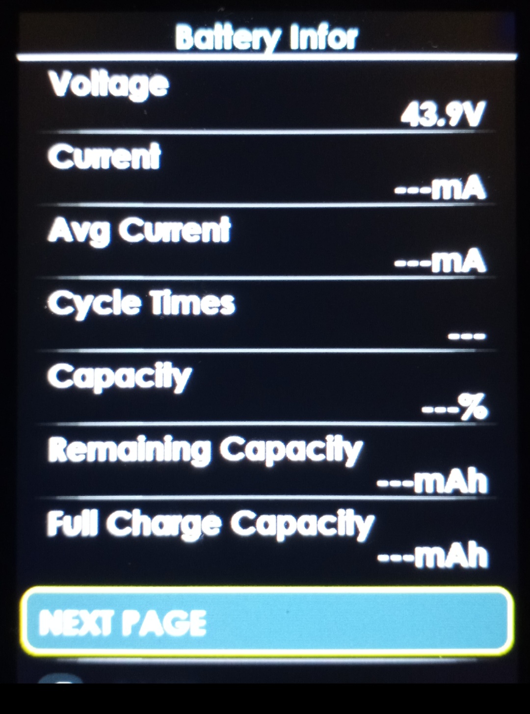

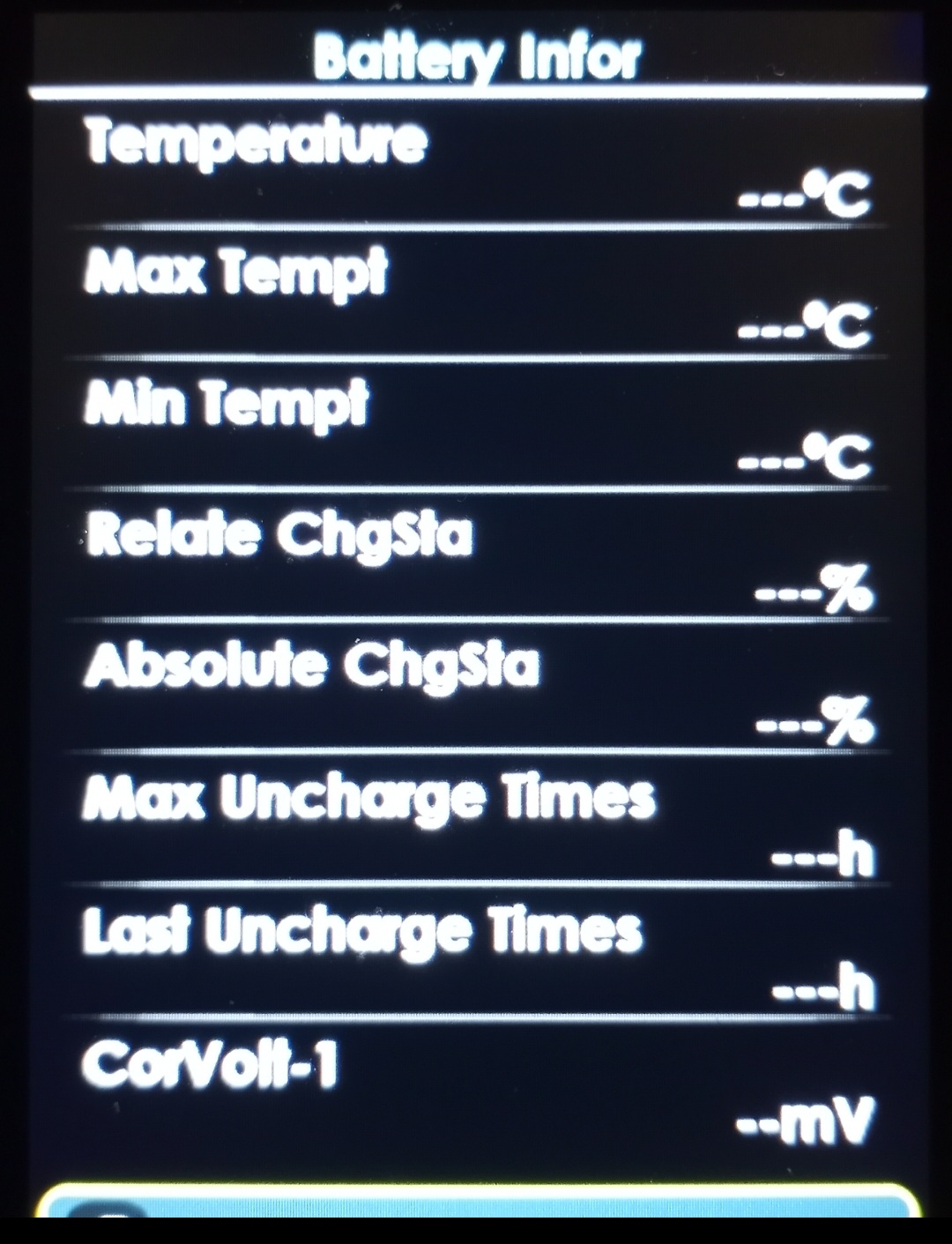

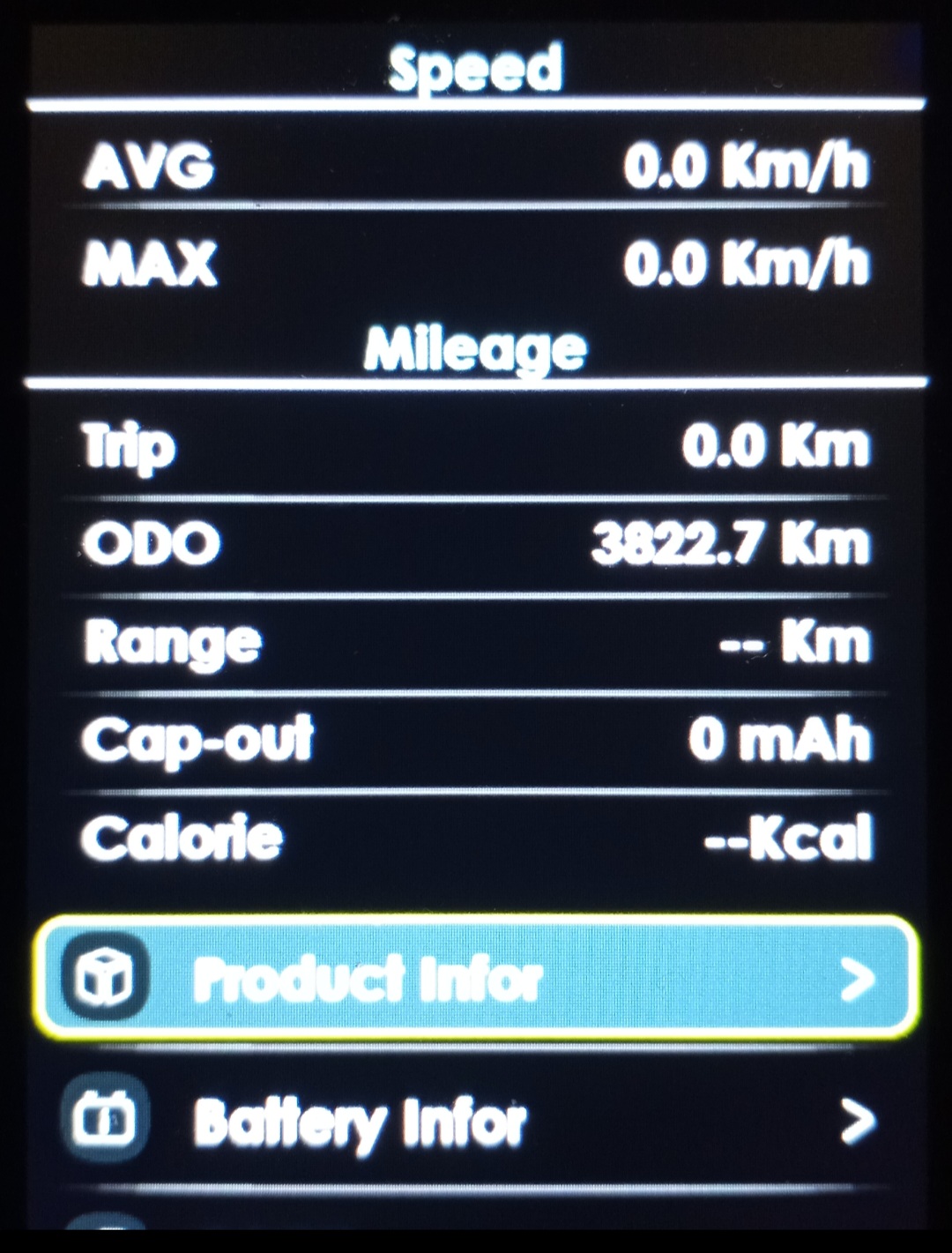

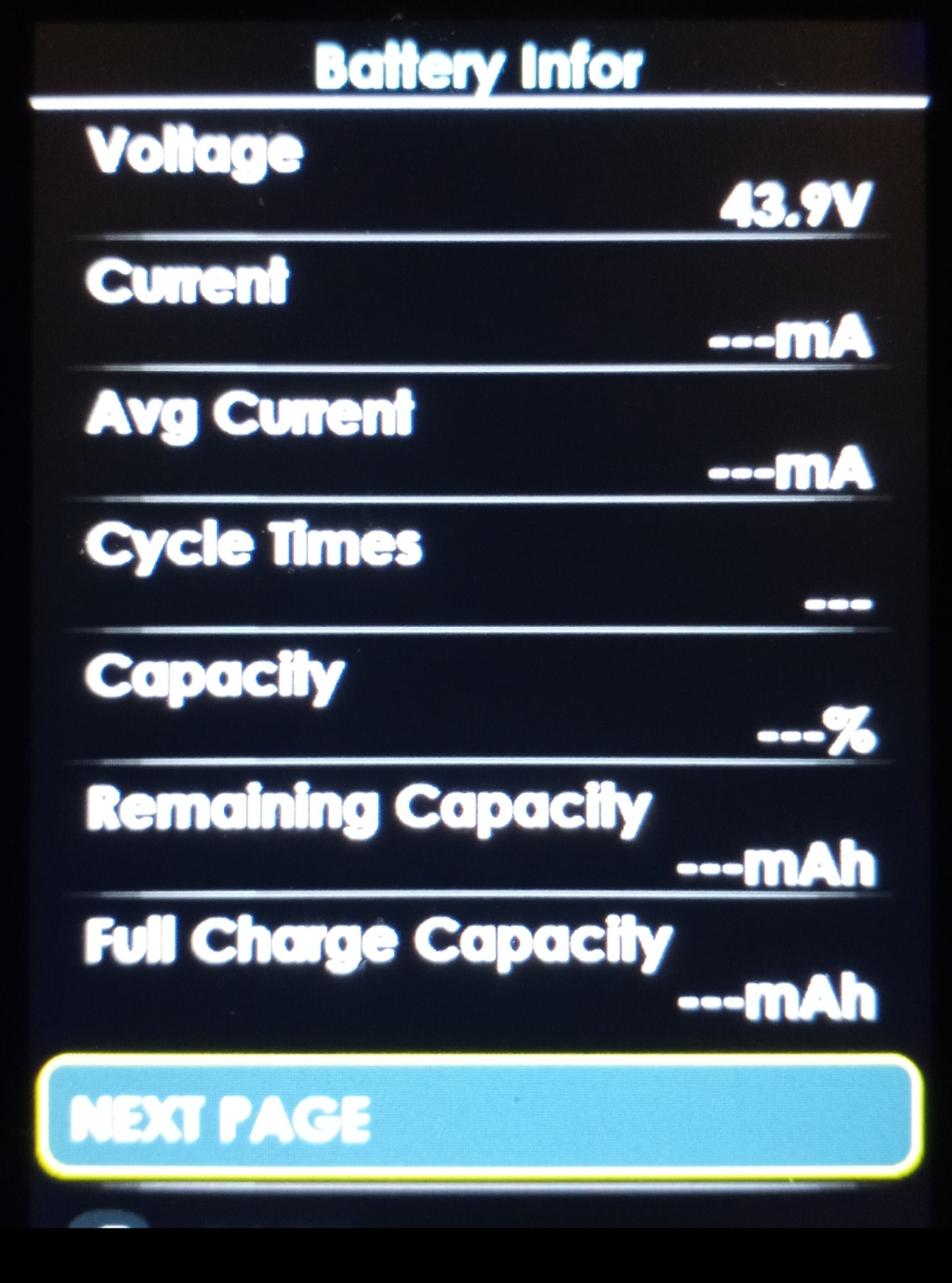

Ohh, and if the controller can communicate with the battery, the battery can be monitored for lots of things.
My display can tell me a lot about my batteries, and know which battery I'm using, but my battery doesn't have the communication wire,..

(PS,.. I don't need all that battery info. Not having proprietary software in my batteries is worth the trade-off for me.)
