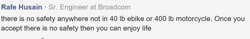

I guess there are different points of view on safety.
http://www.hybridandelectriccarnews...husain-40c3-q-ebike-transportation-innovator/
