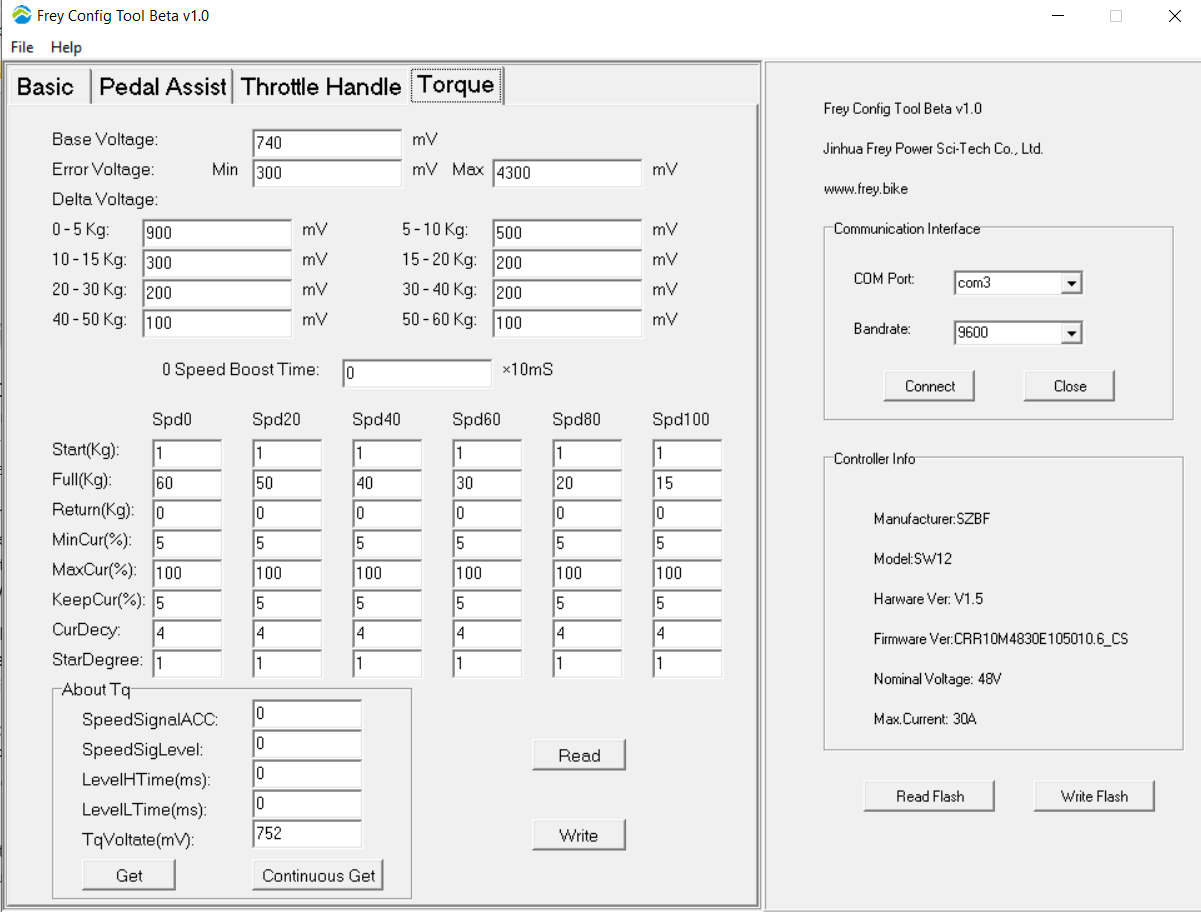

So recently I decided to scrap all of my original ideas, which all seemed to dead end, and try something completely new. I went back to all of the original settings, and when I test drove that, it reminded me how bad those setting really are. No point detailing, if you're reading this you likely already know....
So I spent an entire day working to improve them. Some stuff worked, some didn't. Some seemed like a move in the right direction, some the wrong.
So I started looking for a "my favorite" setup, the whole thing, that looked like it might work for me, with the idea I could trim it here and there. All that messing around did teach me enough to have some very general ideas of what I was looking for.
Enter the Frey "Smooth" programming, found here (using a Google search), towards the end of their very informative article (page 11 of 16).
frey-bafang.patransformers.com
The early part of the article provides some of the latest thinking regarding each line item for all 4 of the pages, including the pages populated with the Bafang supplied settings used on recent motors - up to the point they employed the "pedal first" technology I believe.
Anyway, I installed the "Smooth" set up pretty much line for line. The entire thing, then I test rode it. BIG GRIN!!!!
I believe MANY guys will REALLY enjoy it. It is so civilized, very powerful, makes riding much more intuitive..... well, I could go on, but it would be easier to say I think it's worth a try to anyone looking to improve the stock Bafang setup without going over the top.
Seriously, start here.....
I did make one notable change, and that was to program PAS 0 like most would program PAS 1. So there is NO PAS 0 on my bike (with no throttle or PAS). I decided I would much rather have 6 PAS levels than 5. Personally, PAS 0 is something I never use! On the Base (1st) page you are given the chance to program PAS 0 though PAS 9. If you are using 5 PAS levels (as I believe many are), you would be interested in PAS 1, 3, 5, 7, and 9. Programming PAS 0 adds another to that list.
I lowered the value used in PAS 1 a hair for PAS 0, to 11, then adjusted PAS 1 to 16, PAS 3 to 23, and adjusted the rest (5,7 and 9) to bring the rest into alignment.
Works great.... At low speeds, I have a little better control now over how much power is being used. Prior, I rode mostly on PAS 1 with occasional 2, and 3 on big hills. Now, I can use 0, 1, 2, 3, and 4 on the big hills. I went from 3 PAS settings that I use frequently, to 5. If that makes any sense.....
Only a few miles on the set up right now, but all I see is BIG improvements, with no downside. -Al
SMOOTH TUNE
The "Throttle Handle" page has a lot of personal preference settings that will not affect the "Smooth" settings.
