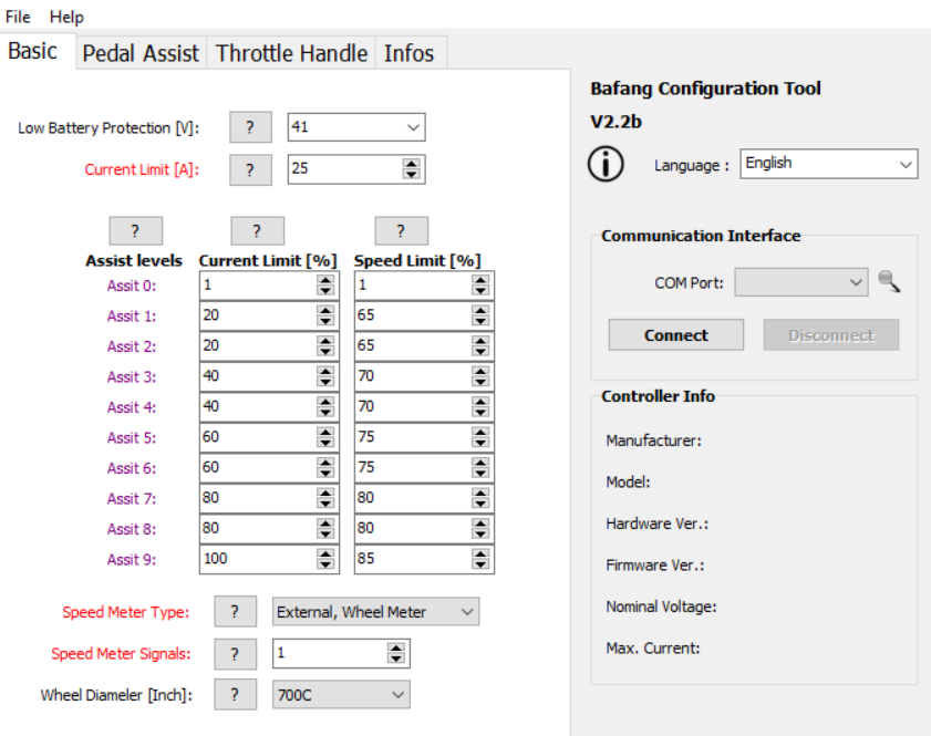

You can resolve it without knowing exactly the mapping if you have chosen 5 PAS in your display settings by just doubling up the levels as follows (this will cover any situation where the mapping is not as expected):

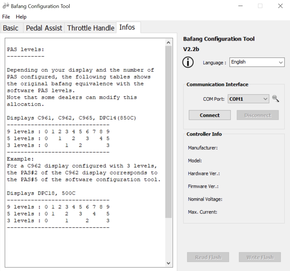

Its important for people to realize how the display maps 5 levels from 9 levels in the controller varies by display. This tab is available in the Bafang Config Tool illustrating some of the differences. And I bet they can be expected to drift if there is a firmware change.
I have two DM03's and two DZ40's and all of them mirror the 1/3/5/7/9 conversion.
