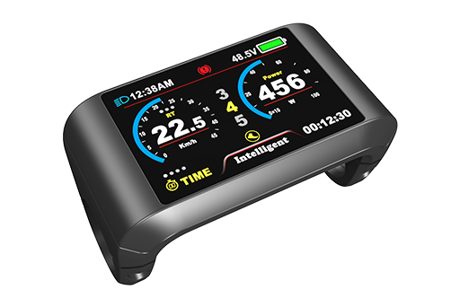

I have a Bafang 500C display on an MTB with a BBSHD motor. My downloaded manual for this display appears to show a bar graph on the left side of the display for reading watts under the actual number readout for watts...much like the right hand side of the display showing voltage or charge percentage also with a bar graph.
On mine there I've never seen a bar graph light up under the watts readout. The controller and motor work just fine, but no watts bar graph. Is this something that just shows up in the download manual for this display?...older instructions?...a problem or adjustment in the display? I don't see anything in the display menu showing this as adjustable feature.

Yeah, if there is supposed to be an operating bar graph under the actual watts number under load, then it is weird. I can tell I get what appears to be a good fluctuating watts readout numerically, just not the bar graph underneath. I poked around on the internet to try and see a video or picture of a 500C under load but never found one. The only place I've seen the bar graph is in the picture representations in the manual which aren't actual photos. The two or three actual photos of the unit in the manual are of the unit not under load, so of course there is only a "0w" and no activity in the bar graph. The display works fine otherwise.
The 500C should just show the watts in a graph in real time without any intervention. I have had two bikes with them, one a factory bike (Luna Fixed) equipped with it as standard equipment. If it doesn't something is wrong.

Poor video... But this looks to be the 500c display and show the graph
Thanks for that, rocket. Clearly there should be a bar graph. If he'd taken off the protective shipping film, it would have been clearer...LOL! Thanks much.
