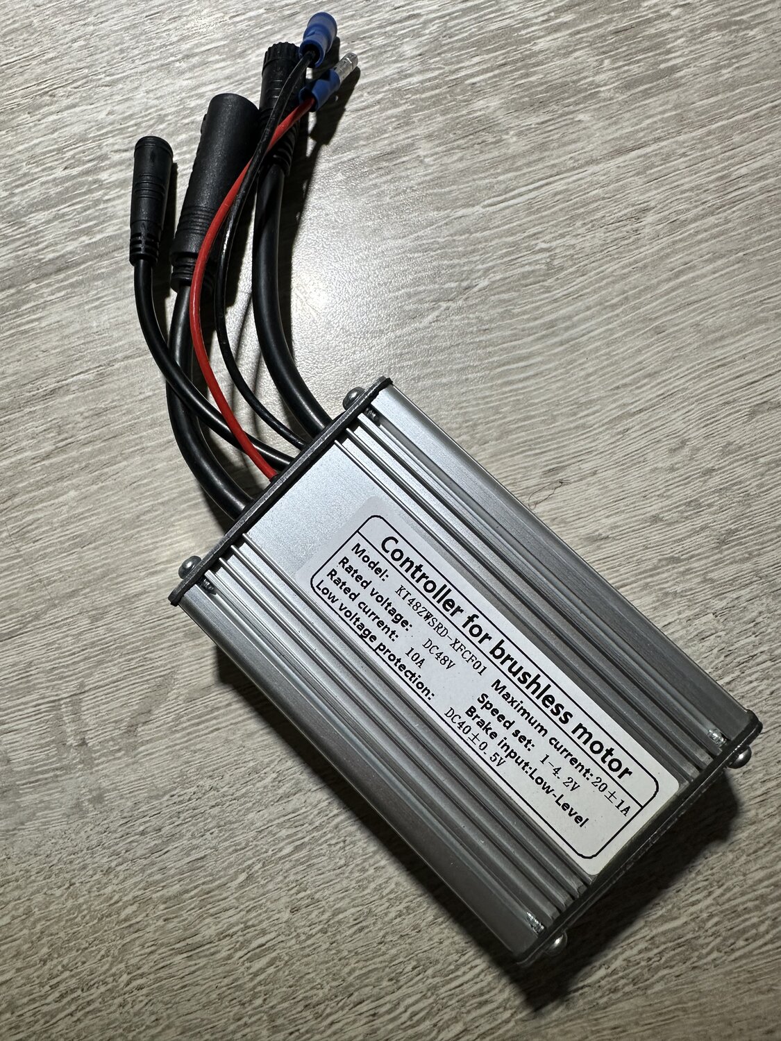

@Tom@WashDC @AHicks i contacted the KT controller guys who then pass my email to a third party who then contacted me about ordering a KT 6 mosfets 20A controller, after a few months it arrived today! Looking at this picture, do you reckon it’ll work? I paid 80 bucks in total, this included shipping.
Yes that looks like the same connections. It should work in combo with a KT controller
Installed the controller today, man it was a tight fit! Added some switched lights with horn too.

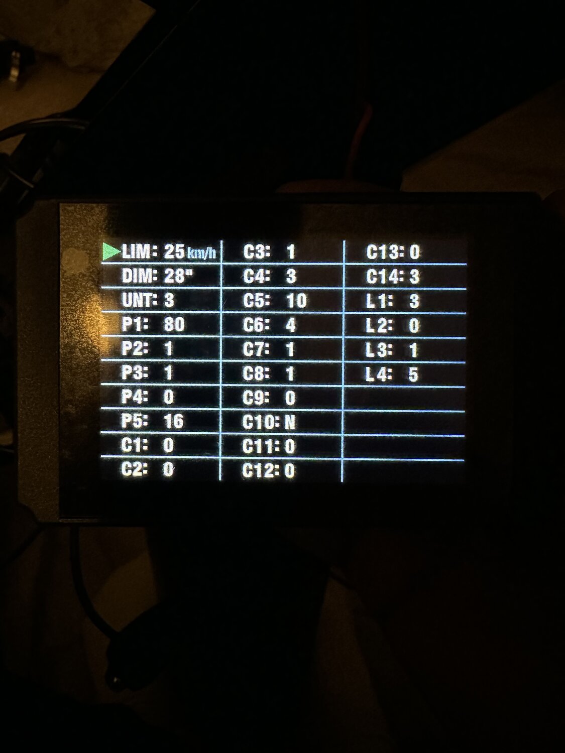

I haven’t tinkered with the settings at all but when I went in to the settings screen I saw this. Does the screen have memory? I think these are the settings I copied from you!
Will probably customise tomorrow.
