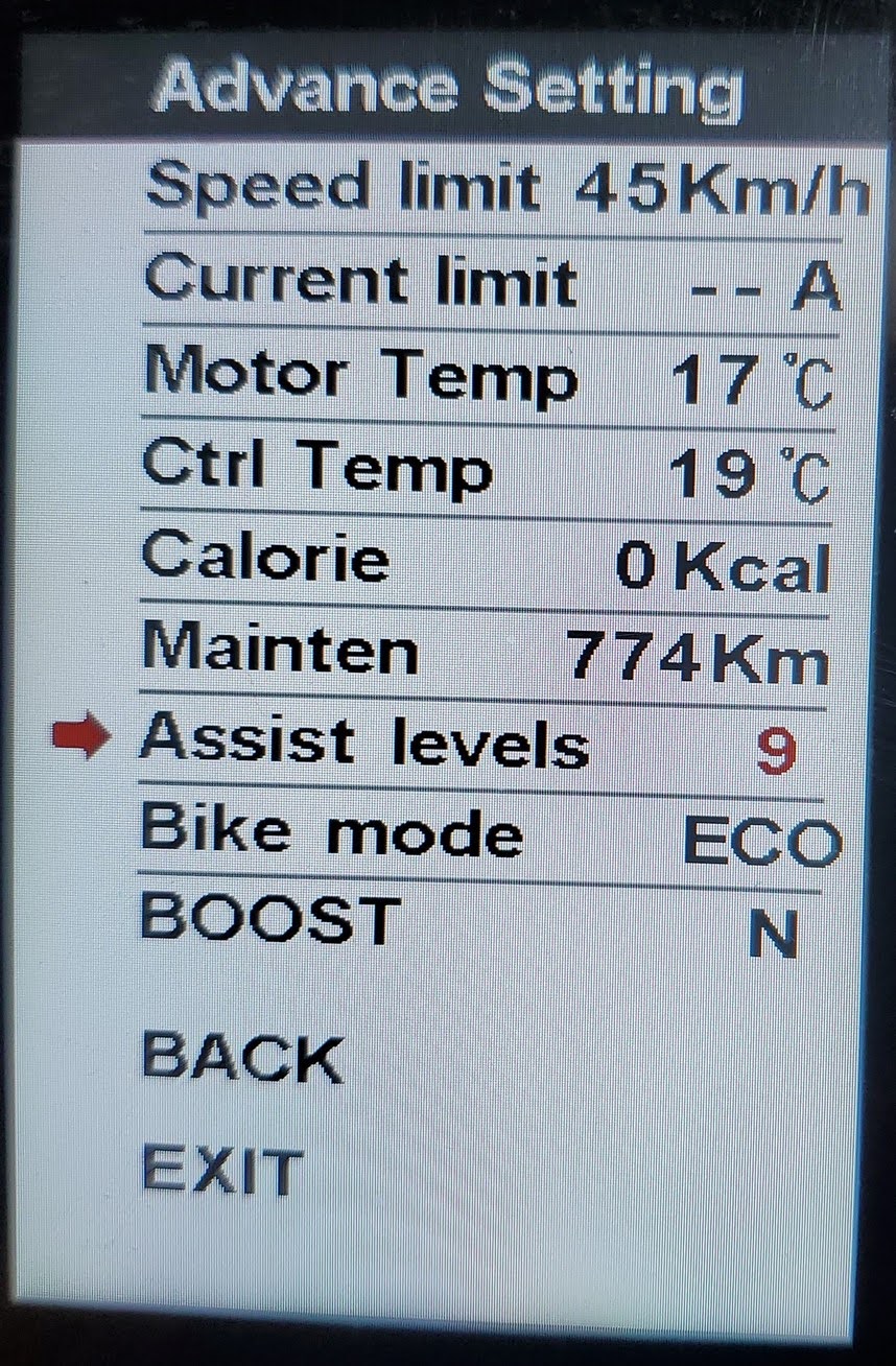

In the YT review video (17:39), the product manager ( John O'Donnell, Atlas Product Mgr./Designer) said the Atlas is more "locked down" as far as configuration via the display. And in the Evelo Atlas EVO-2 Display doc, I find the following:
The following settings are not accessible/changeable:
language - set to EN
temp - set to hide
start password - not accessible
wheel size - set to 27.5
battery - set to 48v
advanced settings - locked
What is the downside of these items (especially Advanced Settings!) NOT being configurable? Thanks.
The "EVO-2 Display" is a slick little pamphlet that comes with the Atlas. Unfortunately, it's incomplete in my opinion. "Advanced Settings" are not entirely locked as shown in my pic (use 1919 to access). The last 3 items on that list can be changed. Here's a few items that I've found are missing from the EVO-2 documentation:
  • Single press the mode button to cycle thru indicators
  • Press + and - together to reset trip indicators
  • Nothing that describes “ECO/SPORT” mode or “BOOST” mode (in Advanced Settings)
  • Walking mode is achieved by clicking ‘minus’ button down below zero PAS, then holding it down to engage motor at 3 MPH
I'm puzzled why the 28 MPH top speed is locked. On the Aurora, you can set it to a lower value. Locking the wheel size and battery voltage seems reasonable but why not allow top speed to be reduced?
The Aurora has a Dapu motor while the Atlas has a Bafang. This alone might explain that.
