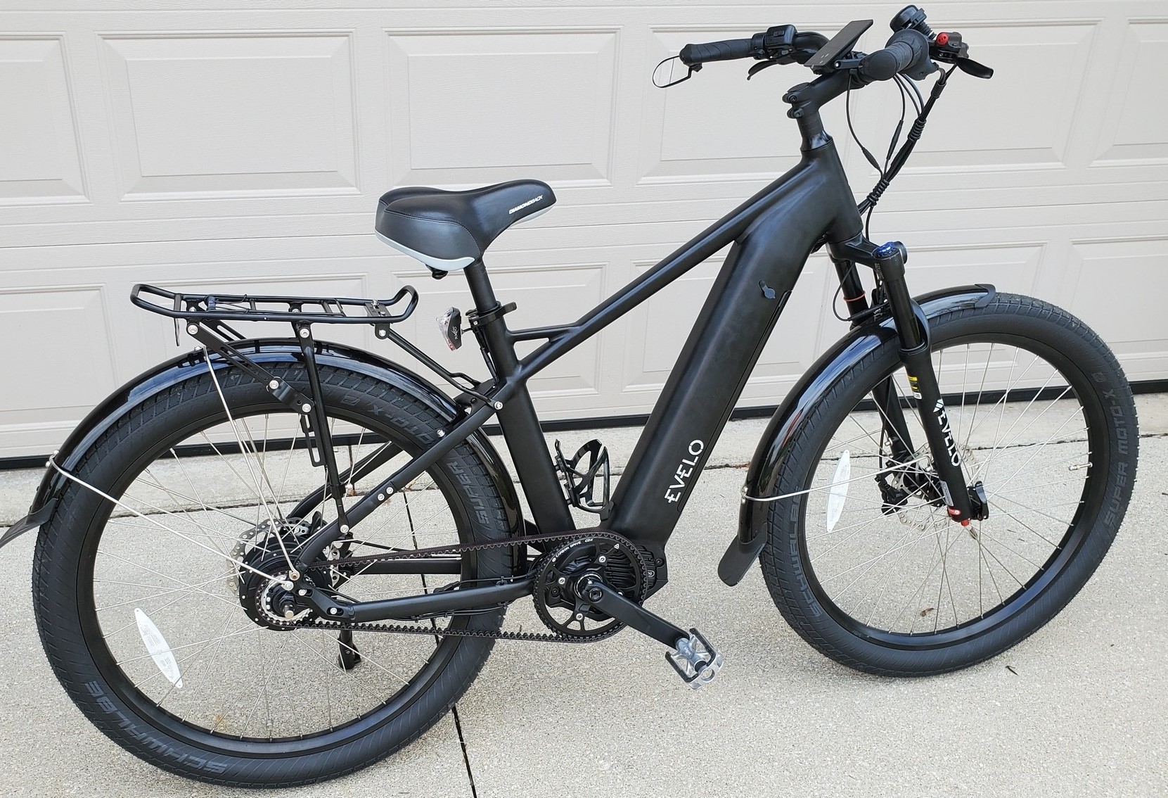

So far 45 miles on the Atlas.
The only range test I did so far is on 2 major 15% hills, many other 5%+ hills, mostly on PA5. I got home with about 15% battery remaining after 20 miles.
I find the bike pretty big, especially with a suspension seatpost - and I'm 5'10. I definitely need to lean the bike to one side, and time it right to get into position so as soon as I hit the peddle, the motor helps move me.
What I really like is how responsive the motor is from a standstill. As soon as it hit the peddle, off the motor goes and it makes the process very easy.
FIRST POST! [Owner of Aurora LE since Feb 2021 that was ordered Nov 2020].
Just received my new Atlas on Aug 9th and feel it's going to work well for me. Really like the Bafang drive and display/controller since it has more features and settings than the current Dapu display (had the Bafang setup on a Biktrix model and really missed the PAS selection of 3,5, or 9 levels). Added the 'optional' throttle but locating and accessing the harness connector was a serious challenge! Power and delivery is quite similar to the Aurora but the bigger wheels and higher top speed are killer! The manually controlled Enviolo hub dictates that the rider has more involvement in the cycling process, but it’s second nature to anyone with derailleur experience. I was surprised that the hub does not like to change ratios while pedaling under load but easily shifts with a slight ‘let up’ of pedal pressure. The Atlas feels lighter than the Aurora LE but my bathroom scales indicate a similar weight at 64 lbs. Battery weight is 8.4 lbs (vs 7.6 for the Aurora) and looks to provide an impressive range. I put 40 miles on the first full charge and the battery was still showing over 40% (on flat paved Rails to Trails). Motor noise could be described as a light whine (think of a tiny turbine engine). Not annoying but certainly obvious to those riding close by. The supplied seat is not comfy, same as the Aurora, so I changed it out immediately. A rear cargo rack is not included (bummer) so I’m currently installing a ‘universal fit’ model that is $120 cheaper than the custom Evelo unit. (although I’ll need a 12 dollar, 2 pin Julet ‘extension’ cord for the rear tail light). Not crazy about losing my name brand Tektro hydraulic brakes but I guess the supply chain problem necessitated a switch to the ‘no name’ Zoom brakes with pressed steel levers (another bummer).

I'm at 45 miles on my 10 day old Atlas as well. Results so far are good, but I would prefer to go a bit longer prior to saying a lot about it.
Regarding the M600 motor noise, that's pretty subjective, but I'll go out on a limb and say there's nothing objectionable about it. Yes, there's a "whir" to it, but nothing that should be considered a deal breaker. They've done something different as compared to the earlier M600's that ran with a pretty significant noise level, but I have no idea what.
I did note it does not have the brute power to accelerate hard in the higher ranges of the CVT like the M610/Ultra does. If you're faced with crossing a busy road for instance, you need to be conscious of what to expect according to what part of the CVT range is currently selected. Also, regarding the CVT, it takes a pretty healthy grip to twist that shifter (something I notice anyway). In that regard, one of the reasons my bike doesn't have more miles on it is because I thought the force to turn the shifter might be excessive. I did some close checking, which led to re-routing the shift cables - and that did involve pulling the motor. That led to the existing length of the cables being long, so those needed to be cut and redone. THAT operation not for the faint of heart, but I do feel there was a slight reduction in the required effort to shift. Enough to go through what I did? Maybe not....
