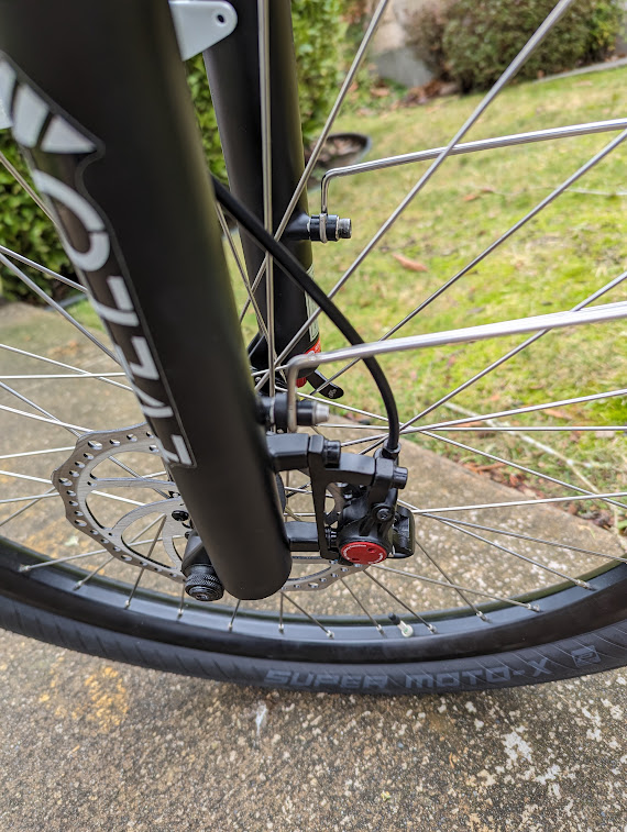

NO! The knurled end must remain on the outside! The longer smooth end recesses into the left fork leg.
You're right. That's the way I had it and when I looked at the printed instructions again it seemed to show knurled end inside.
The assembly video shows the knurled section on the outside.

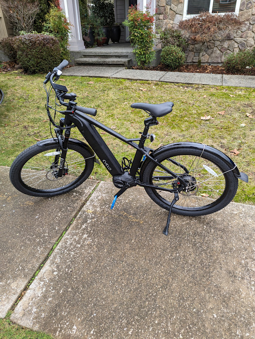

Sounds like we got our bikes right around the same time. I'll be at 30 days on 2/2. In case I don't get an email for sure share anything they tell you about the fender. Life stuff going on so I wasn't able to complete the assembly until this past weekend and first ride on Sunday. Overall first impression has been good.

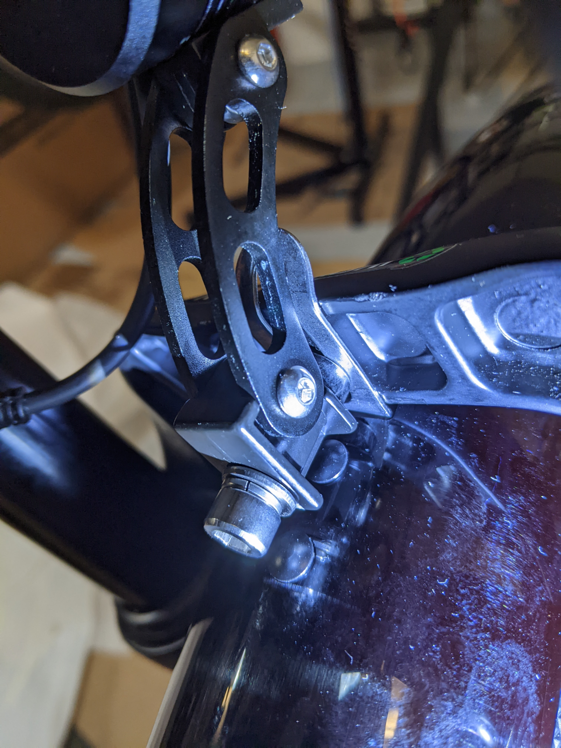

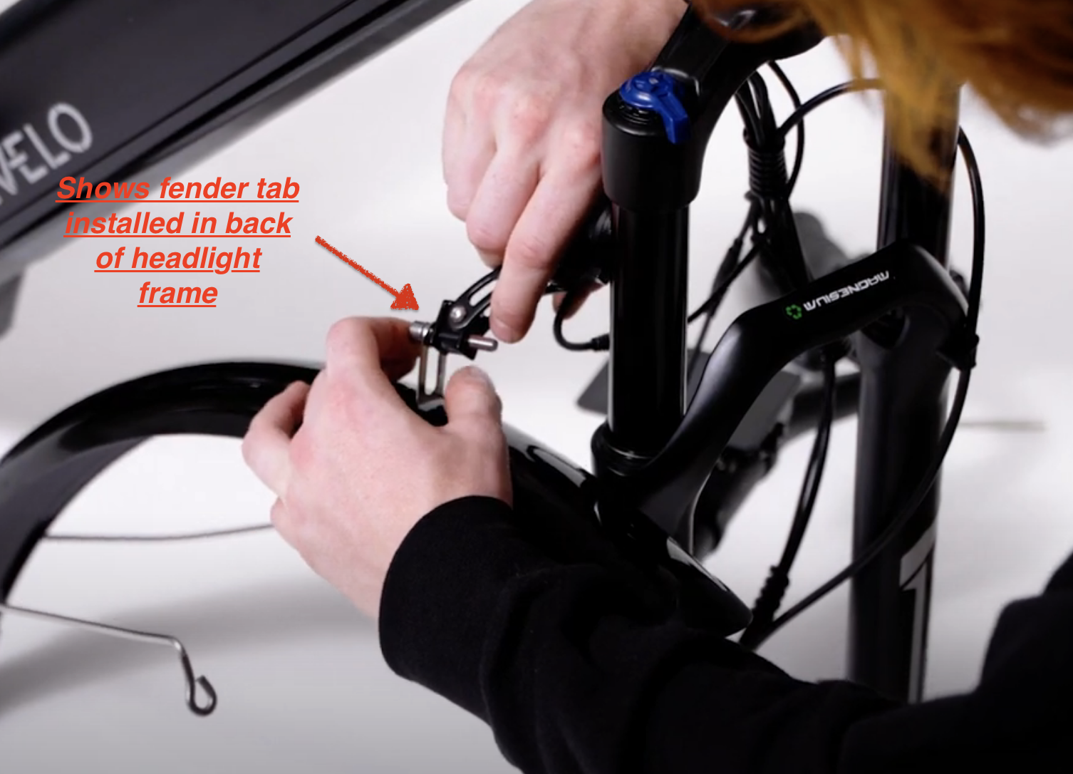

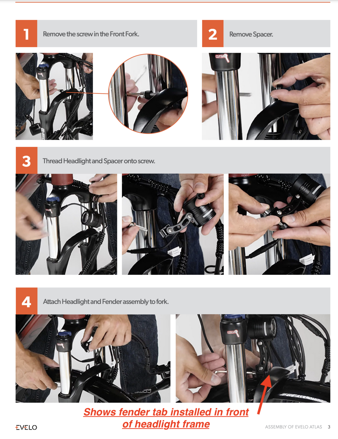

Thanks for the report and the video. After watching the video, I start to understand some of the front fender/tire clearance problems and confusion. If this video is current/correct, at ~2:02, it shows the fender tab being installed at the rear of the light assembly (first image), with the spacer at the front. This would tend to push the fender back, providing more fender/tire clearance. Not sure if the strut spacers would still be required. In contradiction, the official Atlas assembly PDF shows the fender tab installed at the front of the light assembly with the spacer behind the fender tab (image 2). This results in moving the front fender forward with less fender/tire clearance and the fender tab being bent when adjusting the light (image 3).
Of course, last year I followed the PDF guide with the front fender rubbing the tire, which started me on this frustrating journey with spacers, longer bolts, blood, sweat and tears. :mad:
Hopefully, Evelo will determine the best installation configuration (that maximizes tire/fender clearance) and ensures the assembly guide and video match. ;)
