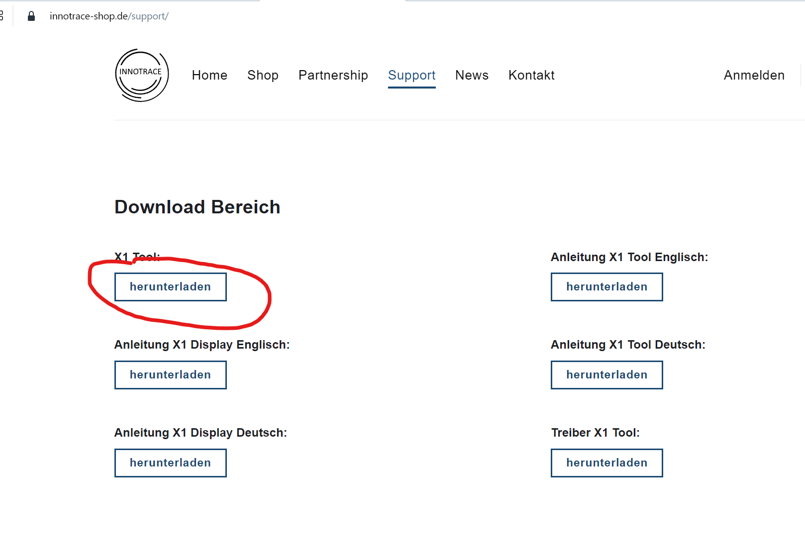

Yes. The program, the drivers and the instructions are on the Innotrace web site.

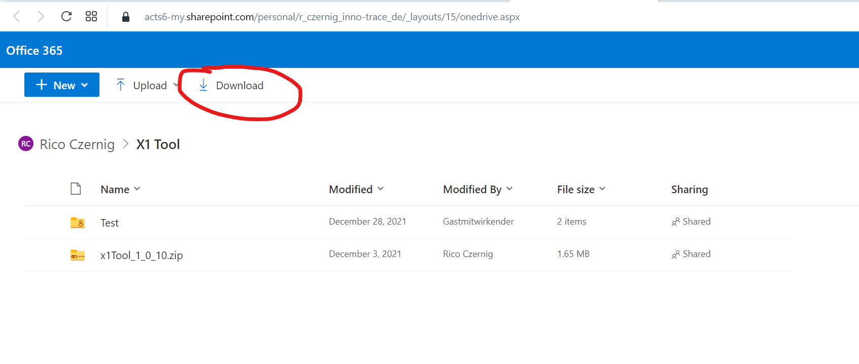

Hmm didn't know you could , doesn't allow me to download it though says there was an issue looking up your account . Tap next to try again EDIT: got the program downloaded waiting for registration confirmation, now I am also curious if anyone with the cord can snap some pics of it as I'd love to tune this bike and not wait for a backorder aswell
You might need an Office 365 account. You can create an Office 365 account here https://www.office.com
But I was able to download the files even from my phone without Office 365 account. Try to download from different device, maybe from your phone.
Here is an example of the downloading process how it looks on my machine (on the phone it looks a little different):
Click here
Then click here
