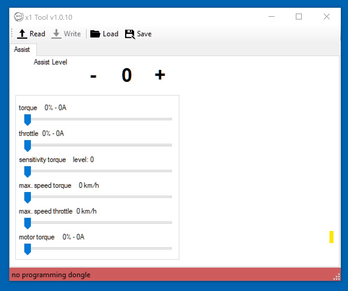

I have Innotrace controller X1 with programming cable only one month. Bafang ultra / max 28A according the controller / 52V battery 14S6P= 30Ah-Samsung 50E. My controller was bought with all parameters to 100% (or 10), only sensitivity varied according to the level of assistance, which is a typical setting for about 90% of users (according to Pushkar). But it doesn't suit me - all levels are set to maximum, they differ only in sensitivity. In this setting, even the lowest level of assistance provides too much power (at least 300W-according to the display 850C). I am used to a wider range from about 150W to 1500W in 9 levels at the factory controller for about 2 years. I enclose a table of the current settings with this wider range, as the best setting for me now. Torque and Sensitivity is now OK, maybe Motor torque could be higher.
In my opinion, the percentage increase in power according to the own pressure on the pedal can not be set by only a single parameter, but by a combination of Torque and Sensitivity. I like seeing experience of others with their settings.
Level of assistance
Torque %
Throttle %
Sensitivity Torque
level
Speed Torque
km/h
Speed Throttle
km/h
Motor torque
level
0
0
0
0
0
0
0
1
10
50
1
100
100
5
2
15
50
1
100
100
5
3
20
50
2
100
100
5
4
30
50
2
100
100
5
5
40
72
3
100
100
5
6
50
100
3
100
100
5
7
60
100
4
100
100
5
8
80
100
4
100
100
5
9
100
100
5
100
100
5
10​
0​
0​
0​
0
0
0​

In the video, @pushkar says at the 5:25 mark that if the programming cable indicator doesn't turn green to ensure that the programming cable is solidly connected and to make sure the battery is on. When I unplug my display to connect my programming cable the display dies. How does one ensure the battery stays on when the display is disconnected? I don't even get the yellow bar, mine simply stays red. I have started and stopped the app as indicated in the video and have also double checked my connections multiple times. This is all I get - the red bar at the bottom which indicates no programming dongle.
Anyone know what I'm doing wrong?
Hello, I'm having the same issue here and have had no luck fixing the issue. Although I am getting driver unavailable for my x1 tool...
Perhaps someone could recommend the steps to fixing I would appreciate the help.
If you plug in your cable and hook it to your bike so that it knows it's connected to something, open device manager on your computer and find it and update your driver. I believe I also saw the updated driver available for download on the Innotrace website at one time, but it's all in German and you have to translate the page.
Thanks
Good to go.... finally... thanks again for the info
Sorry, I'm experiencing the same issue (no dongle connected error) and I'm not sure how to update the driver. Pushkar has mentioned this on past threads and I see it here as well but no dice. I've re-run the install and nothing. I've found the device in device manager and updating the driver does nothing...a driver can't be found. Is there a driver file somewhere that perhaps I didn't get in my download link? Thanks for the help.
Never mind...I found the site and the files - https://innotrace-shop.de/support/
