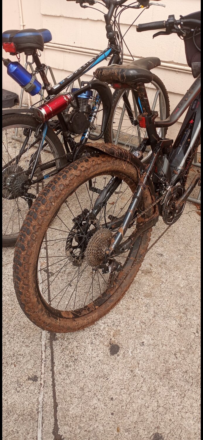

I bought cheap $80 electric pressure washer for knock out mud on my bike. It shoots bubbles and warm water.No touch bike wash.

I don't like putting any water on my e-bike, and it's never seen rain.
I know that your e-bikes are "waterproof", but if you were to run your e-bike and get it hot, then ride through water that's up to your axles and motor, the metal quickly cools and creates a vacuum inside that can easily suck water past the seals.
The same thing can happen when you pressure wash your e-bike.
I hope you keep your pressurized water away from seals and bearings?
It is okay. My bike is engineered water tight. I pressure washed and compress air dry it.

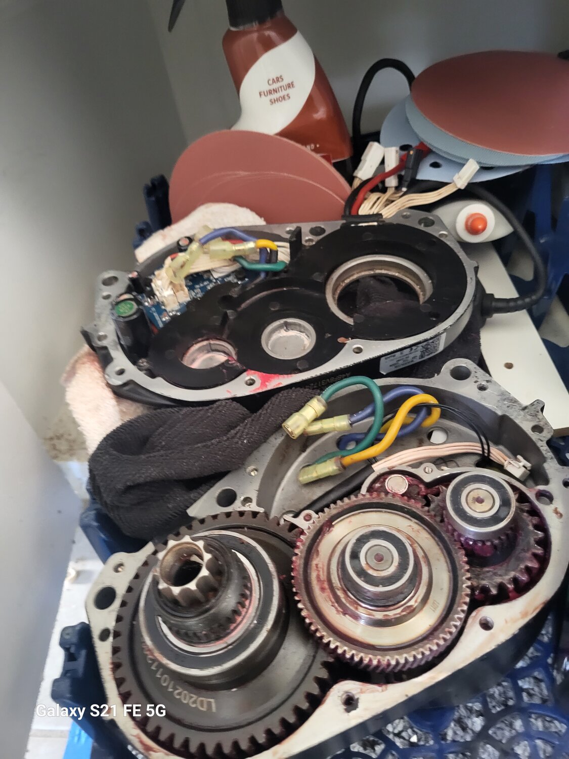

Picture of my spare motor the case or block has thick walls
G Shock. Drop it like it's hot and it will be fit for use.
It's not the G Shock from an impact that I'm talking about, it's the Temperature shock.
If that motor gets hot, the air inside expands under pressure and it leaks out through the grease and seals.
When the motor hits water, the temperature can drop very suddenly and create a vacuum inside the motor.
That vacuum can suck water into the motor. (It's happened to @m@Robertson )
Next time you take a used motor apart, check the seals, bearings and greases for any contamination or corrorosion.
See if anything got in past the seals.
PS,..
Your motor looks a little under-lubed to me?
I remember when you completely filled your motor with grease and @tomjasz laughed.
I said that you clogged it and the gears couldn't spin up.
I think that you need something in between the two extremes?
Maybe @tomjasz can comment on that?
I think that you need a bit more grease?

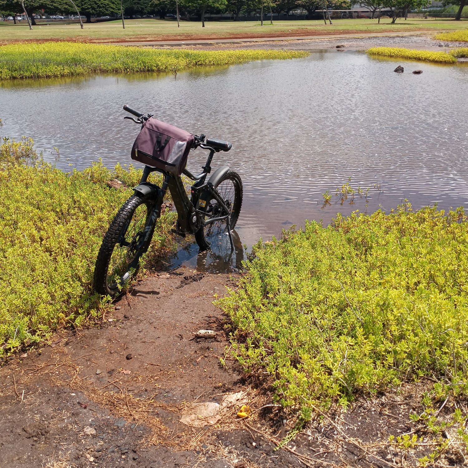

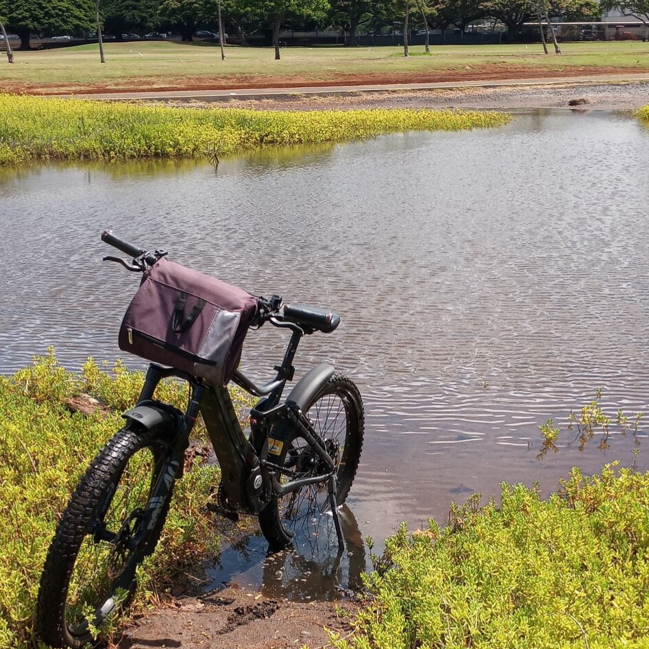

I'll bet you ten dollars that if you take your ebike for a long hard ride and get it nice and warmed up, then ride it into that puddle and submerge your motor, you will suck water into your motor.
If it gets wet inside, you will get $10 from me and a new motor from Biktrix!!
The engineers guarantee its waterproof !!
