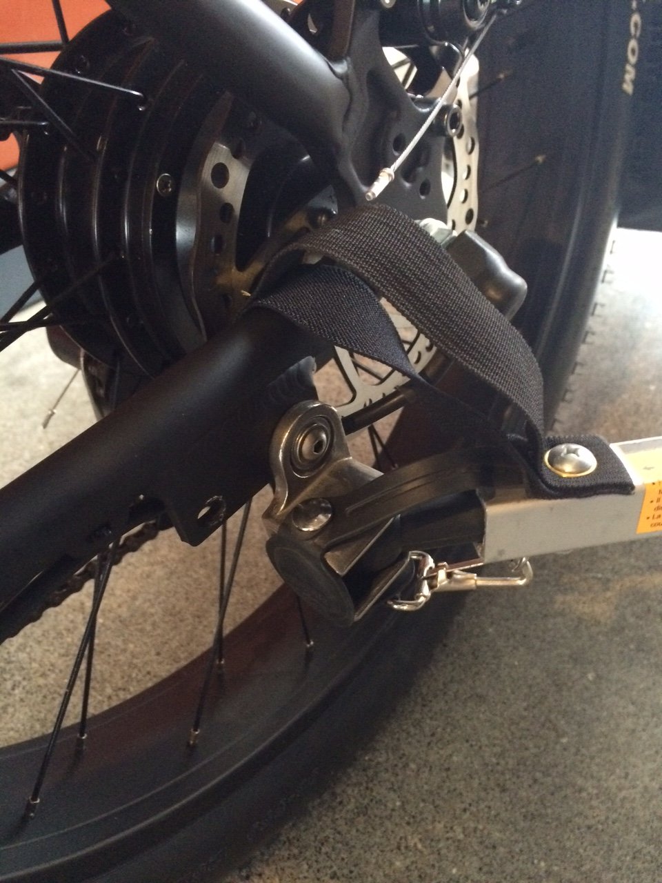

The trailer is a Champion Cougar (now produced by Thule) that I'll use to take my daughter to and from school, either behind the RR or using it as a jogging stroller (in addition to being a bike trailer it can convert to a walking stroller, jogging stroller, skiing stroller, ext). The stock trailer connection is supposed to be bolted to the rear axle on the left side, but the motor wire would not allow this without modifying the bracket. So I remove the kickstand and used its beefy flange to bolt on the trailer bracket. Works great. With a little more time I'll likely come up with another option that allows me to keep the kickstand as well.

RSwannabe: Would you mind a pic of the hitch mount? I have a doggy ride and was wondering about how to mount the hitch, if not on the axle. Doggy ride also has a hitch adaptor that may help, but without looking its hard to tell if the hitch adaptor will work.

Lynnandj - here is a pic of how I have the trailer connect for now. This is not the permanent solution, but it works well for now.

Actually I think the simple answer is to cut a slot into the trailer bracket, turning the "O" into a "C". The slot is just wide enough to let the wire for the motor slide through, and then mount it to the axle as intended.
I guess what I'm also saying ... is I don't like the location of the kickstand.. looks like an afterthought... imho...
Rear mounted kickstands like the Greenfield Stabilizer are becoming more and more popular in the MTB crowd and work well. The one that comes on the RR seemed to work well in the limited time I used it before I removed it to mount the trailer.
Thanks RS. Looks like I will try the kickstand mount. Looking, I am surprised that's not a plug at the axle for the motor cable. New to ebikes; how do you remove the rear tire? I guess I'll await the operators manual.
