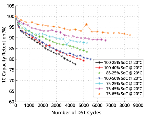

Plenty of research.
Nissan Leaf battery, DST - dynamic stress test reflecting capacity loss.
In theory - yes, you could double the life of your Bosch by running 85-25% instead of 100-25%.
But there are many variables, I wrote about this in another post couple days ago.
There is balancing - unlikely you will get it right when charging to 85% only. Unbalanced pack will show signs of decay sooner. For this reason, I would charge it to at least 90%.
Also, it's aging with time even when you're not using it, this process begins on the day one and never stops. So you might get 8 years at 85-25 cycle VS 4 years at 100-25 (assuming same annual mileage), but only 10 years vs 6, i.e. less than a double.
Note that 85-25 means you're using mere 60% of nominal capacity, while at 100-25 it's 75%, so your range will be a bit shorter.

Battery University has a number of good articles on lithium battery life vs charge levels. Here's a couple to start with;
Basically, limiting the charge and discharge voltages to a narrower range will increase battery life but of course limit battery capacity. This can be dramatic with very limited SoC range, but from a practical standpoint limiting your battery to a range of 80% max - 20% min will achieve a good balance between maximizing both battery life and capacity. How much longer might the battery last? Battery University offers this somewhat complicated answer;
85–25% SoC has 2,000 cycles to 90% capacity. Uses 60% of battery capacity. This is double the life of a battery cycled 100-25% SoC.
I personally choose not to worry about this. My battery pack has a 300 cycle warranty to a minimum 75% capacity meaning that after about 8 years of my typical use the battery will still be able to deliver 75% of its original 600wh capacity. I could extend this with special charging limits, but 8 years is good enough for me, esp considering that I'm in my 70's...😎
BTW - battery storage conditions also have a sizable impact on battery life. Temperature and SoC are reported to be the most important variables. Keeping the battery at room temps and at about 50% SoC in storage is recommended.
Yes. Battery U is a good source. I tried to link this graph earlier, it showed in Preview but disappeared later.
Cycling close to the middle is the key - but e-bike pack is different from Nissan Leaf, there is a balancing issue, so it's better to charge it higher than 85%.
Not discharging all the way to the bottom still helps, and so does prolonged storage with 40-60% charge VS 90-100% (say, one week or longer) .
80% is not a mantra, it's the truth, but for an e-bike pack this isn't a good idea because of the balancing.
Note that these graphs are at 20C (68F), this is what battery wants. Higher temps of operation and storage will shorten the life.

Here is a simple graph to help answer your question... you will triple the number of useful cycles (500 vs 1.500)
