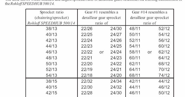

Here's what I question. I have read that the gear reduction inside the M620 motor itself is something from 18:1 to 28:1. The design uses 3 levels of gear reduction ... it makes no sense to do that and then give 50% of the torque gained via gear reduction with the belt / chain ratio unless there was too much reduction to allow the top speed / cadence desired when using an IGH. I don't think the Kv of the Bafang motor is such that it would need this. You get some of that back via the underdrive gears on the IGHs but even then I just don't it makes sense unless not wanting the full torque from rider and motor to impact the IGH.
that’s an interesting tidbit, i don’t think i’ve seen the reduction ratio for mid drive motors published before. let me see if i understand this:
motor at 1,600 rpm, internally geared 20:1 ->
crank at 80 rpm, geared 1:2 via cog sizes ->
rear axle at 160 rpm, geared 2:1 to 1:2 via IGH ->
wheel at 80 to 320 rpm.
tire circumference is approx 7.1 feet, so that’s 568 to 2,272 feet per minute, or 6.5 to 26 mph, a normal and workable speed range for pedaling at 80rpm.
what would the advantage be to changing it up as you propose:
motor at 800 rpm, internally geared 10:1 ->
crank at 80 rpm, geared 1:1 via cog sizes ->
rear axle at 80 rpm, geared 1:1 to 1:4 via IGH ->
wouldn’t the motor be bigger and heavier to generate the same power at half the speed, and wouldn’t the IFH experience greater internal stresses and losses to go all the way to 1:4?
i’m probably missing something here but it seems like the way it’s done works very well for a system which has to take into account human pedaling speeds, standard tire sizes, small and lightweight motors, and speeds in the 5-30mph range.
