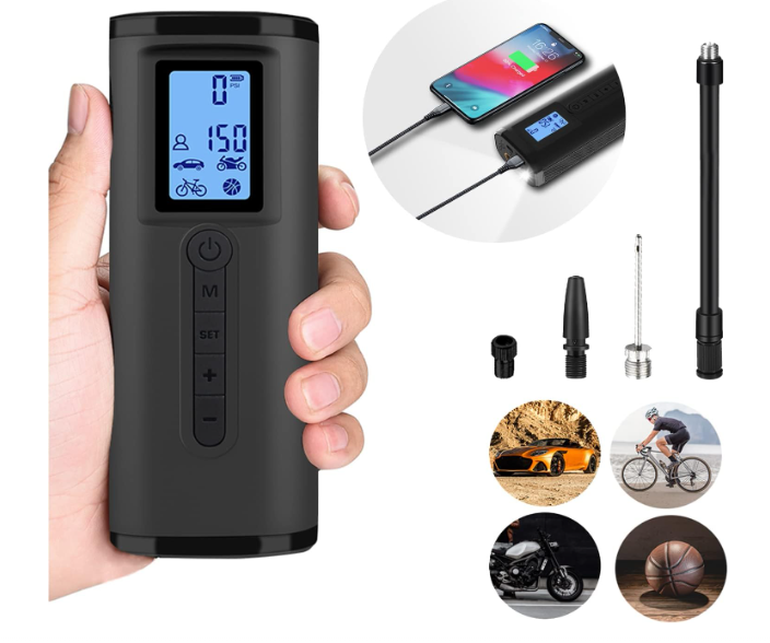

Any comments on these battery-powered tire pumps?

I've been using the Lamgool 150 PSI Tire Inflator Portable Air Compressor Bicycle Pump for the last 6 months and it's performed well. Right now (11/13/2023) it's $35.69 from AMAZON.
2023-11-13 14_36_27-Amazon.com_ Lamgool 150 PSI Tire Inflator Portable Air Compressor Bicycle ...png

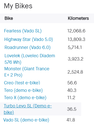

You cannot prove you are riding. Your word against my word.
I am transparent, and you can easily check my yearly riding performance.
You only talk. The talking costs you nothing.
You are as rude as many stereotypical American bullies can be. Learn some politeness. I have never called you a liar. I have just pointed out you cannot prove you move yourself for a ride at times. On contrary, you seem to have an enormous workshop experience.
I have the CYCPLUS one https://www.amazon.com/gp/product/B0BVW1CTZJ and it works. It's also tiny. Maybe the same volume as one CO2 + inflator, but shorter. I'm not carrying it because I'm lazy, it's just the smallest thing available that can reliably inflate my tires. Being faster and easier than a mini pump is just a bonus.
I also carry a short (8" or 12", I forget) USB C-C cable in case I need to power my phone from my bike. In theory it could charge the pump from the bike, too.
The argument I'd make is that the very small pumps (like the Fumpa Nano/Mini and the Cycplus) are of comparable weight and size to a CO2 inflator and cartridge(s) -- and comparable inflation ability.
Vastly more inflation ability compared to a single CO2.

I have been looking up specs for various pumps. Some report the battery capacity as "5,000 mAh". Others report it as "2,500*3 mAh". Should it make any difference to me whether a pump has one 7.500 mAh battery or 3 2,500 mAh batteries?
Thanks
Only need enough charge to fully inflate a couple of bike tires. Given it can be charged by any USB source recharging shouldn't be problem between uses.

I think the 38,226 km (23,757 mi) ridden on several e-bikes over 4 years and 2 months give me enough competence to give advices for practical aspects of e-bike riding and e-bike selection. I can also say about typical issues met during riding particular e-bikes and the way to interpret and handle them.
I am sorry for people who tried to save their dollar and bought ridiculously cheap e-bikes then need to "work on them". I believe I need to let people earn their dollar for the work they do at LBS, or I manage the maintenance and repairs within my family.
