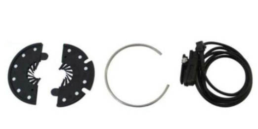

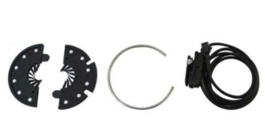

FYI, there are PAS adapters available where no crank disassembly is required. Worst case is, you have to remove the crank on one side, usualy the side opposite the chain. In the grand scheme of things, that should be a pretty simple operation.
My advice, for what it would cost to install it (<20 bucks?), you could try it out and see if you like it first hand - without listening to possibly biased advice. You are doing yourself a disservice otherwise.
You can buy this for about 12 bucks, but you still have to fashion a bracket to hold the sensor on the right. I would agree that the PAS sensor is one of the more annoying parts of a DIY install. I'd rather pay the 12 bucks for a crank puller tool.
If you're doing a ebike build, you should own a crank puller, a spoke wrench, a multimeter, probably a soldering iron. Trying to avoid a PAS install because of complexity is just silly, as pedal assist is one of the nicest things about an ebike.
