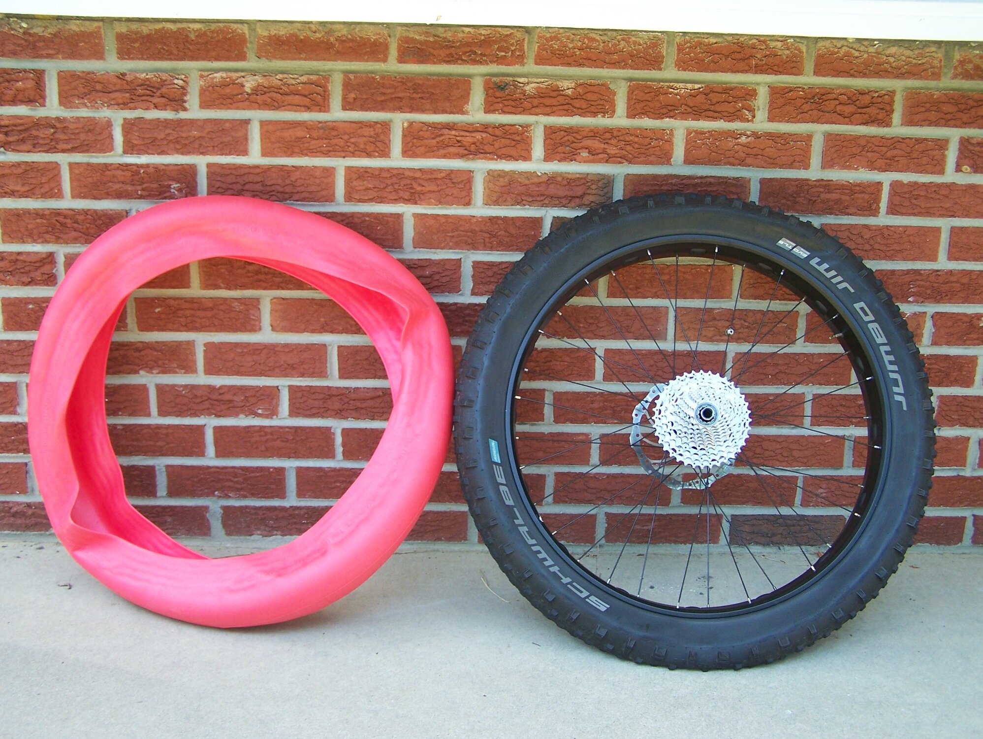

Tannus Armour installation, 7/2020. That pink foam liner has to go into that Schwalbe Jumbo Jim 26x4.0. Tannus provides a smaller sized tube that goes into this liner. I tried fitting my 26x4.0-4.8 tube into the liner and tire, but it would not fit.

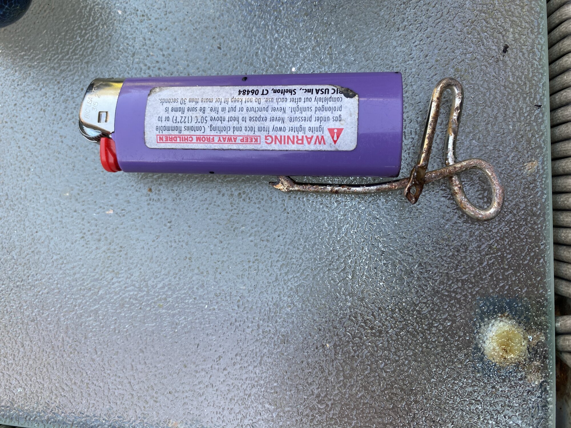

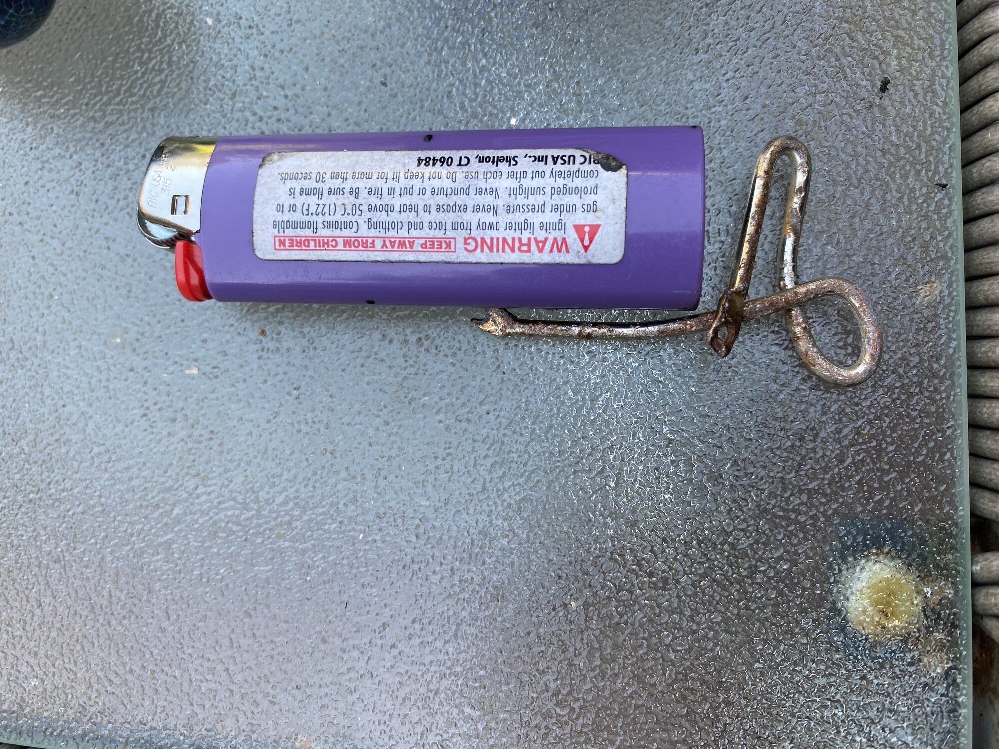

My armor got pierced!
The straight part, along the lighter, went right into my tire. I heard it immediately. I was about a half mile from home, so I walked back and drove to work. The time it took me to walk back would be the same amount of time it takes me to change the tube. This is why I don’t carry any other flat protection. The walk back was nice. My buddy stopped to offer a hand. He was on his road bike. Had a good chat, then we parted ways. I think, on the walk back home, the stabby clip pierced my tube a couple of more times. When I got the tube out later that night, there were 3 holes in that area. I checked the armor and tire for other stabby objects. All clear. I bought a replacement tube and am back on the road.
