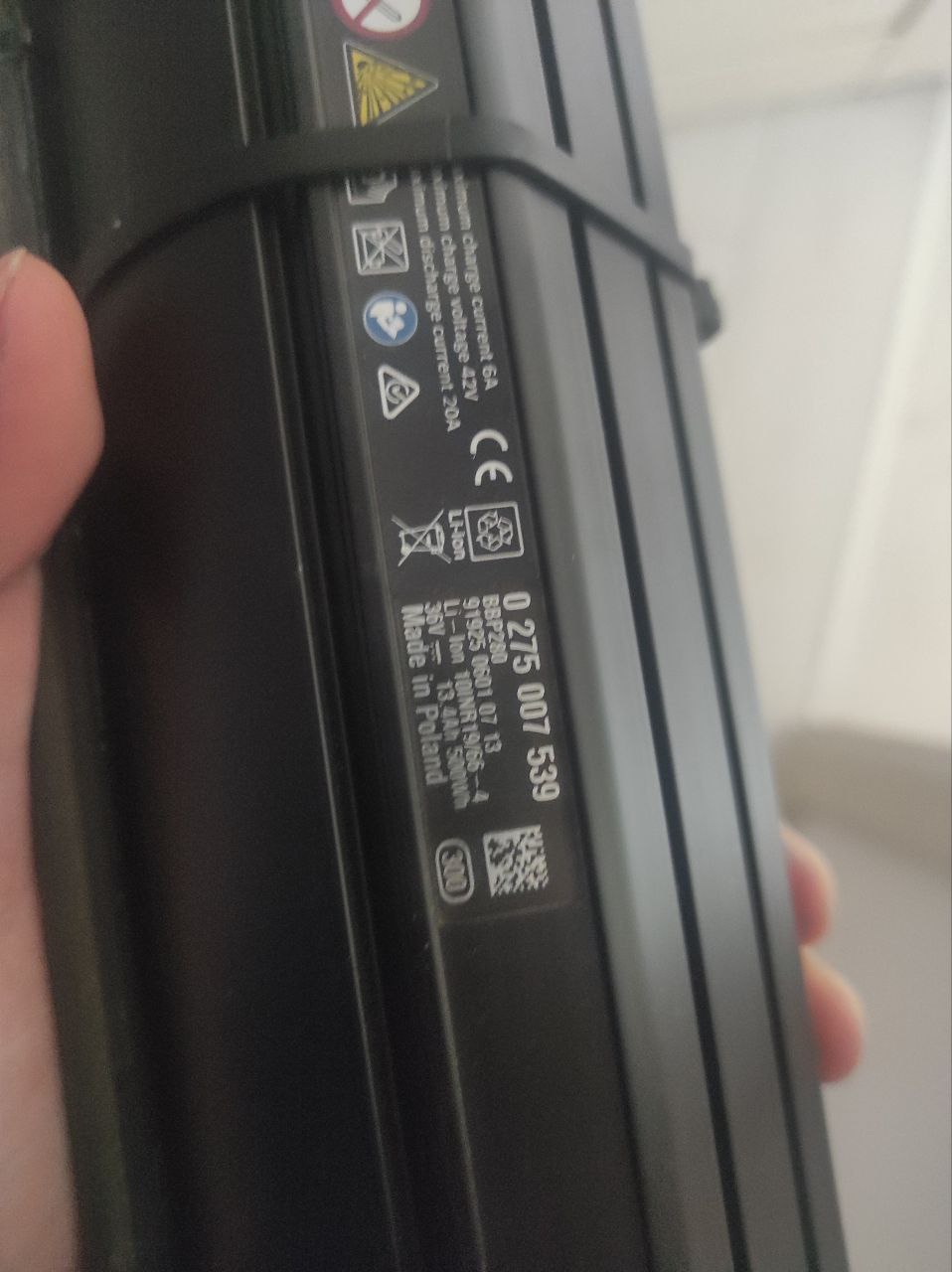

Hi! is this bag suitable for integrated battery ? LIke this ? Is it possible to put in this bag 2 batteries ?
Sorry, no idea. I would check with your e-bike dealer.

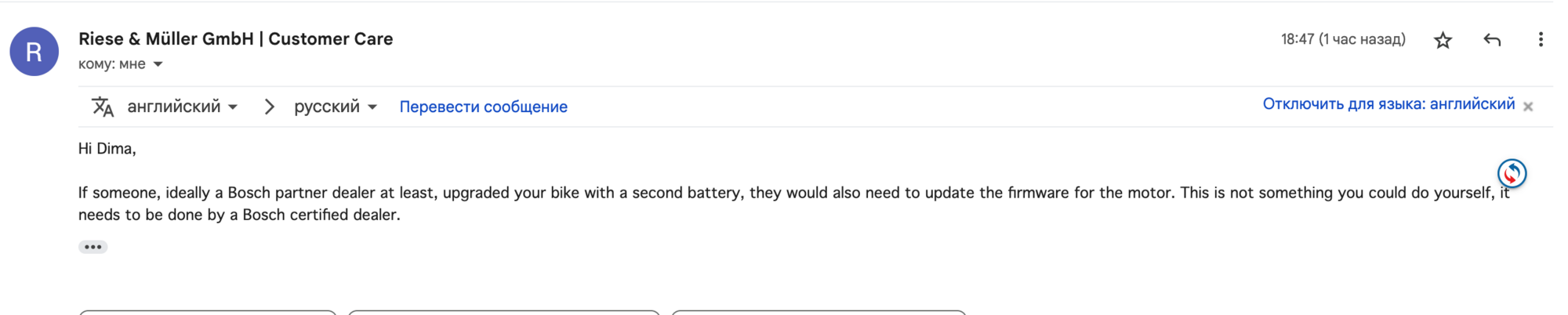

could you please answer to me , after installation of additional battery , did you do upgrade of firmware ? take a look please .
