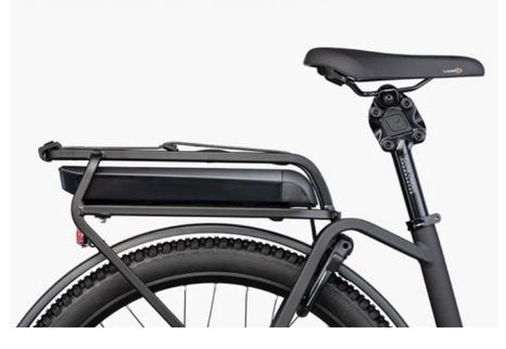

Hi! is this bag suitable for integrated battery ? LIke this ? Is it possible to put in this bag 2 batteries ?
That wasn’t clear in his reply.
