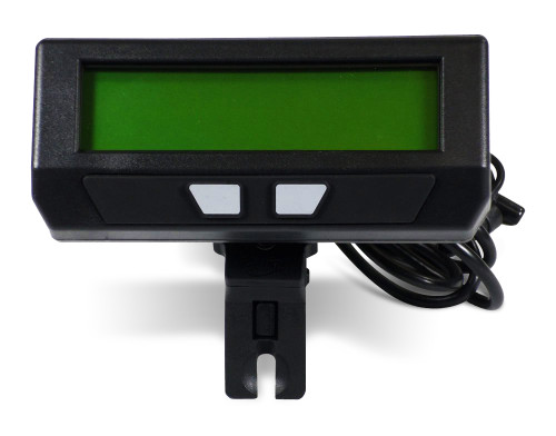

The fact that it lets me make tuning changes from iOS is worth it to me. do I need the display? no, the included one is fine. As is the five assist modes. But, from what I can see, that device lets me program the motor. And I could *STILL* take it off and put dpc 18 back on when done if it's otherwise not worth it. It certainly feeds more data to the phone if I want it. I really don't mind taking one giant screen off the bike either. I have 3 on it.
I think eggrider is my answer. As soon as it's actually available again for bafang. Making this bike feel closer to the vado is really gonna seal the deal for me.
I will likely also reduce power a bit if for no other reason than battery life. I really shouldn't ever need the power this bike offers. Even with limits in place it's going to blow past the vado.
Go for it. Just one tip, if the motor starts acting weird, unplug the EggRider, plug the DPC18 back in, and see if your "problem" still exists...
It's doing weird things now. so, not sure that is confidence inspiring. ;P
Despite all the eggrider haters, I think it might be the one for you if you want to change the bafang parameters from IOS.

I used eggriders on 2 BBSHD bikes for over 6 months. I am now using a 760C (from luna which works with 52V battery) on one mainly because its winter and the larger 760C buttons are easier to use with winter gloves. The other bike is now sporting a grin setup (GMAC, phaserunner, CA3)
I figure once I figure out my tuning, worse case I can move on.
The cons you outlined could very well be problematic. But the dpc18 is still there. And that seems fine.
Not needing to figure out a programming cable for mac or load windows in a vm or boot camp is worth it.
