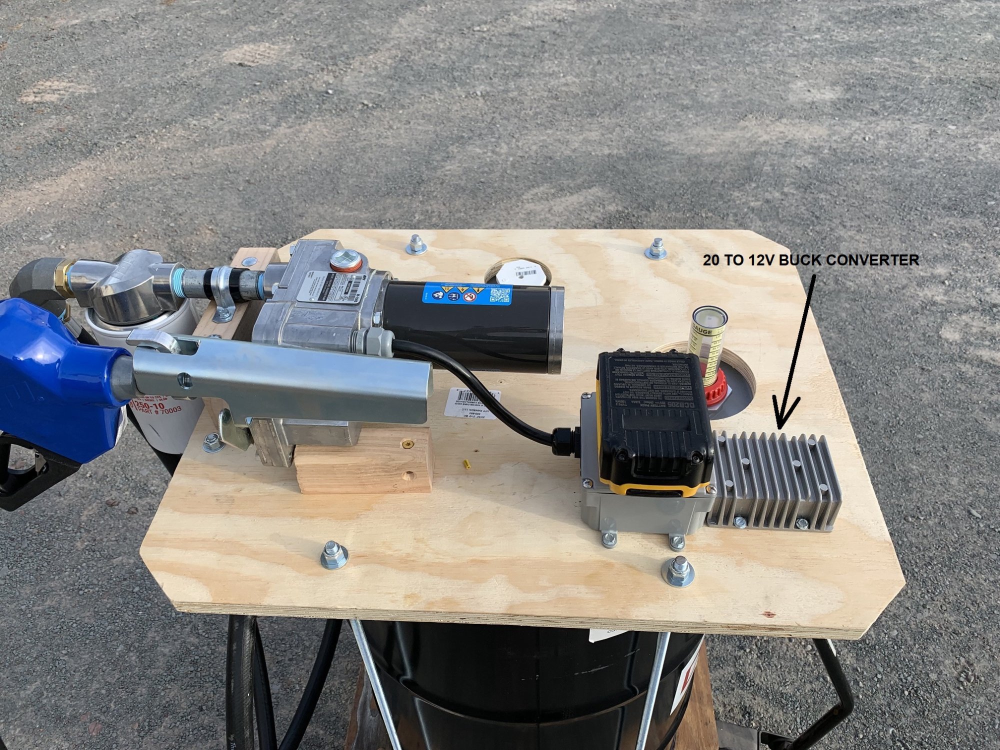

@6zfshdb suggests using 48V or 52V batteries to power 36V motors, so the buck converter would always be needed to reduce the voltage for the motor.
Buck converters are generally about 85% efficient and are less efficient when the input and output voltage difference is greater.
A high quality buck converter can be more efficient, but they all come with a large heat sink or even a fan to deal with the energy wasted as heat.

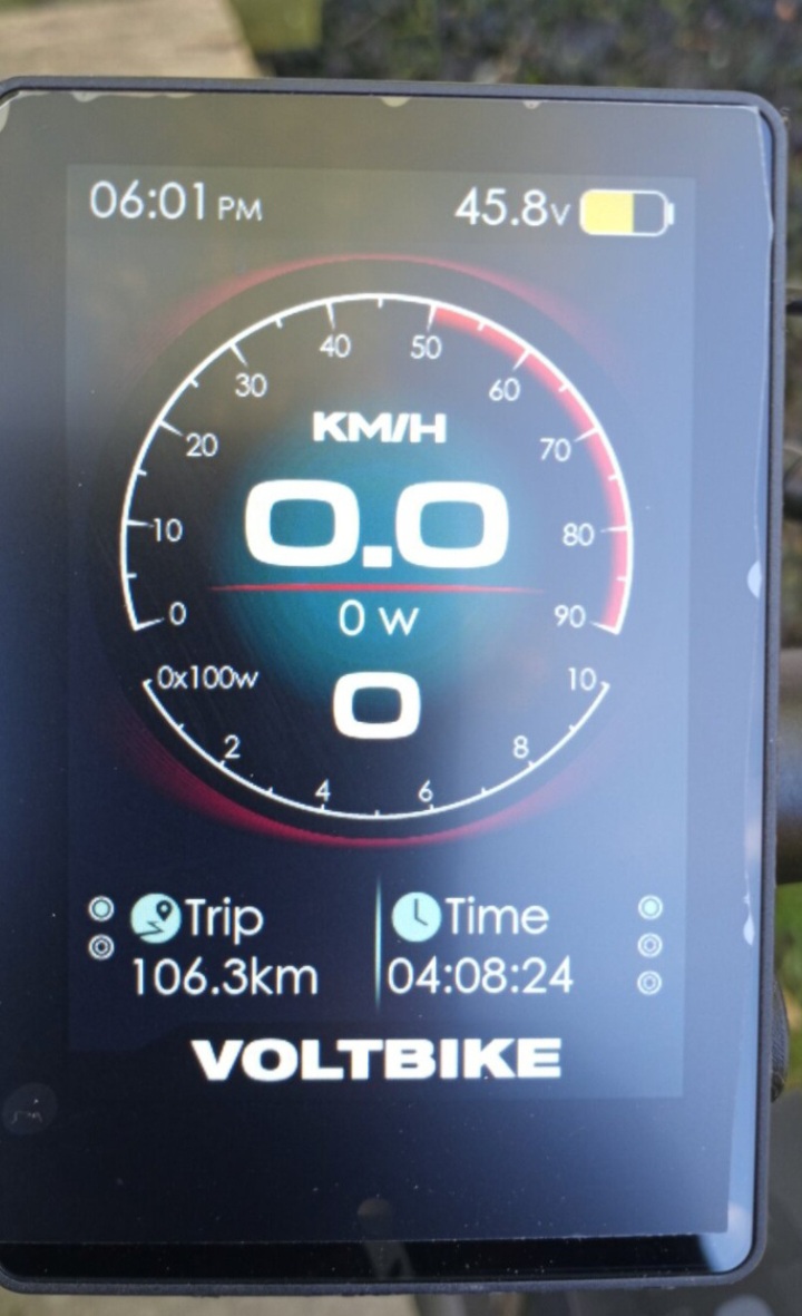

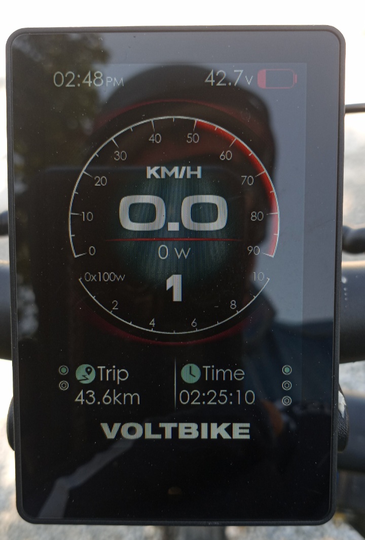

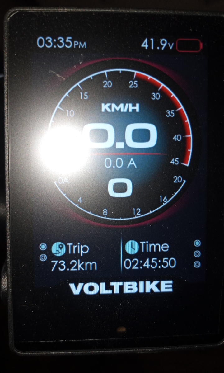

My ebike will go 43 kph with a fully charged battery (54.6 volts), then the top speed drops to less than 30 kph before the controller kicks out at ~40 volts.
All while drawing the same 21 amps from the battery.
