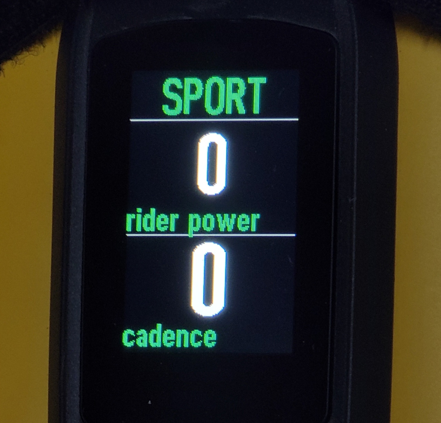

Down to 2 pages on the TCU on my new Vado SL 5.0: (1) the start-up page with ground speed and remaining charge, and (2) this custom rider power/cadence page. Flip back and forth between them, but I'm usually looking at this:
Never saw my own power before, and frankly I'm getting kind of obsessed with it. The real-time rider power display definitely prods me to work harder.

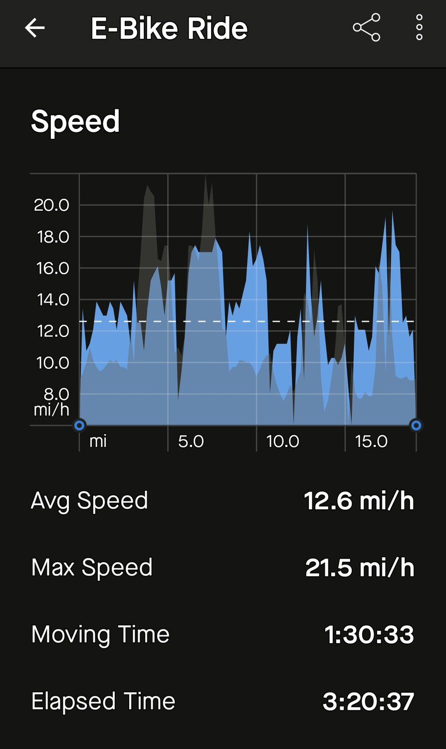

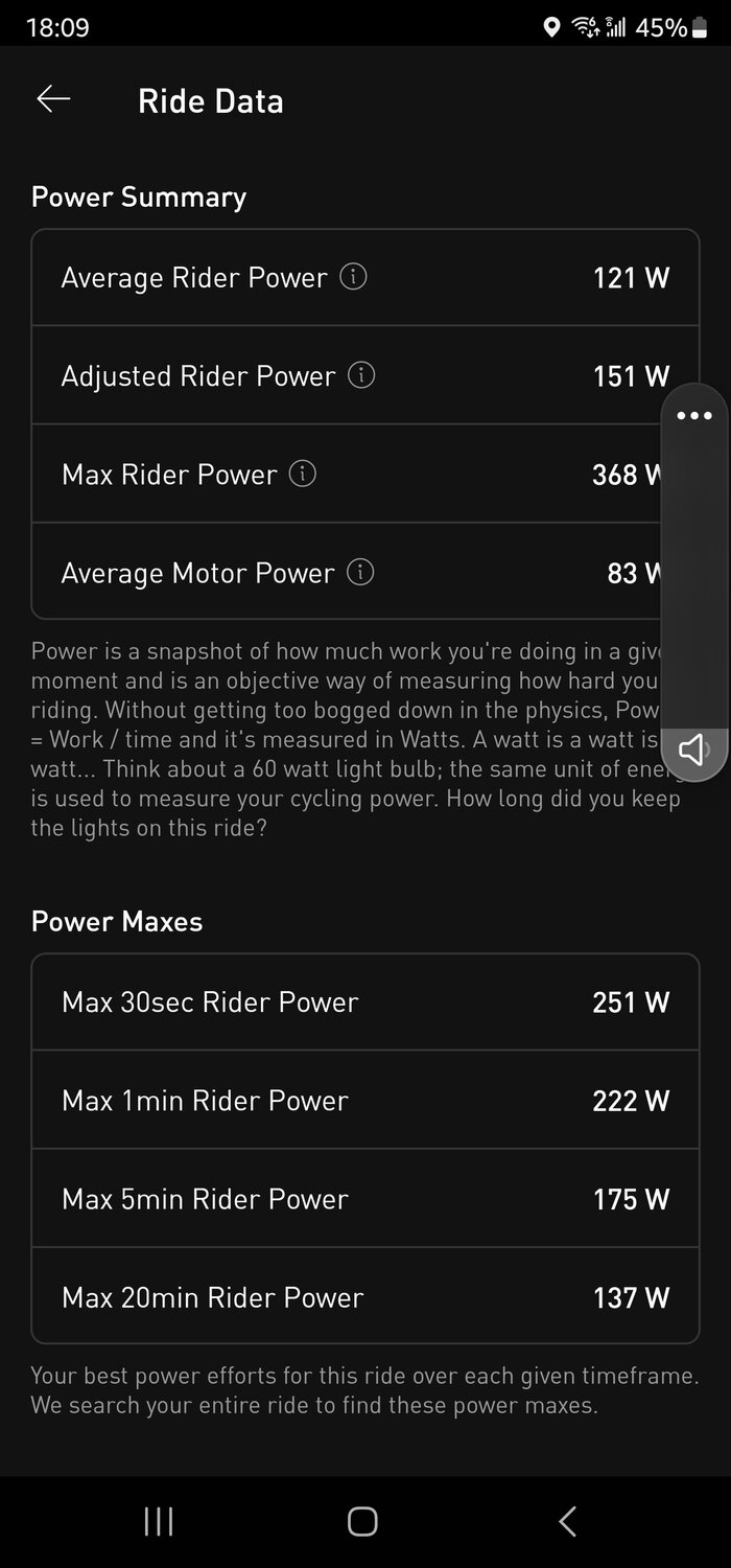

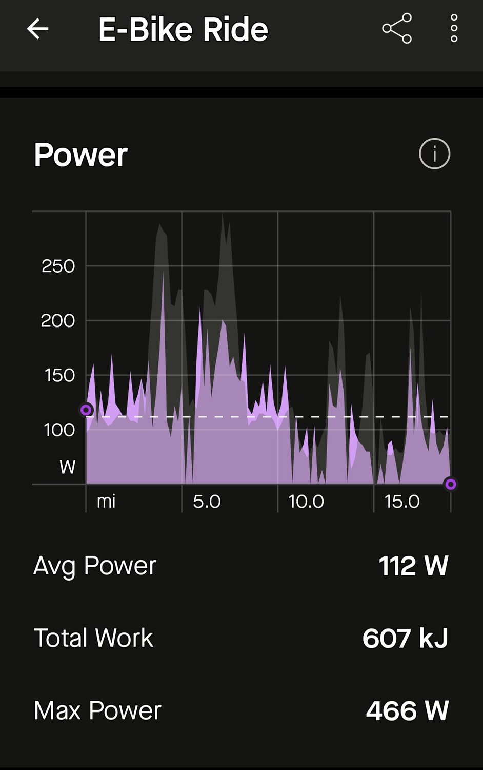

After finishing a ride in the Specialized app, I also get this rider power summary (from yesterday's undulating coast ride, mostly in ECO or OFF):
Have a pretty good understanding of cycling resistances and rider power on a scientific level, and I've read a ton on rider power monitoring in training. But have no practical experience with this kind of data on myself.
Q1. How do YOU do make use of such data in your own riding (any bike)?
Q2. Have you used the Specialized app to estimate your own FTP? Any tricks?

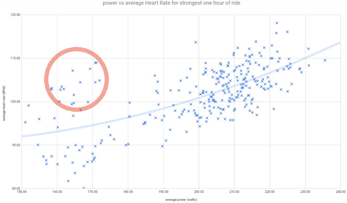

my interest in rider power started with my creo a few years back, and i began tracking it somewhat obsessively to understand exactly how much work my (genetically disadvantaged) heart was doing. heart rate is not a particularly reliable indicator of this, and perceived effort is even worse. if you ride the same route many times, or the same segments many times, looking at heart rate, power, and time give you a pretty complete picture of how hard you're working, what you're capable of, and how environmental factors and equipment choices are impacting the ride.
for example, if you're at the same heart rate, power, and equipment, but slower, you know that it's wind. if you're at the same power, equipment, and speed, but a much higher heart rate, you may have had too much caffeine, you may be dehydrated, stressed, your body may be reacting to a virus, or maybe you've got another health issue.
it's VERY interesting to hold power and heart rate steady (this is why having the app on your bars or the readout on the mastermind is great!) on a loop route (which neutralizes wind) while making minor equipment or position changes on the bike. on a drop bar bike you can see immediately the impact of riding on the drops vs the bar tops. you'll be able to tell how 30psi and 50psi vary, or whether baggy pants and a baggy sweatshirt really slow you down. (yes!)
now, getting into some more nitty gritty... the adjusted figure is not super useful if you have lots of starts and stops in your ride. i prefer to minimize those, keep my efforts very steady (better for the heart anyway) and those two numbers start to get very close. different apps also use different methods for "adjusted" or "normalized" power. i much prefer to track the "strongest hour" of my rides over time, knowing that most rides will have a one hour period where i'm riding steadily, fairly hard, and looking at the average heart rate for that period :
the rides in the red, where power is low and heart rate high don't fit on the curve. that's because they're all after a major health issue, and it's clearly taking a much higher heart rate to produce the same amount of power.

Earlier you mentioned "normalized" rider power — as I understand it, an averaging method designed to better deal with variations in rider output. From the app's description, Specialized's "adjusted" power sounds like much the same thing. Correct?
Exactly what I've been experiencing. Fun and illuminating at the same time.
it is, but it’s important to note that it’s averaging variation, and generally doing so non-linearly. it’s a good estimate of what you could have done for the same total effort if you were just riding completely steadily.
you’ll probably notice that if you’re cruising along at 125w, and then decide to go nuts for one minute at 500w, that after the big burst you’ll no longer be happy at 125w. the actual mathematical average may end up lower than 125w because of the recovery period - but that doesn’t mean you couldn’t have just sustained the 125w for the same apparent effort. normalized power takes this into account, as well as the outsized effect on averaging of stopping and being at zero watts for a few minutes. again, you’d have to ride much harder than the baseline to make up for that, even if you could have just happily cruised along at 125w.
