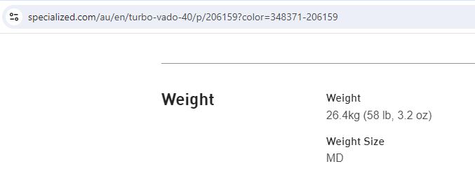

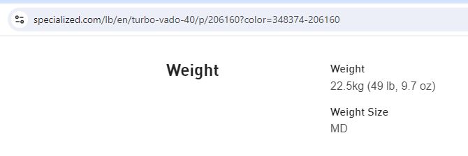

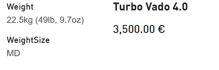

Pardon me? How come my Vado 6.0 with a 600 Wh battery weighs 26.4 kg or 58 lbs but the e-bikes listed above with a heavier battery should be as lightweight? I weighed my 600 Wh battery: 3.4 kg. Now, subtract 26.4 - 3.4 = 23 kg, and the number now starts resembling the "dry weight" of the current Vado 4.0!
How much the 710 Wh battery might weigh then? I can estimate its weight to 4.0 kg. How much the "wet weight" of Vado 4.0 be? OK, it would be 26.5 kg, or, basically the same as of my Vado 6.0. Mystery solved.

Everyone here knows I'm a pro-Specialized person. However, my finding of the dishonest work of the Specialized marketing department has really disappointed me. The disclaimer reads: '* Weights based on production painted frames as pictured. Actual weights will vary based on colorway, frame size, and component variation. Specifications are subject to change without notice.' It should read: 'Weights given without the battery'.

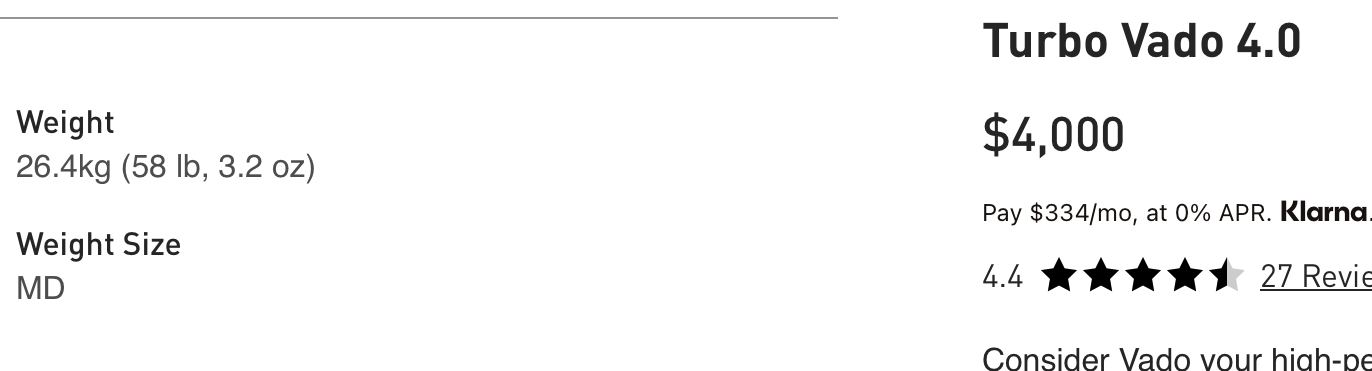

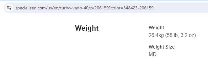

this is not the case in the USA. many published, professional reviews have weighed these bikes. for example, bicycling magazine states “The Turbo Vado 4.0 model we tested comes in at $4,000. Our White Mountains color test bike weighed in at 57.5 lbs. for a size large, standard style frame.” ( https://www.bicycling.com/bikes-gear/a37676844/specialized-turbo-vado-review/ )
specialized’s USA website states the Vado 4.0 weighs 58lb and change. well within the margin of error for minor component changes, frame size, color, etc.
a mainstream review of the turbo tero x 4.0 in wired magazine states “It weighs a bit over 58 pounds” and specialized’s USA site claims 57lb 10.4oz. again well within the variation of sizes, colors, and component changes.
