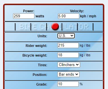

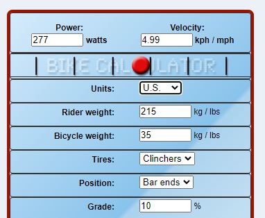

we do need to know how hard you're pedaling, since the amount of work it requires to lift 18lb up a mountain is fixed, but the assistance supplied by the vado SL is proportional to your pedaling input. also not clear exactly how steep the climb is - but let's say it's a sustained 3,500 foot climb at 10%, which is very steep, and pretty unusual for a california road, but possible! at 10% it would take 6.6 miles to go up 3,500 feet, so that's pretty close assuming your 12 miles is a round trip.
here's how much power it takes to carry you and a road bike up that mountain at 5mph - 260 watts.
then let's say you wanted to ride the vado UNPOWERED up that same climb. we'll add 17lb.
it now takes 277w. the difference will be almost completely proportional to weight - the effects of friction and drag are meaningless at these speeds. it's ALL about gravity!!
so, in this particular case, you'd need 18 watts of effective power from the motor to equalize these scenarios. the motor is around 80% efficient, so the power supplied to the motor needs to be 20 watts. in our example, you were pedaling at 260 watts to go that fast, so there really is no assist setting which would produce so little power. a setting of 5/5 would still be too much, but in my experience super low settings like that just produce no power at all - the motor is not designed to go that "slow" as it were.

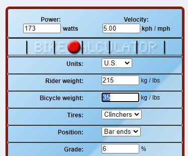

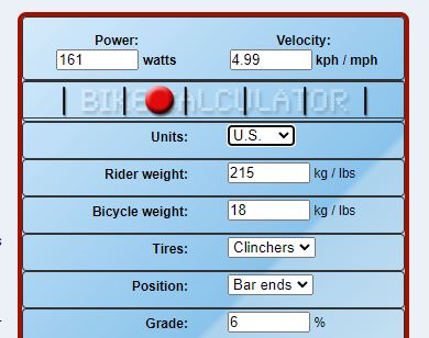

let's change it around a bit to get closer to what your output probably is. changing the grade to 6% (typical sustained grade of california hill climbs) reduces your contribution on the road bike to get 5mph down to 161w, and you need another 12w (15w at the battery?) to equalize the weight. the 15w is around 10% of your output, so with the vado SL's 2.0x power factor (remember we're using the actual power draw, not the output) that's an assist ratio of 5% still. one caveat here is that the efficiency of the SL motor is likely MUCH MUCH lower than 80% when it's spinning so slow. i've seen charts that show 50%, which would bring the needed setting closer to 10% than 5%.
the conclusion is that based on weight alone, there is no setting low enough to compensate only for the weight of the bike, and nothing more. with a lighter rider and a bigger difference in bike weight, you start to get there. a real world example of this is a local hill (much shorter than yours, but fairly steep in sections) that i rode on my creo sl around 50 times - 25 powered, 25 unpowered, and then another 50 times on my s-works aethos (14lb bike), and the theoretical results very closely matched the predicted results if enough rides were averaged out to neutralize the effects of wind and other random stuff.
