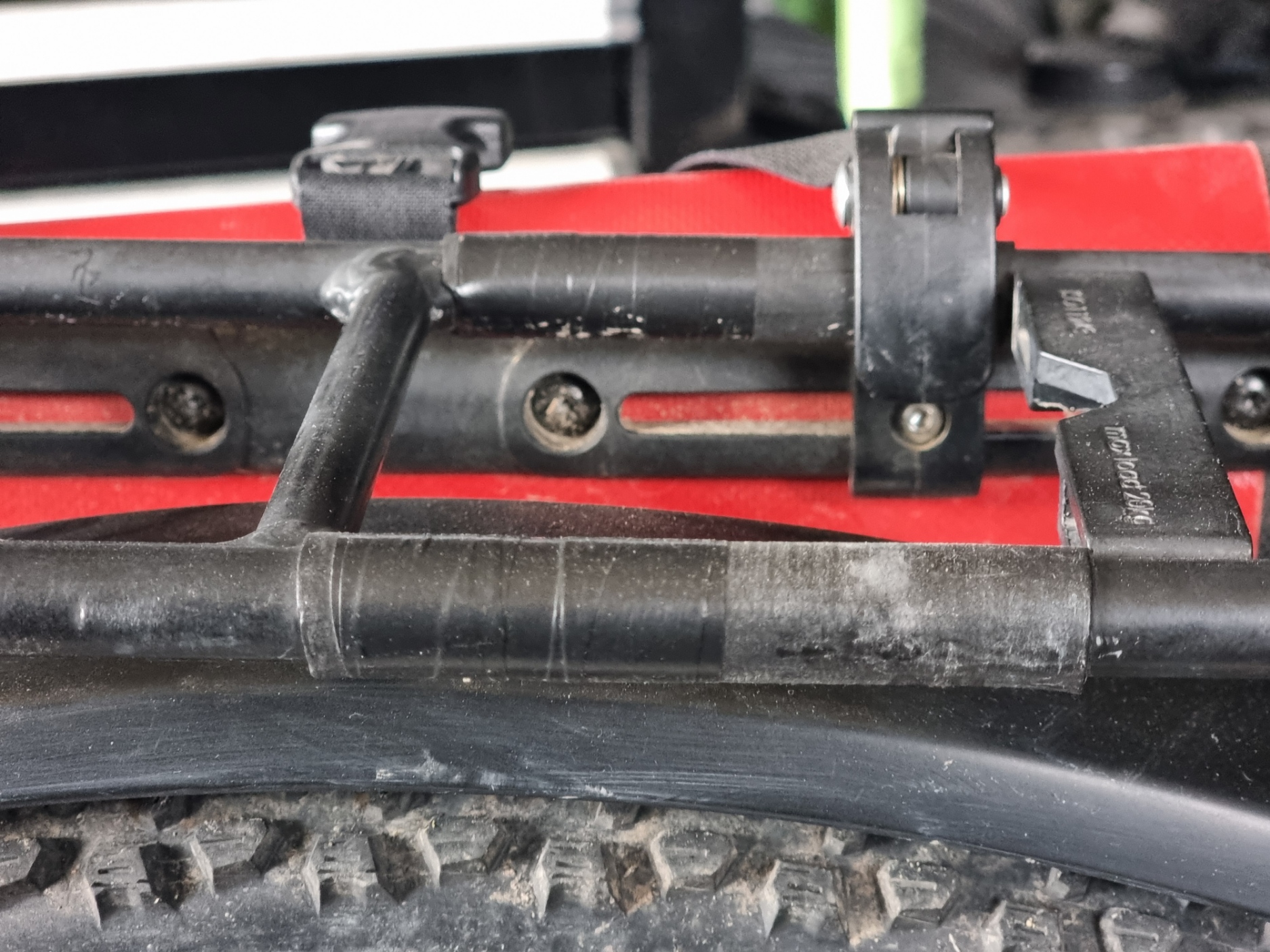

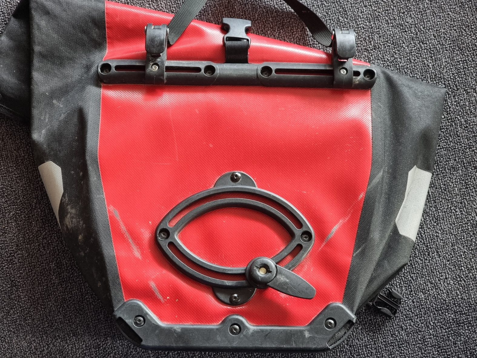

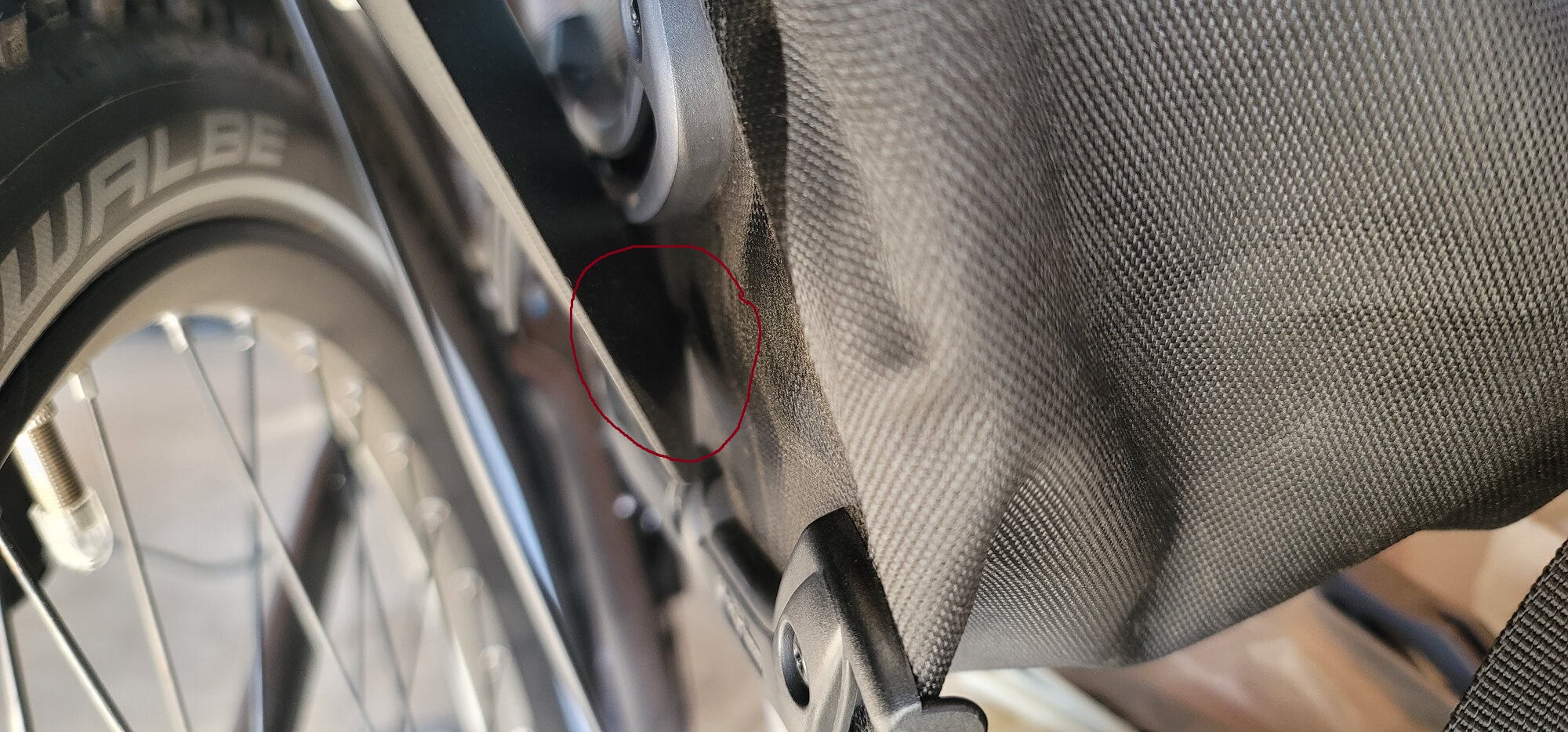

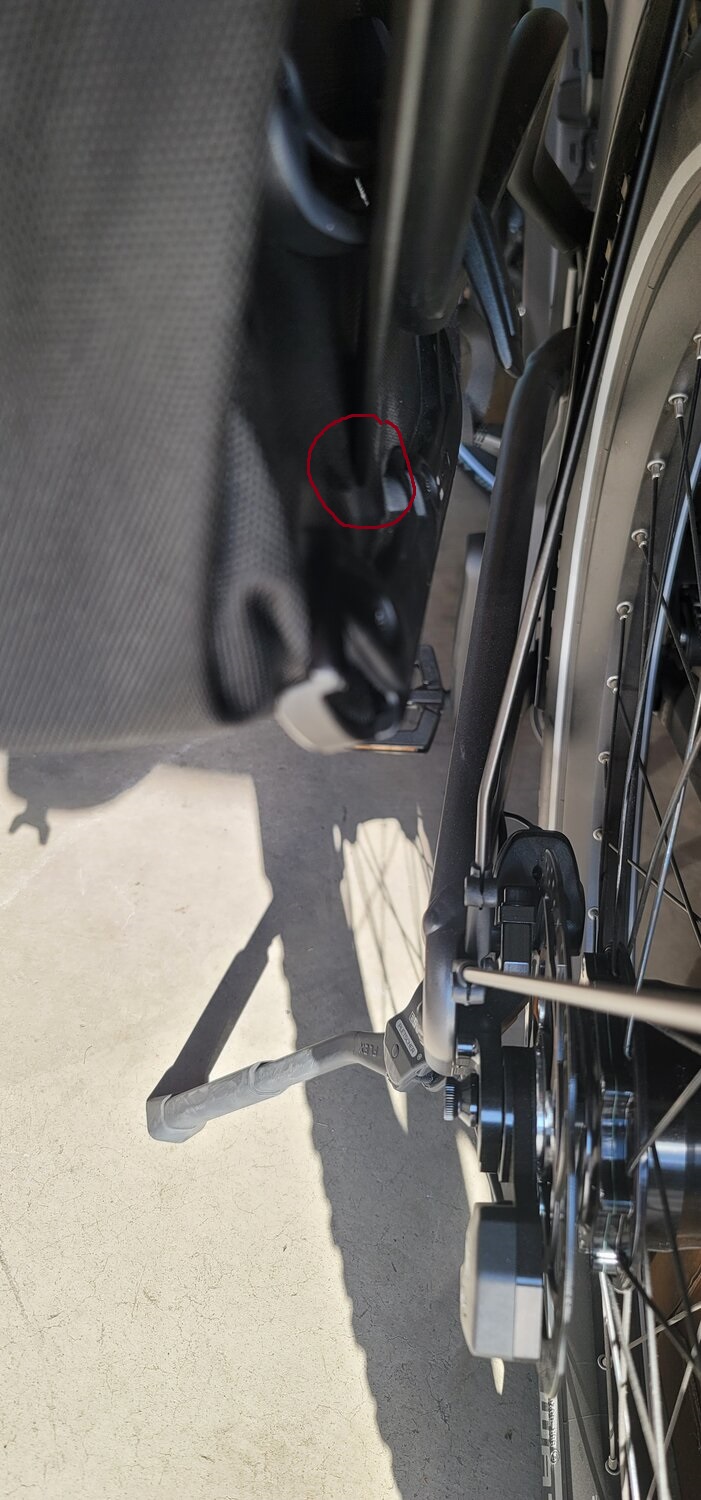

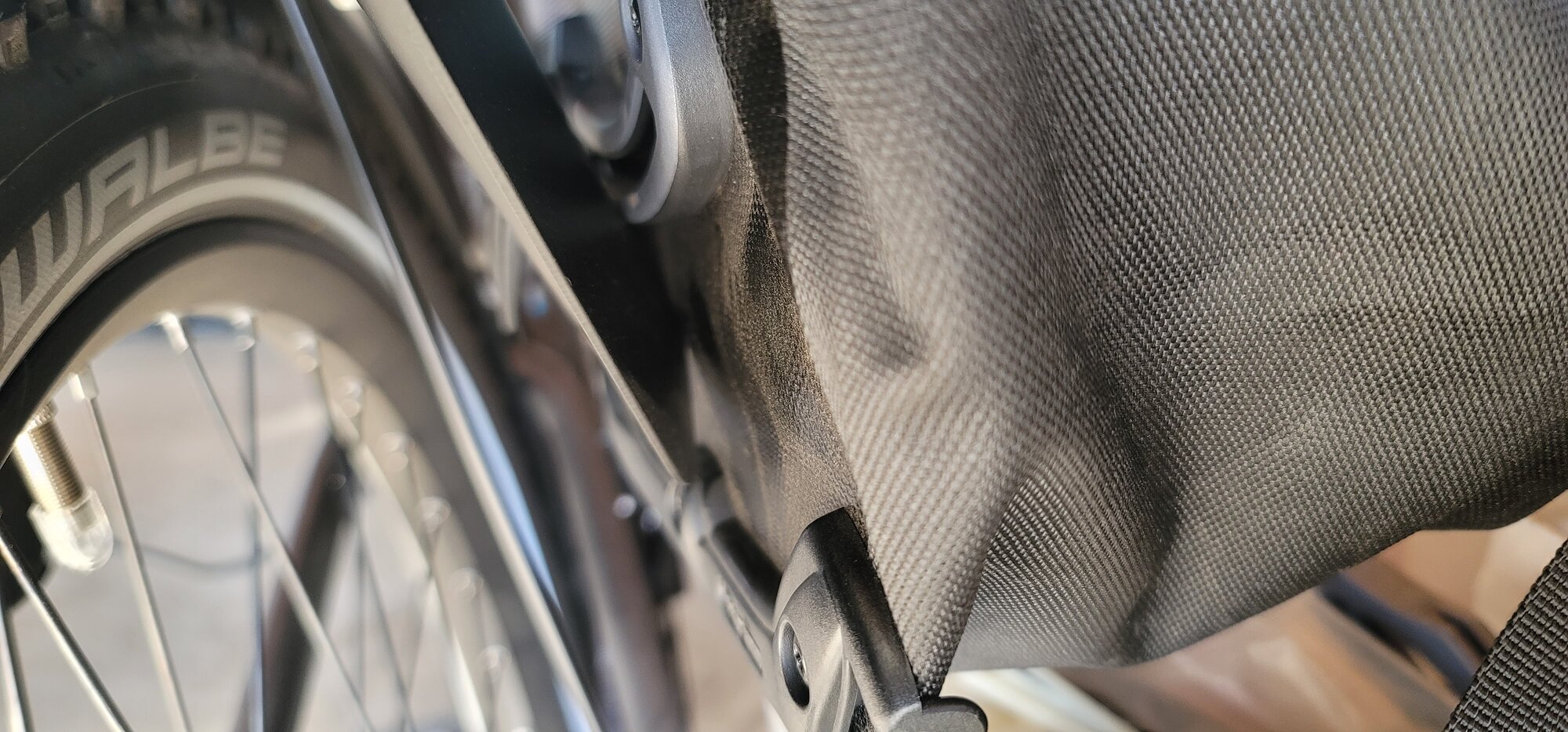

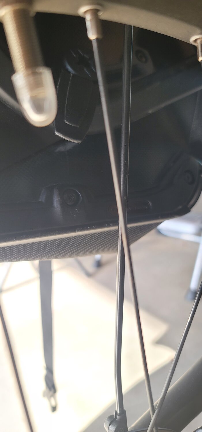

I noticed yesterday both my paniers are developing a wear mark from the delite rack(see pictures). Today I adjusted the bottom hookspacer to its thickest orientation and rotated the bottom rail so it resemble a frown. I also put some anti chaffing strips on the rack and the bags where they come in contact
If anyone's running these panniers would you mind posting some pictures of your orientation

Difficult to see what wear you are talking about in the photos. I guess it's black marks on black fabric - always difficult in a photo.
I don't have a Delite, but considering one, I can only talk about my experience with other bikes and my current Supercharger.
Panniers will always wear, it's just the nature of the beast, but at least the Ortliebs have a waterproof coating on the inside as well as the outside. The question is what does wear, and how that can be reduced.

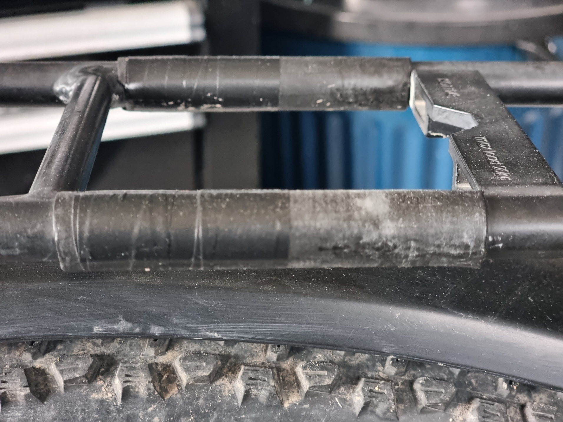

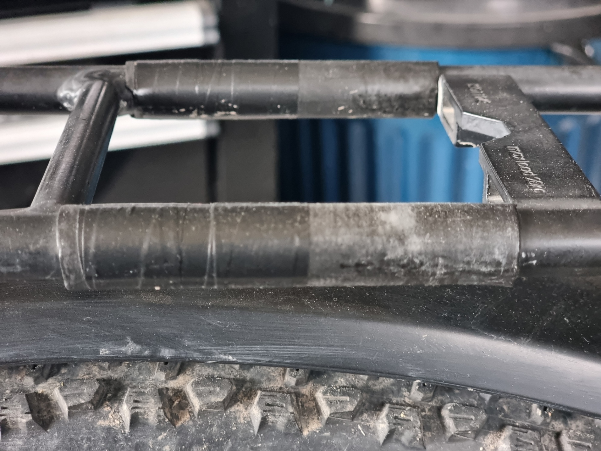

Hard pannier plastic against the frame/carrier. This I try and avoid at all cost as it is the aluminum frame that will suffer and quite quickly wear through. I protect the framework by using insulation tape or preferably something like thin wall irrigation hose to the frame. You can see a piece of hose that I split and taped in place in the carrier photo. It might look ugly, but hey, I'm long past worrying about that sort of thing. [Edit: added second photo showing one pannier in place.]
Pannier fabric against the frame/carrier. No real protection against this, the fabric will eventually wear though from the continual movement - I've had panniers held together with sticking plaster in the past! If possible I try and adjust the pannier so that the fabric sits against the frame/carrier. In the photo of the fairly new pannier, you can see the carrier wear marks on the fabric, the pannier deliberately set up so the hard plastic was not against the carrier.
Hope that is of some use.

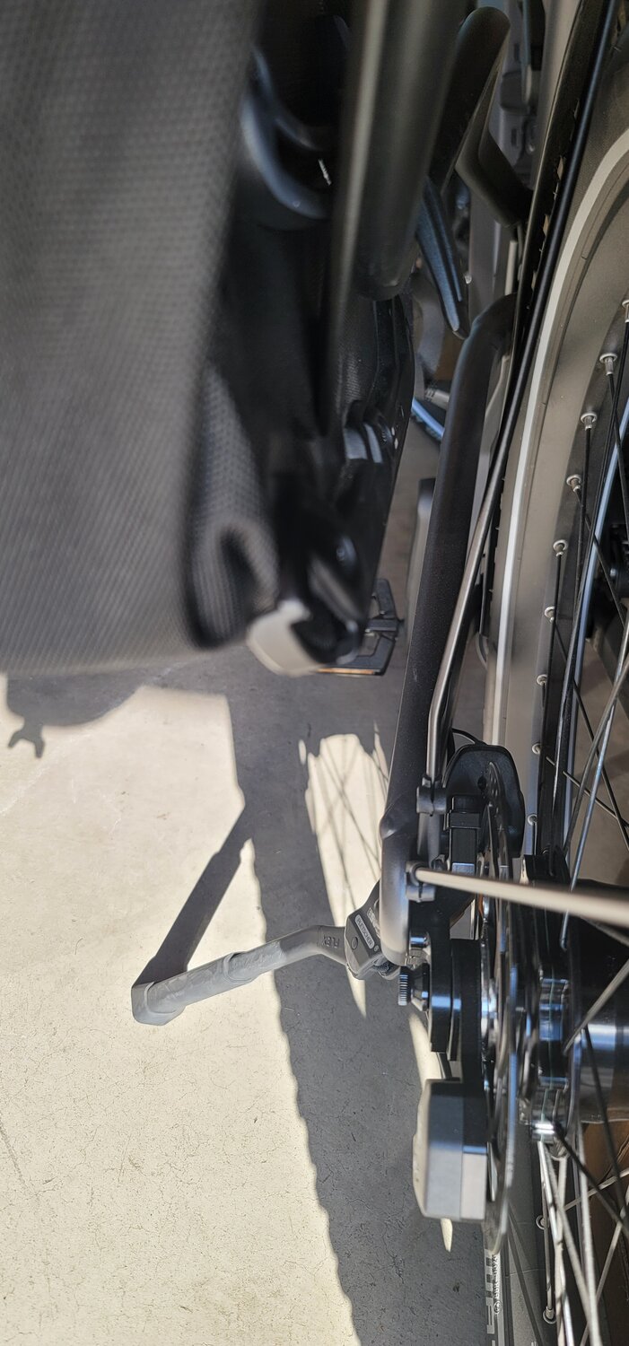

Can I ask if you have any heal strike on your panniers with the Delite? The carrier seems to place them much further forward than most bikes.
I have used helicopter tape with limited success. I like your idea of using an irrigation hose so I will give that a go.
To the OP: I have Ortlieb Back-Roller Plus panniers ( four rear to allow for use with the Extrawheel) and two front and have used them for ~15 years and thousands of kilometres without any wear issues. That is not something I have ever considered, to be honest.

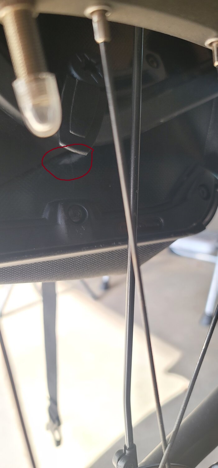

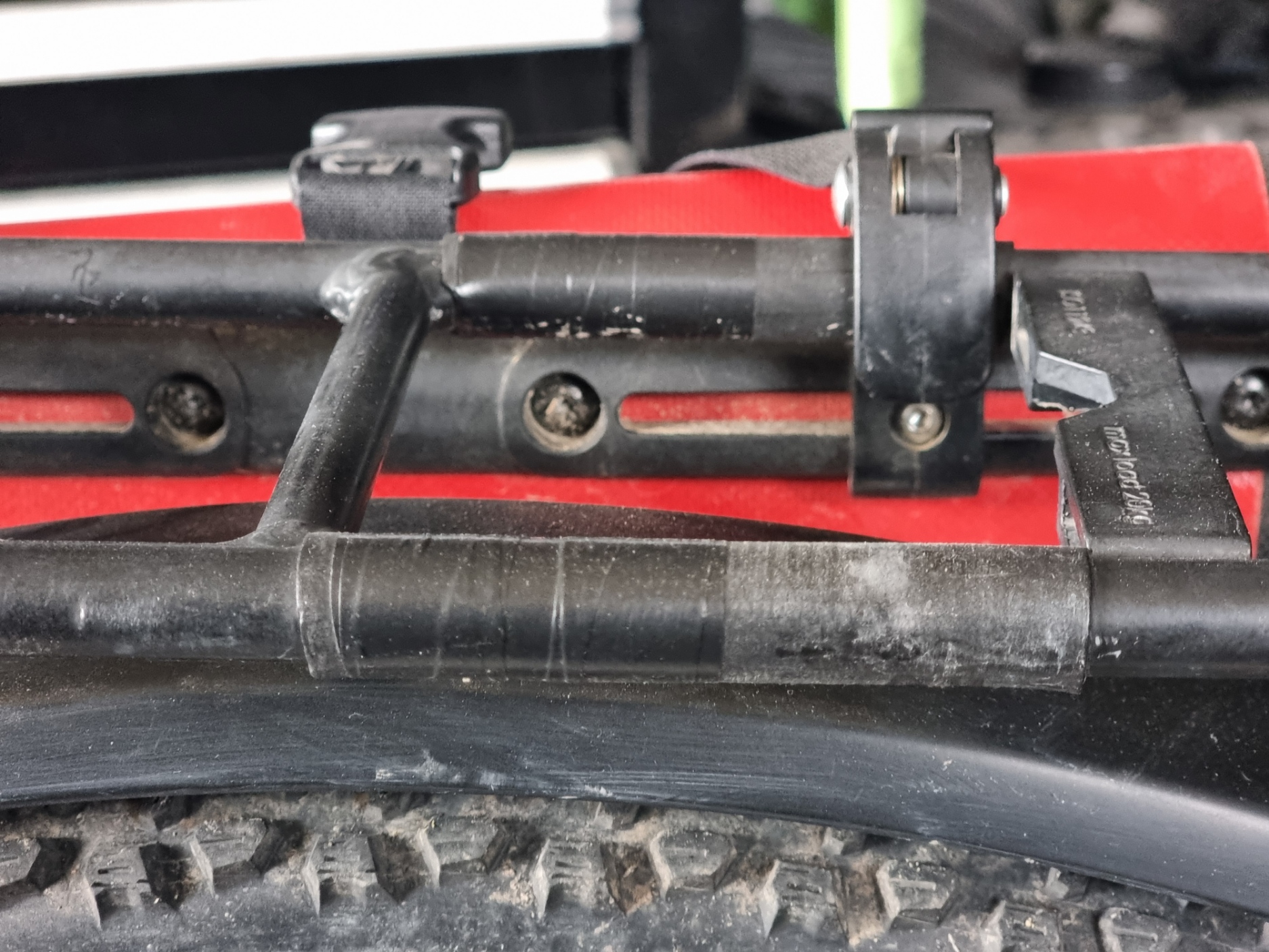

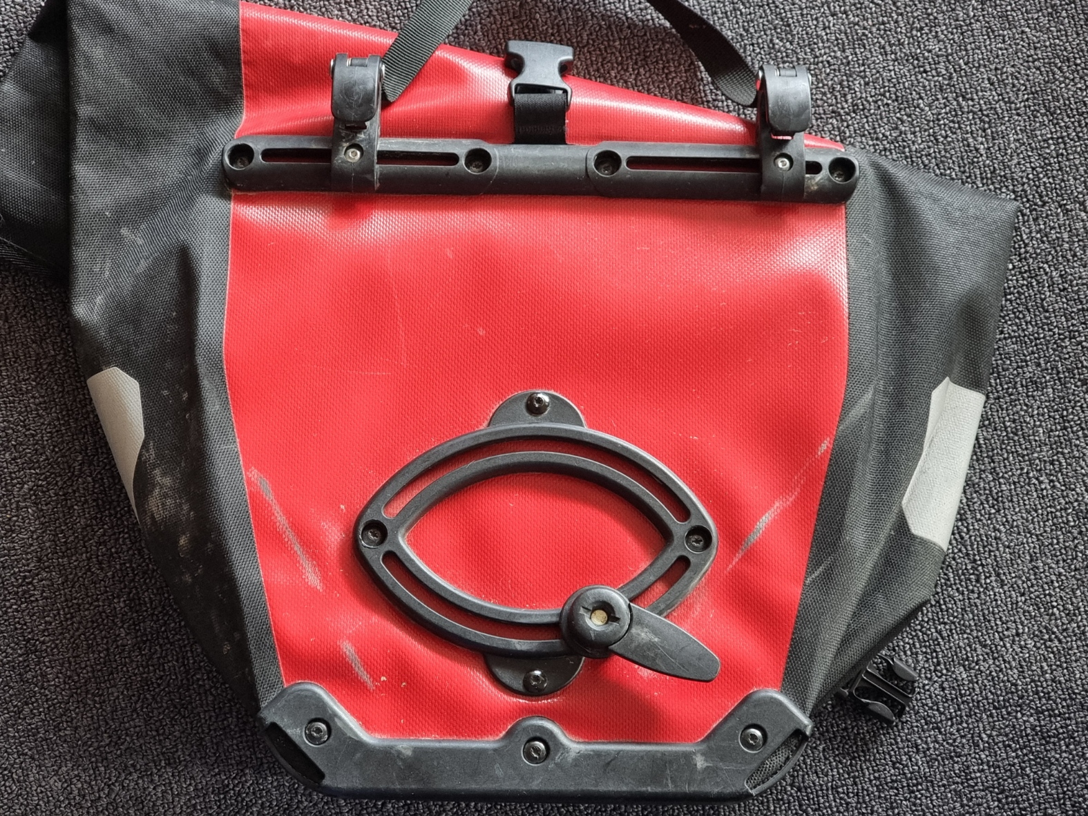

here are the images with the area where the bag and frame are touching circled in red. one of the pictures also shows the wear mark on the bag which is similar to the bag shown in the 2nd post.

Santana, it's still not clear. If the wear is at the pointy bit of the rack V, it may be that a bit of reshaping or fitting of an additional guard is in order. I don't have a Delite, so can't offer much more help. It does make me wonder though, as a Delite is on my short list for a new bike, and I use Ortlieb panniers. That said, the rack on the Delite always struck me as form over function, it's good point is that it is sprung weight.
@Aushiker . That irrigation tube is ID13 mm, wall thickness 1 mm. The rack is 14 mm diam Al tube, so the fit is not to bad (has a bit of a gap at the split), and the panniers are a snug fit with no spacer - which means that they do not rattle. Yeah!
R&M makes TuffCoat foil available (free) via your dealer to protect the rack. Comes in sheets and actually works well. Don't know if they've continued the practice -- I was given some in 2022.
