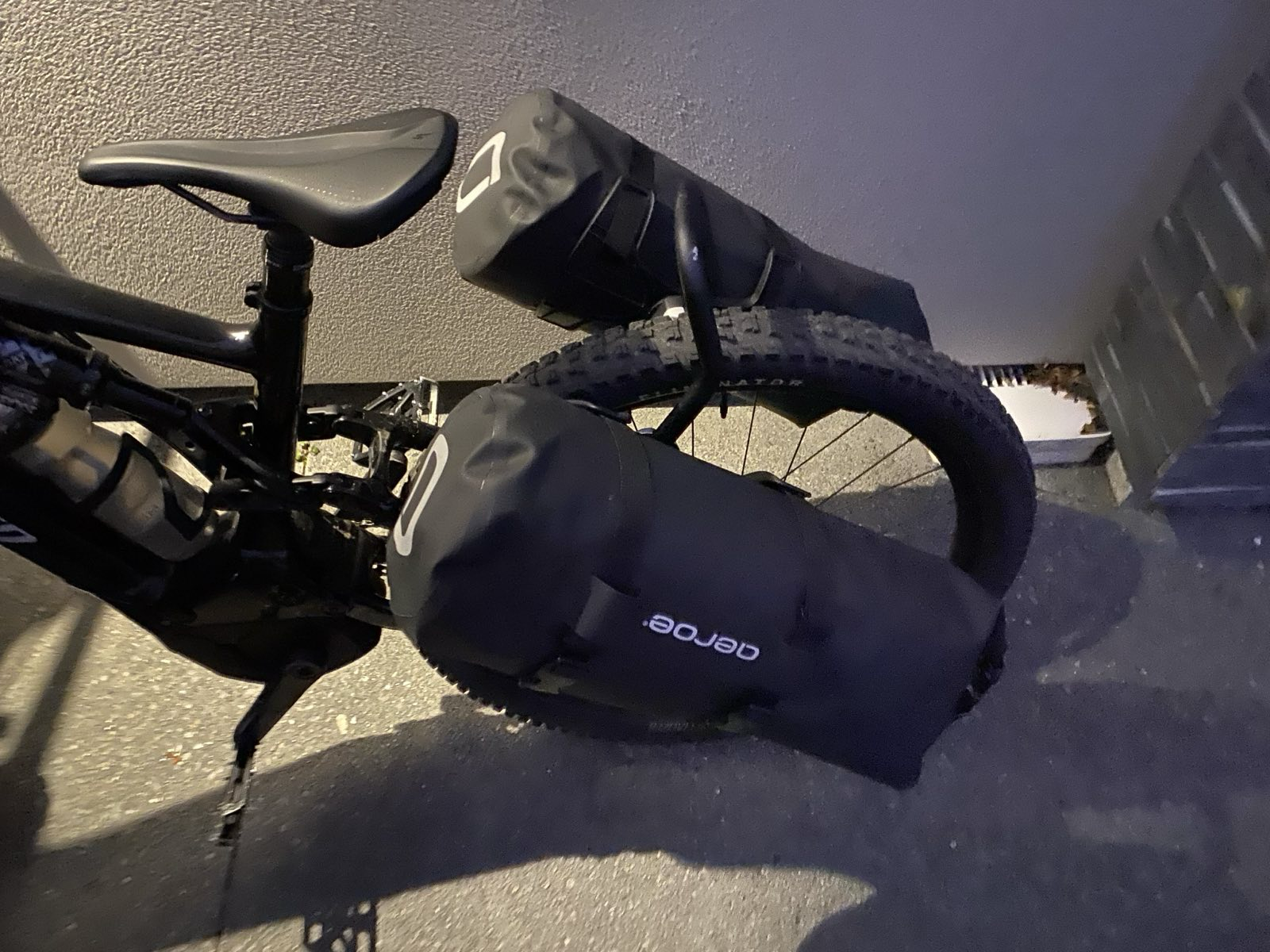

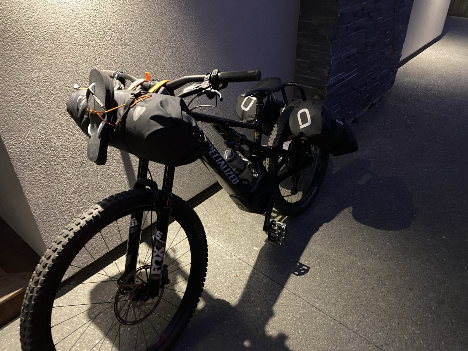

You can get solutions for eMTB - I’m using the system from www.aeroe.com and have mounted it on my specialised Turbo Levo eMTB.
This is a full suspension bike and this racking system works:
No seat post bag so I can still use my dropper post. Aeroe racking system very versatile and I swap between my bikes.
This has a 750wh battery

@sammcneill. Yes, I know of the Aeroe systems, but the engineer in me cringes every time I see that rear rack attached to the seat stays. Although all things are overdesigned to ensure safety, I'm not sure that frame designers allow for what is in effect a huge lever wiggling away in the middle of the stay. I'm not sure I could bring myself to do it, although my mate has one. That said, I've not read of any snapped stays - it would be somewhere on Reddit if it had happened. For a hardtail I think there are better solutions utilising the Old Man Mountain adaptors if necessary.
But never say never, as I'm not doing hard core mountain biking (more think of the Rainbow Road type stuff), and I do have a shortlist of eMTBs with high battery capacity :).

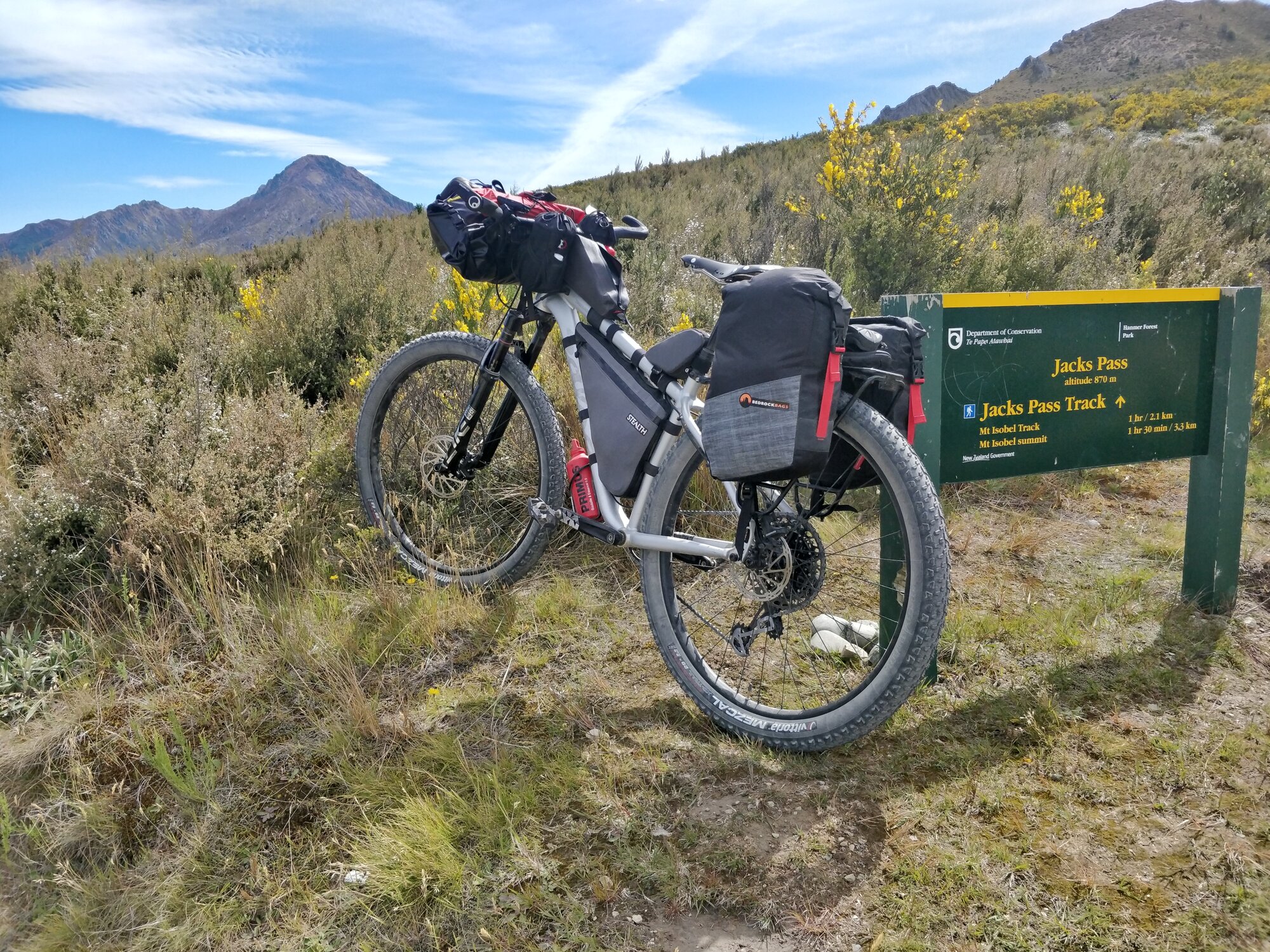

So no feedback on the Delite standard carrier? Here is the sort of loading I'd like to be able to accommodate set up with 6 days of food. Without the frame bag of course.

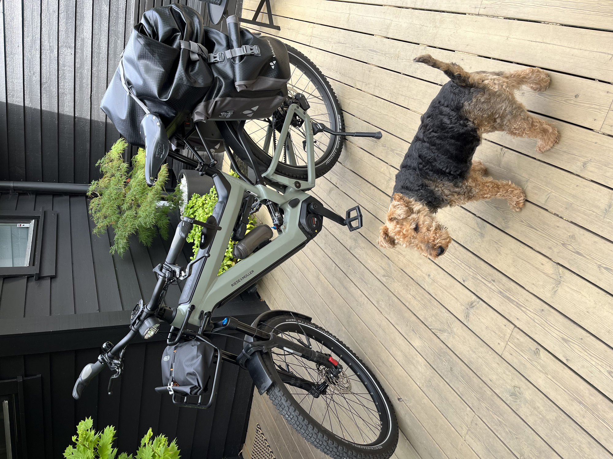

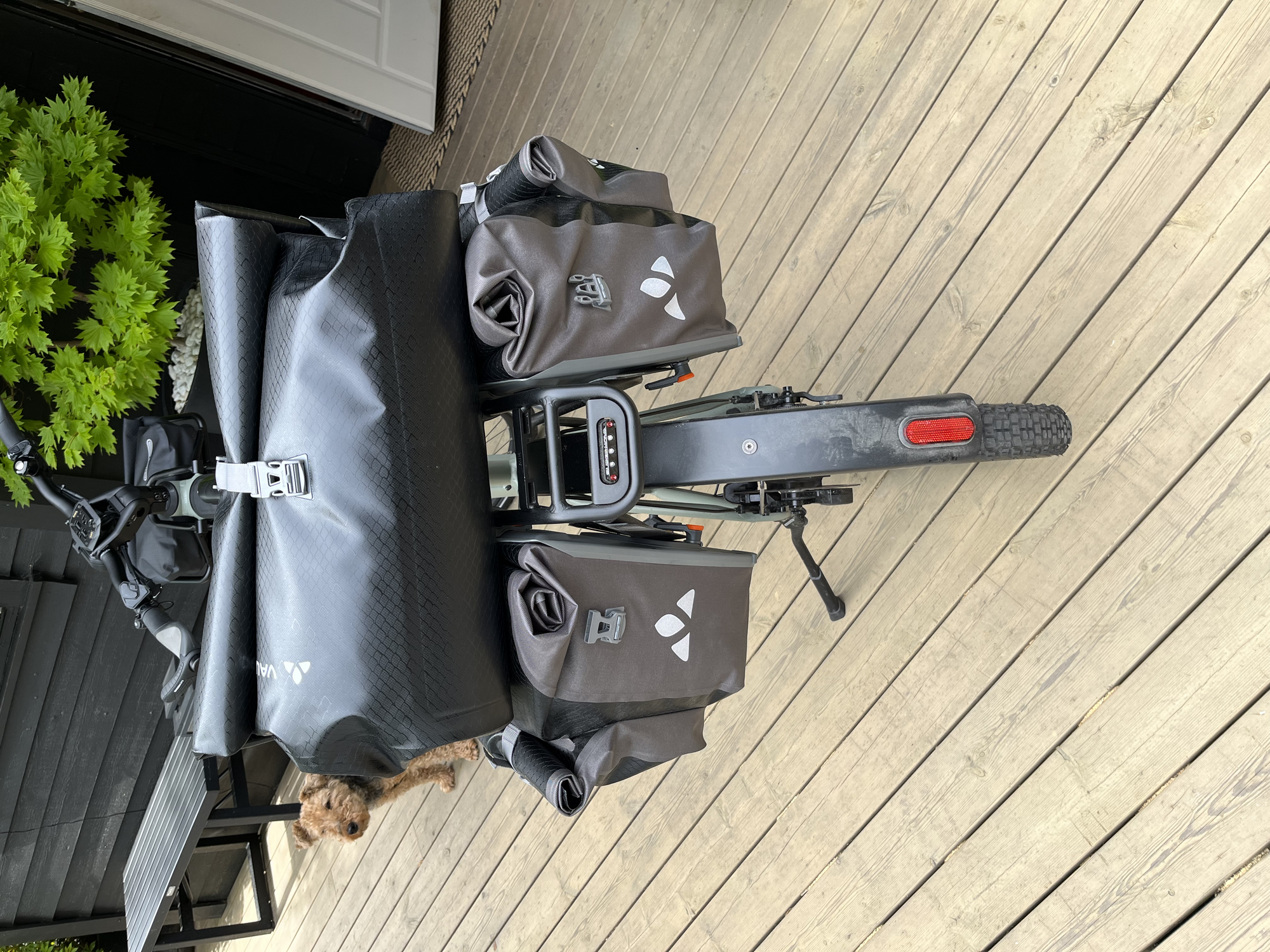

I hope it's alright if I reply to this old thread? I have a Superdelite with Fox suspension and apart from the odd pedal strike, the hight of the bottom bracket seems perfectly fine. The bike is used for daily commute as well as going bike touring - and it is rather impressive in that regard. We usually ride for a couple of days and a typical ride is from 10 to 15 miles (100 to 150 km). The bike is packed up to the limit with food, tent etc. and the total weight is about 150 kg -including myself :)
The rack does not flex in any noticable way and the bike is composed and sturdy on roads, "tractor roads", gravelroads etc. It's also reassuringly stable going fast - at least up to around 60 km/h.
Now, I have had to lift the bike over a few fallen logs when the satnav/gps has led me astray. It is heavy - especially as most of the weight is located towards the center and back of the bike. The "walk function" does help though and usually you don't have to wear yourself out. My mate has converted from e-bike to a Kona Sutra - which is a lovely bike, but the Superdelite really comes into its own in harsh terrain - even loaded up with all that gear. The low gearing of the Rohloff and traction offered by the suspension and Schwalbe tires makes easy work out of seemingly hopeless terrain. Ruts, slippery moss or wet stones - no problem at all.
The Kona is more for bike touring on asphalt and gravel roads, but the Superdelite can carry the same load and still perform in far rougher conditions. Also, the range is impressive. To even out the difference and strain, I mainly use the Eco level when riding with friends on "analogue" bikes. On the west coast of Norway where I live it's very hilly and fully loaded up I had 43% left when returning home after 11 miles (110 km). With the extra weight of the bike and in "Eco mode" the cadence, effort and speed seemed fairly similar to my mate on the Kona. I could not achieve his top speed though.
Most of my friends have gone for Ortlieb panniers and they seem to be of very good quality. I chose Vaude as I think their outside pocket on the panniers is a neater solution. I'm very happy with them.
