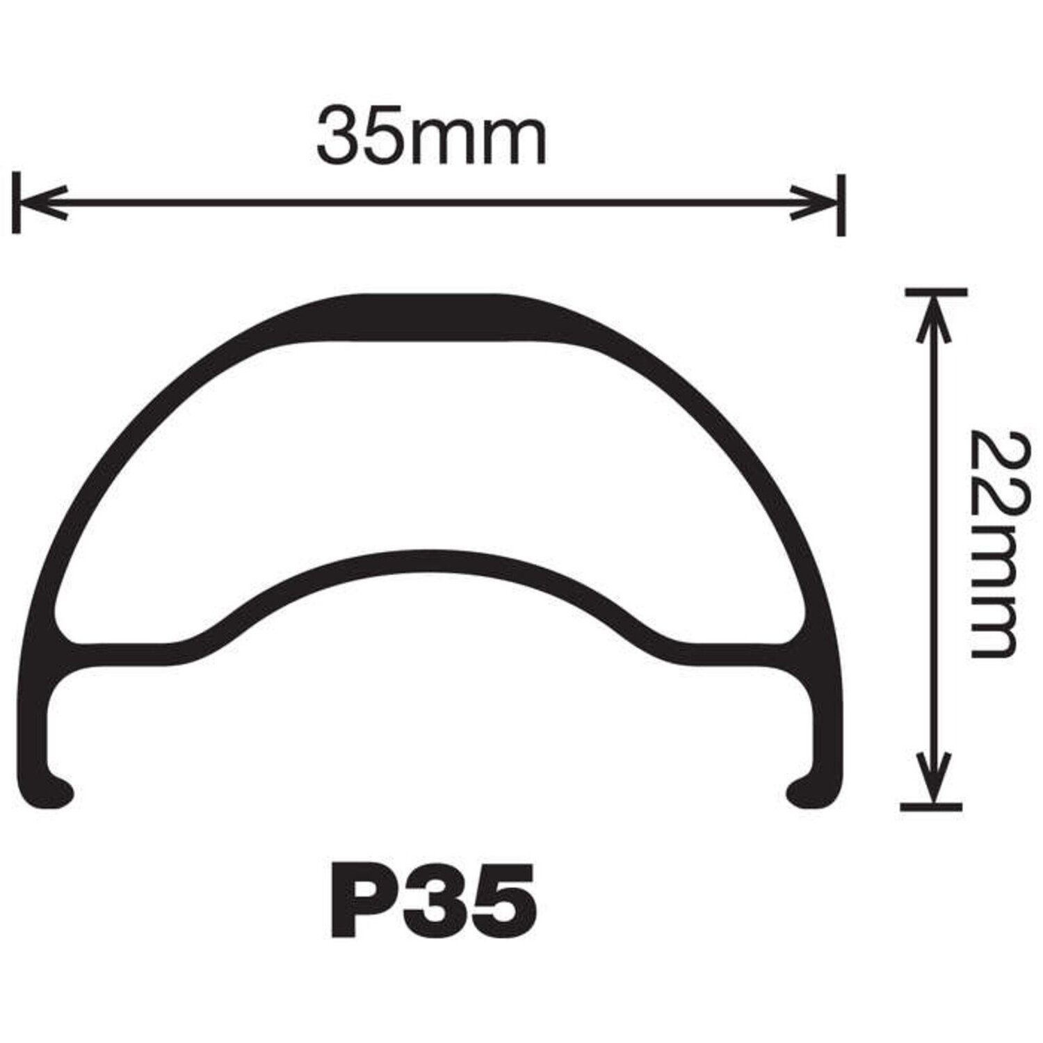

One of the things I try and make sure of is a rim has a depressed center area, which is what lets you unseat a tight tire bead on modern wheels, which tend to be really tight compared to bike wheels of say 10-20 years ago. On my Surly Big Fat Dummy, the factory My Other Brother Darryl rims (yes they are really called that) have no such center depression and they are an absolute nightmare to work with. Even my LBS struggled mightily with them. So I knew I had ZERO chance of even fixing a flat roadside. For that reason a custom wheelset became a requirement on a bike that, at the time, was my daily driver.
With The MYOBD rims, a tire bead removal was a 30-minute fight requiring two hands AND feet. My LBS physically snapped two tire beads trying to do it for me, and earlier I freaking cut one with shears to get a worn tire off. With the replacement wheels, it was 5 minutes' work and easily do-able on the side of the road if needed.
See the depression on this rim profile? Push the bead of the (totally deflated!) tire from one side INTO that depression. This will create some slack and you can probably get your tire bead off on the other side with a lever once you do that. If you can't, push the other side of the tire into the depression too and try again.
