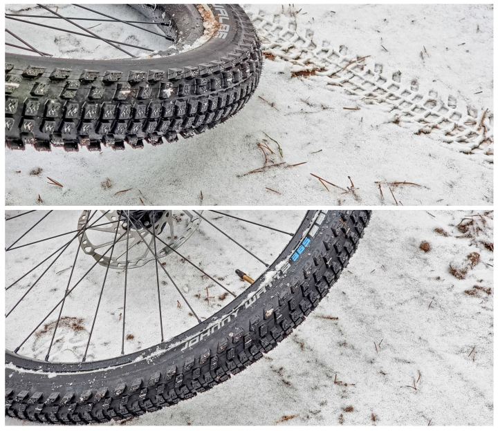

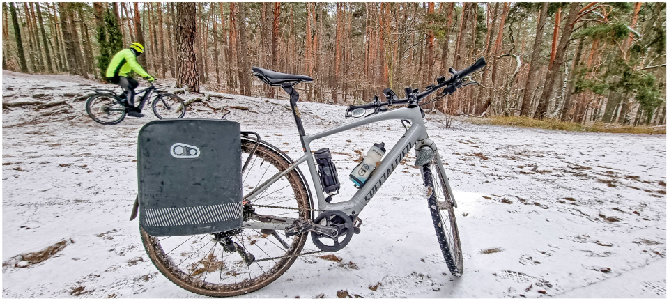

Johnny Watts 365 (65-584) as ridden in the forest in light snow conditions (it is not what you usually experience in Denmark!) The major difference is these tyres have been used on an e-MTB with the rims made exactly for that size. See the ideal tyre profile here: the side walls are almost on the vertical relative to the rim!
The e-bike I'm talking about can be seen in the background, the same ride.

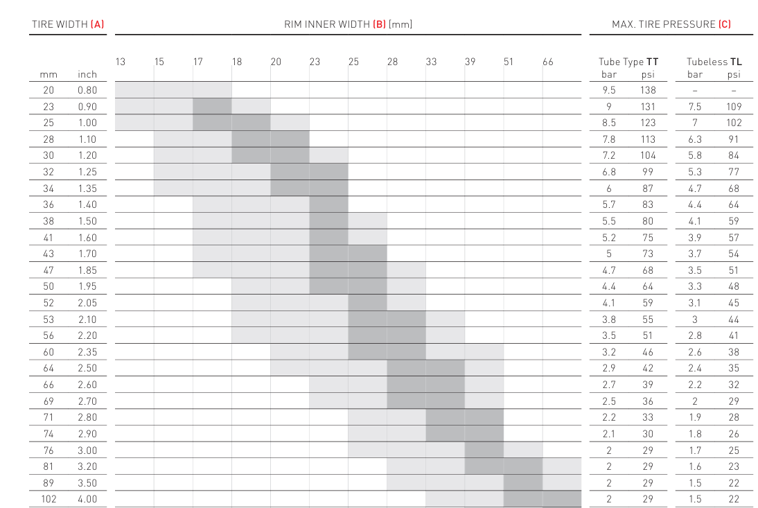

See the linked tire/rim width chart.
https://www.schwalbetires.com/media/16/8f/9b/1654668257/reifen-felgenkombination-etrto-22-en-2.pdf
The only question is what is your internal rim width. You could measure the outside rim width and subtract 5mm (typical difference between inside and outside rim width).

I would rather trust the rim manufacturer (DT Swiss) than a tyre manufacturer (Schwalbe).
If Gazelle chose 25 mm inner width rims, going above 50 mm tyre with is a no-go. It requires a 30 mm inner width rim to go wider. In very rare situations, 27 mm rims are installed (it is my Vado's front wheel).

First of all, it's not a dt swiss rim, secondly, if I look at the above table, 60 mm should be fine.
