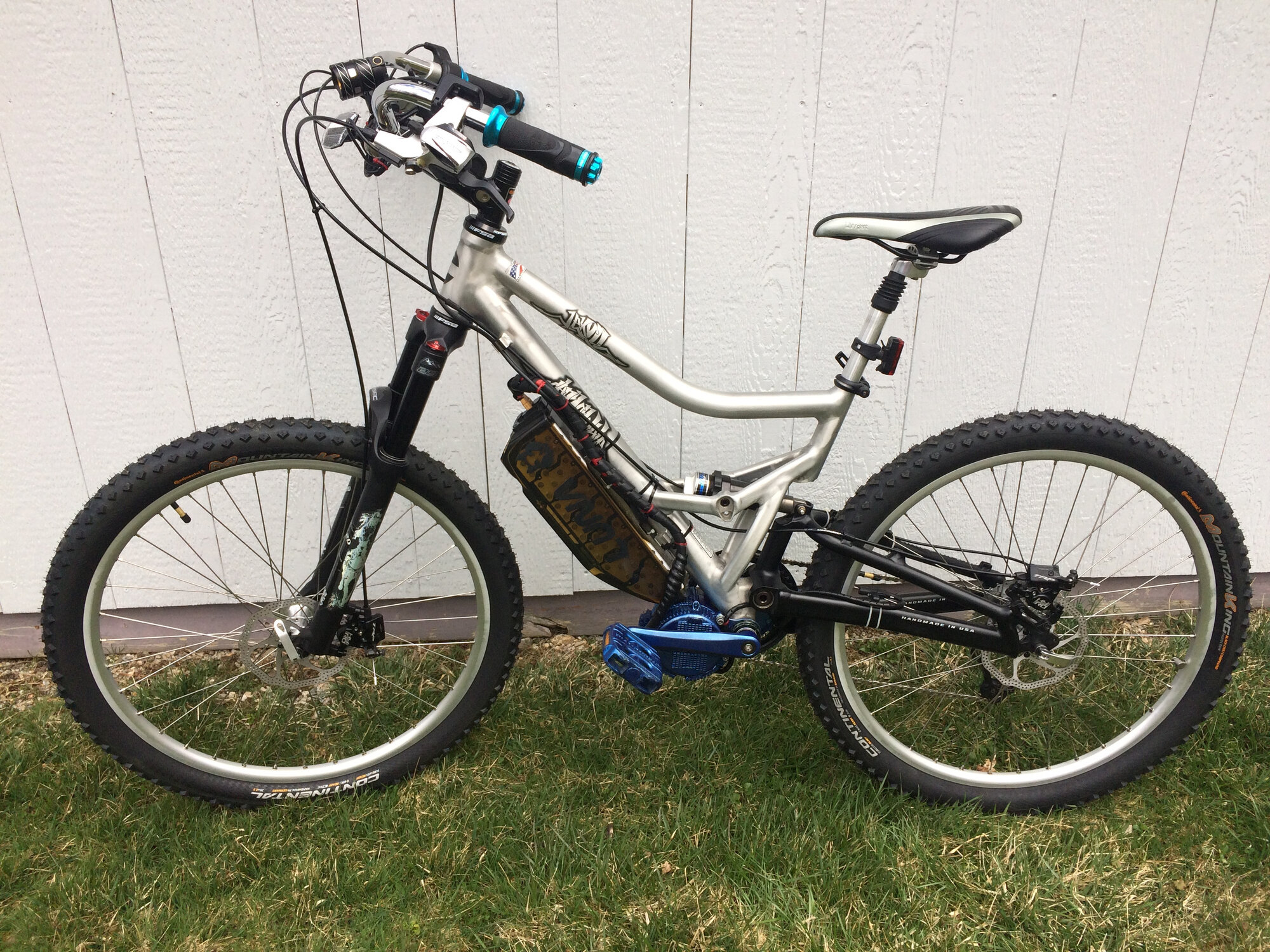

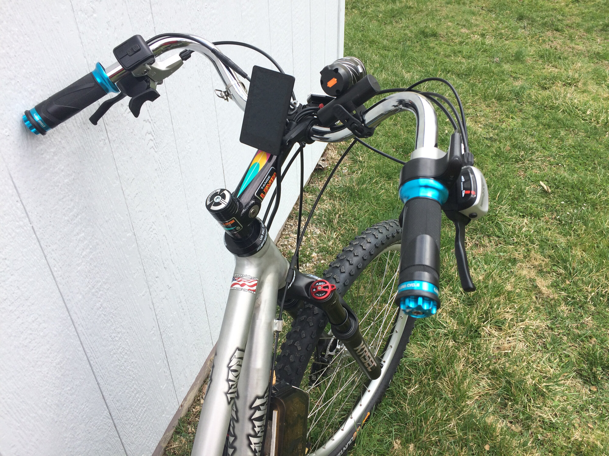

'20 miles from a decent store or farmers' market miles of dirt roads I must use going in one direction, and they are steep and washboards with potholes. A lot of the roads here have almost no shoulder and what is there is a mix of gravel, rock and dirt.torque to get me and my groceries and maybe my dog up the last really steep hills home"
I'd ridden thousands of miles on my 25-pound bicycle when it was stolen from my basement. I bought a 270-pound motorcycle. Before taking it on the road, I spent a month riding on rough fields and steep hills. I discovered that the low center of mass made it easier to handle than a bicycle.
