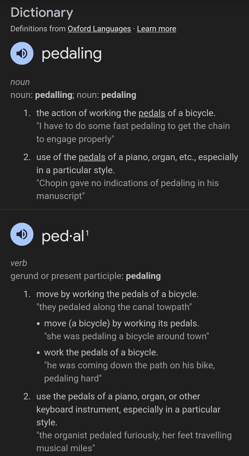

Pedalling. 🥸
I was taught pedaling, modeling, canceling, but that was much farther from Wales.

Pedalling. 🥸
I remember that from grade 7 spelling class.
Pedal is pronounced pedal.
If you add an "ing" to it, you have add a second "l" first because there is only one consonant after the vowel "a"
So pedalling is the correct spelling in 1977 Canada.
If there is only one "l" the sound of the "a" changes from short to long, so pedaling would be pronounced ped-Ale-ing (ale as in beer).
If there was such a word as pedale and you want to add an "ing" you drop the "e" and add an "ing", giving pedaling (ped-Ale-ing).
