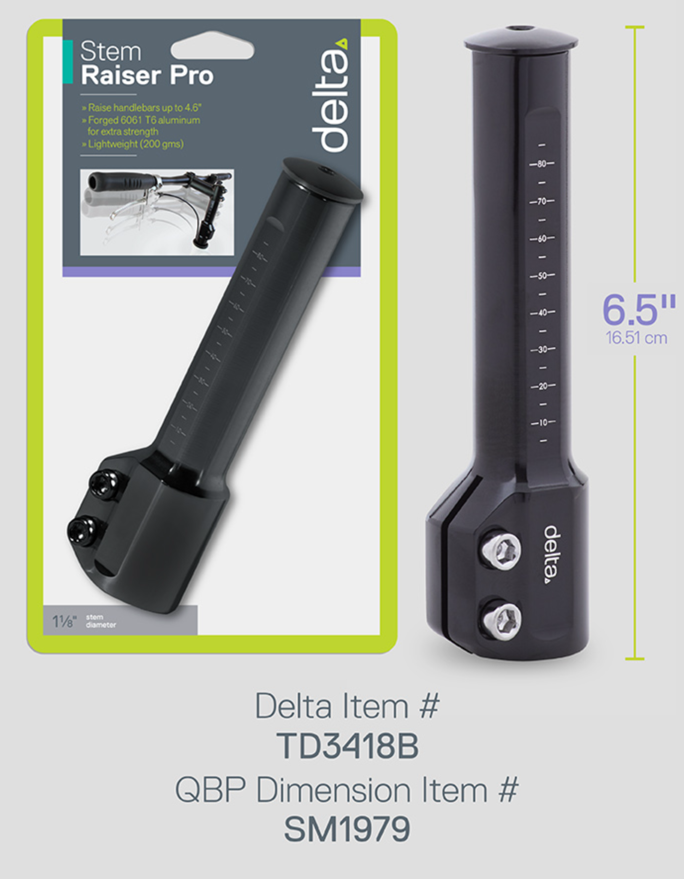

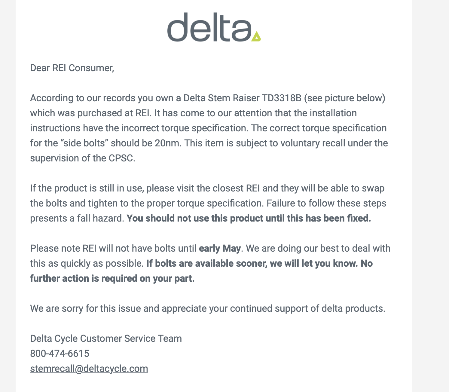

I just received this recall notice from Delta for their TD3418B and SM1979 stem risers.
I have 3 of these risers, and I've seen others mention them here as well. So far, I've had no issues with the products, but I'll replace them as a cautionary measure.

From the report, it easily can be user error.
And good thing Euroführer grew up.. but even in the one case he didn't, he still did it better than others and for the only acceptable exception.
That's what I'm thinking.
It probably just loosened up, or it wasn't torqued properly in the first place.
A stem riser is a stupid simple device. It's not like it broke, it just slipped.

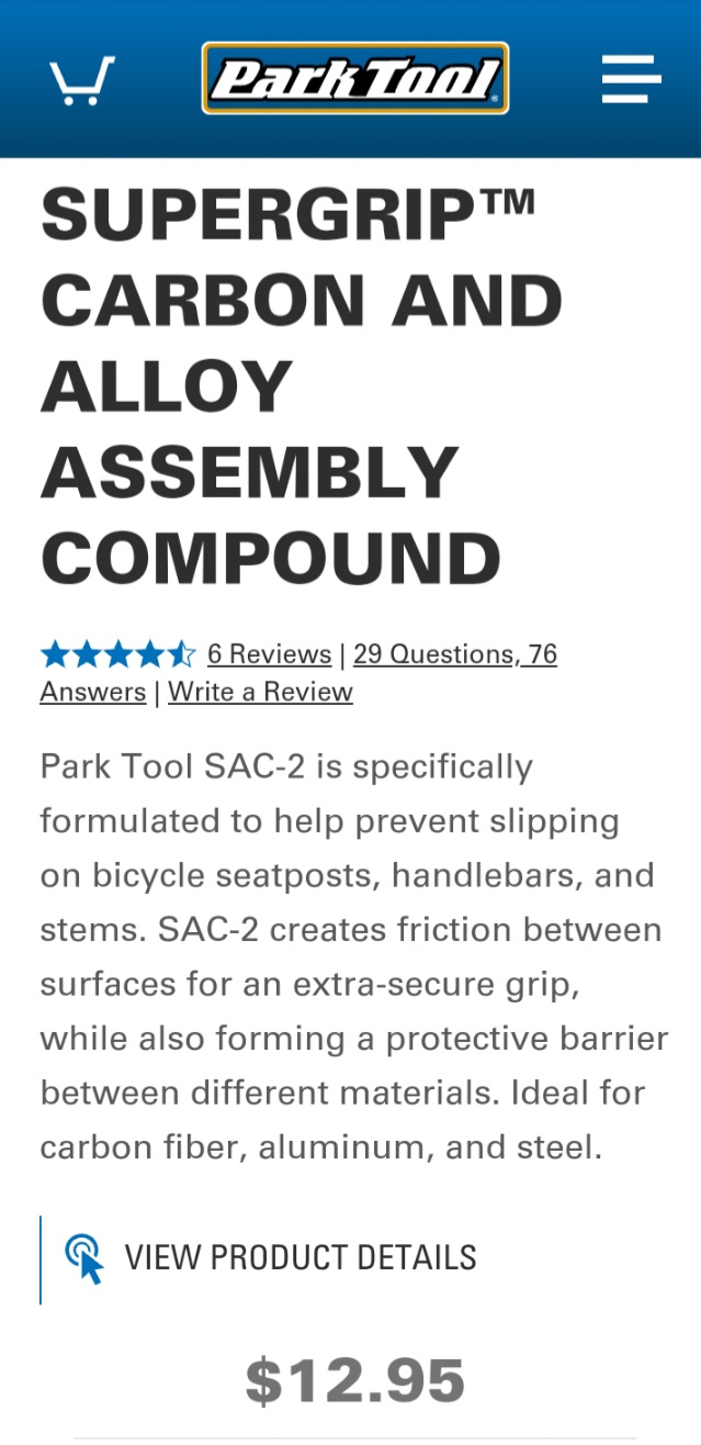

They've also got this anti-slip paste for seatposts and stems and such,..
It's a mechanical device. Unless there's some type of material failure such as the aluminum cracking or poor screw threads, there's really not much else that could go wrong. I've used risers without issue. I did occasionally check that things were tight by placing the front wheel between my legs and forcing (within reason) the handlebars left then right. I still do this any time I mess with the stem and repeat it a few times before rides the following days.
Found this... Seems the only thing wrong with the stem is that the instructions gave the incorrect torque spec. With some models they will give you new bolts.
I guess that's what happens when you buy something that isn't German engineered 🙃
"The instructions for these items do not have the correct torque specification for the installation/side bolts. The bolts should be tightened to 20nm. If the raiser is not properly tightened it can present a fall hazard."
The original torque spec was like 10 nm iirc. I actually had my handlebars come loose using this stem extender, luckily going very slow but it happened about a minute into a test ride. At that point I torqued it to taste. Just remembered this.
So yeah if that’s the reason for the recall I support it!

Delta stem risers sell for around $30-40. Generic models are $10-20. I'm using two or three of them. Jeez, recalled for loose screws.

Thinking about this again, my issue with the stem raiser was 9 months ago. 10 nm (or whatever the spec was) barely held the handlebars in place. It's crazy that this went on for so long, especially since it's such a popular item. I remember having a conversation with REI about this too and they just said to follow the torque spec. ☠️

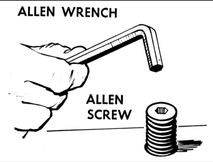

The two Rad bikes I've had, had perhaps ten inches of saddle height adjustment and no handlebar adjustment. I bought a Delta riser like that in May, 2022. If It had torque specs, I didn't see them. I would have ignored them, anyway. First, you'd need a torque wrench for an Allen bit of that size. Then you'd need the number. Then, if your threads were oily or dirty, the proper torque would give the wrong result. When you reach the limit of the elasticity of a fastener, turning it feels different. I tighten by feel to that point. If I have a torque wrench and the proper number, I may loosen the fastener with the torque wrench to see how closely I agreed with the engineers.
