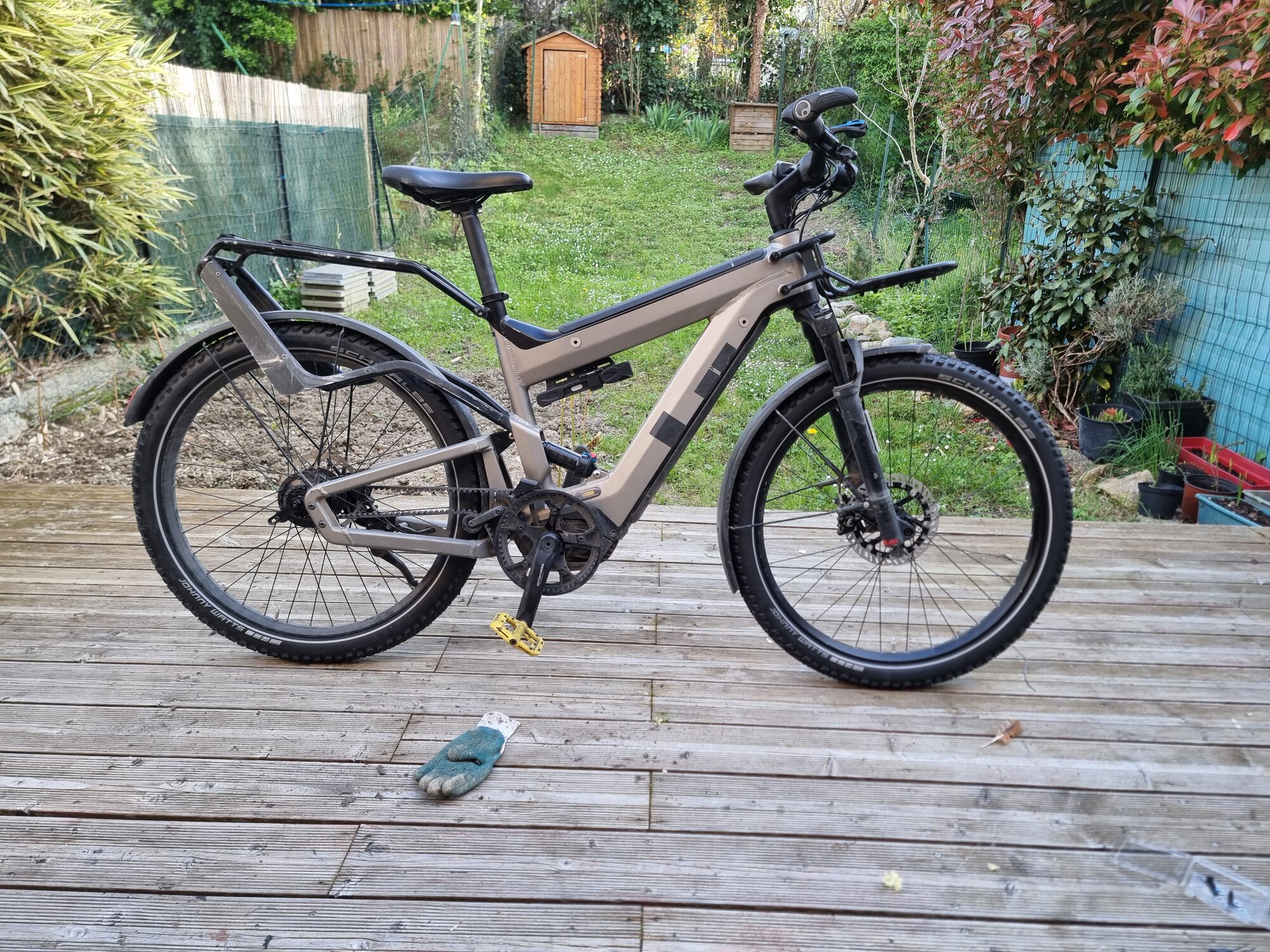

Hello. I want to upgrade my superdelite gt rohloff suspension to get tougher suspensions with more travel. Any recommendations for tough 150mm fork ?
Now i have a bomber z2 100mm fork
Do you intend to do jumps on your e-bike? Because that's the only reason to have the Trail class suspension.
NB: Replacing the fork on your e-bike for a longer travel would ruin the thoroughly designed geometry of your Superdelite. Please do not do that.
If you really need more travel on your suspension, go and get yourself a real Trail e-MTB.
The 100 mm travel is the XC class and should be good for any terrain except crazy downhill bombing on the rocks and jumps. It is not what your e-bike was designed for.
Just for reference, the Delite is available as standard 100 mm forks or factory upgrade GX to 140 mm forks. The Delite Mountain has 150 mm forks, both these versions designed by R&M, same frame as far as I'm aware. See the website.
In my experience a 130+ mm fork will give much more supple ride, especially on say corrugated roads. In addition the better the quality the fork the better the ride and although total overkill, the Rockshox Pike is lovely to ride on.
