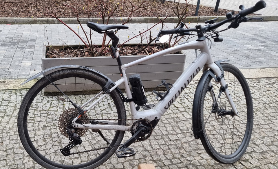

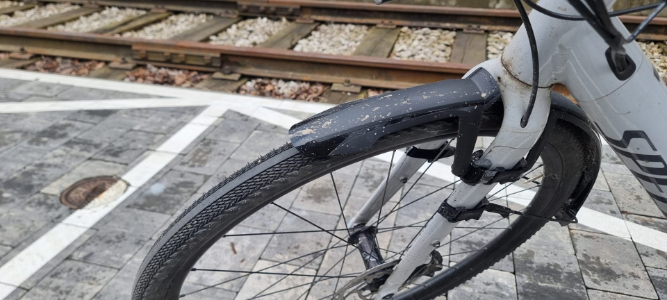

SKS Germany is an ingenious brand that can conjure up fenders/mudguards for any type of bike from pieces of plastic, wire, rubber, and velcro.
I want to tell you about the product that would be appropriate for your Vado SL or Creo as long as the tyre width is up to 42 mm: SKS Speedrockers. The product consists of three plastic pieces:
  • Rear fender with a telescopic extension
  • Front fender
  • Front fender spoiler.
It comes with four rubber and one velcro straps for the rear and four velcro straps for the front. It also comes with ten rubber pieces to protect your bike frame against scratching. Necessary to mention the fenders are fully adjustable. The front fender involves a safety feature: should a twig get between a fender and the tyre, the supporting wires will snap from their sockets and unblock your wheel (the wires can be re-attached later).
The installation is extremely simple. The mudguards can be easily removed for dry weather or for washing. As long as you have tensioned the rubber and velcro straps, the mudguards stay on your bike solidly. And they do work in the mud or a violent rainfall with deep puddles! (Actually, Specialized could learn from SKS how to make Vado SL fenders properly... Why does the brand limit the tyre width at 38 mm for the EQ version remains a mystery for me.)
SKS Speedrockers even look sporty!

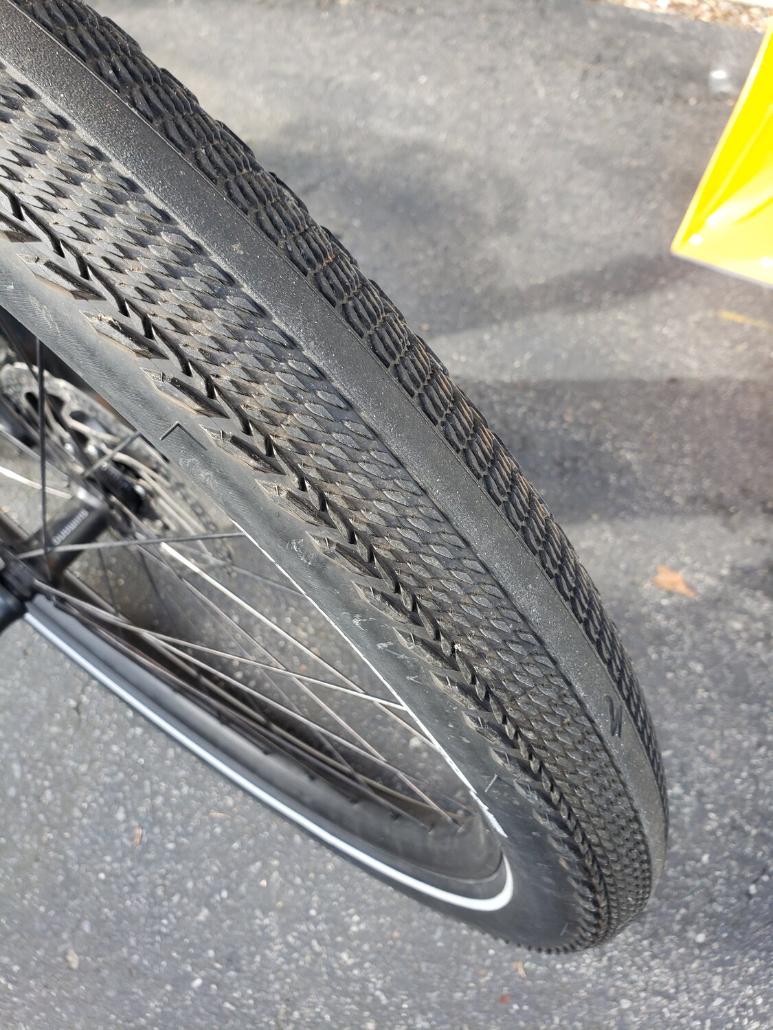

Apologies Stefan for the off topic question but can you tell me what tires you are running with the smooth center tread?

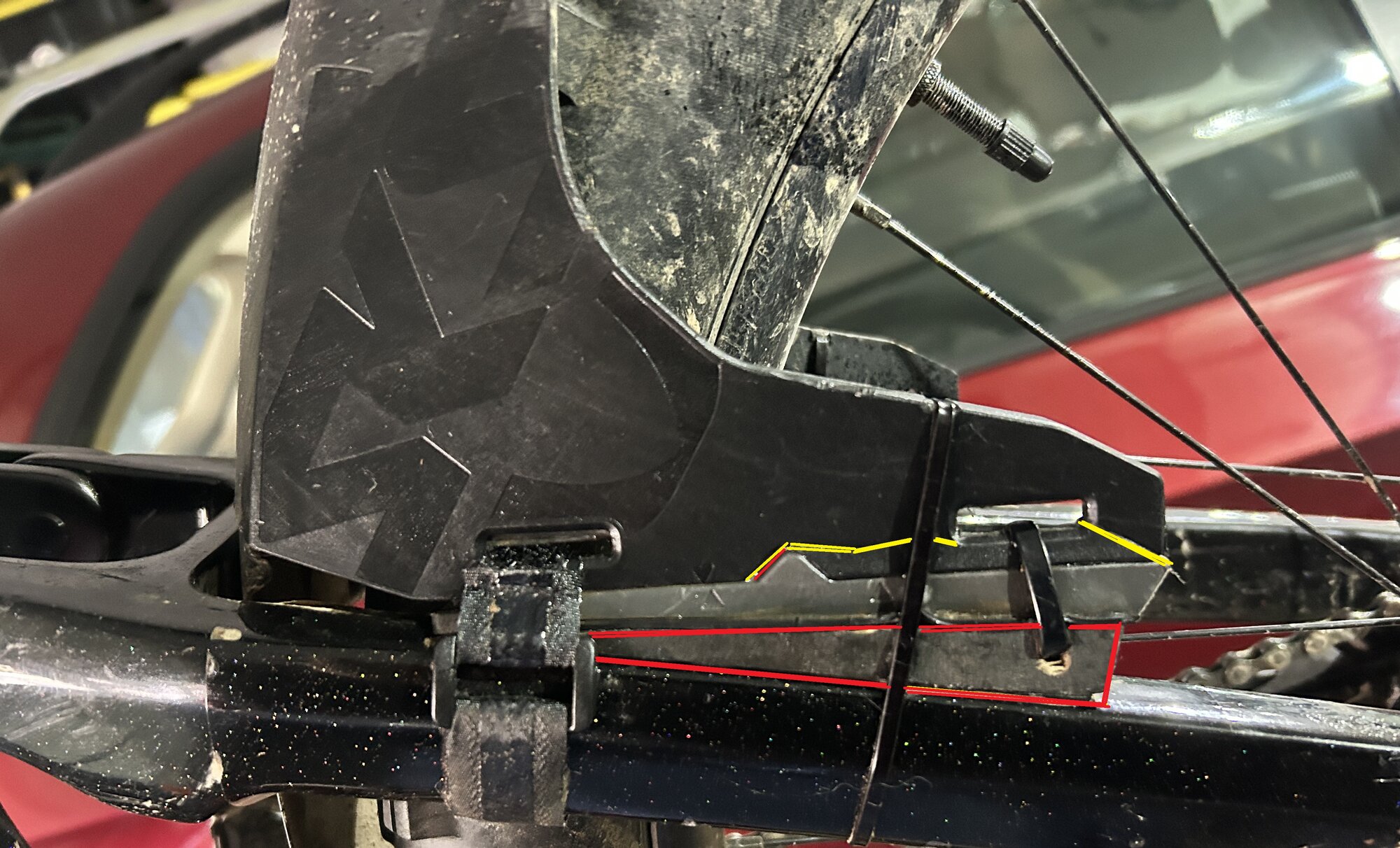

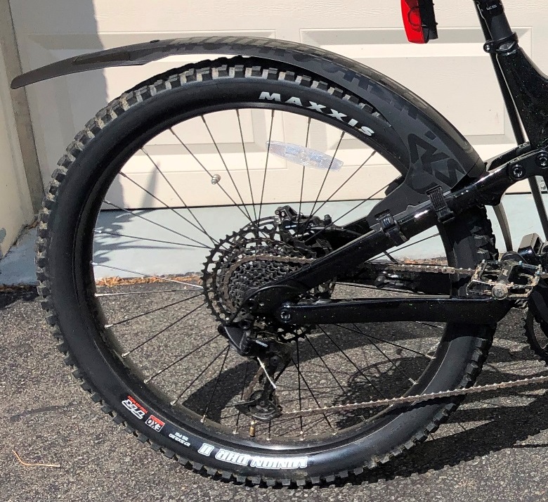

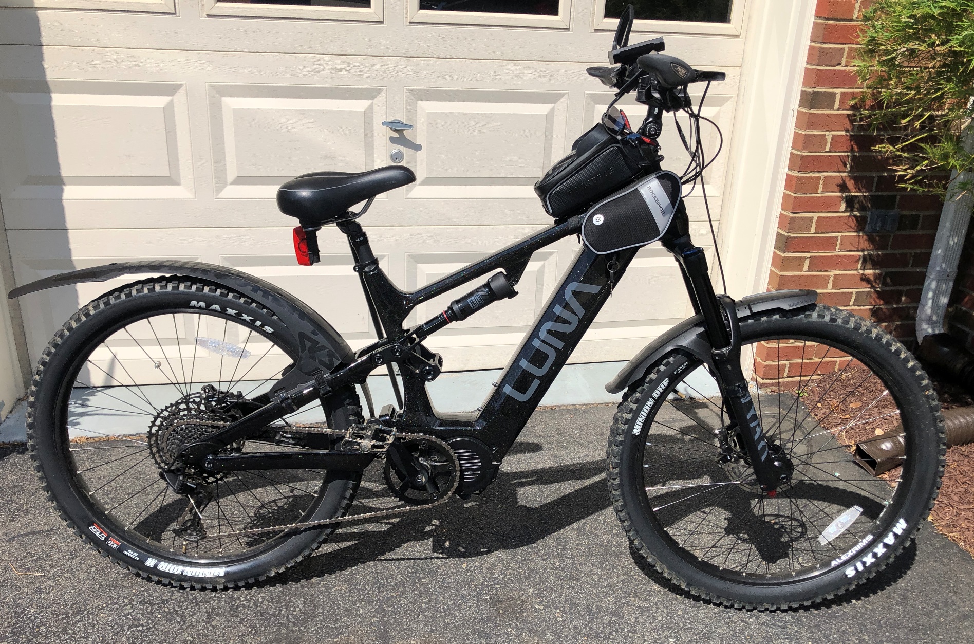

Yes, I concur Stefan. I've tried several fender products and nothing comes close to the SKS Fenders. I've had these fenders for almost two years and ride this bike really hard off road. They install easily, and stay put.
However, if you ride really, really hard, see below.
After a 2-3 months of hard riding I had to add a wooden triangular (red outline) shim beneath the OEM plastic rail mount. The OEM design had the tail end of the fender too close to the rear tire. Under extreme rear end bounce, the rear fender end would slap the tire very loudly, epecially if I added the extra weight of the rear end extension (installed above).
Then after about a year of hard riding, the rear mount cracked (yellow line), so I added the zip ties to solve that problem.
All in all, these are the best looking and performing fenders I've found. For non-mtb/enduro riders, no modifications like above will be needed.

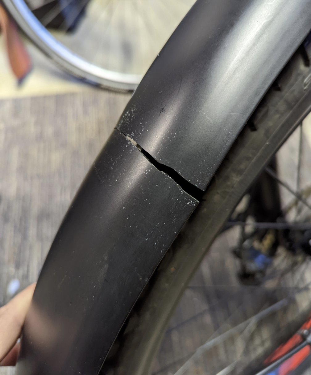

I've been happy with my SKS oem fenders. They do become more brittle in sub-freezing temperatures.
This happened 2 winters ago on the first week of cold morning commutes. Held it together with gaffer's tape last winter. This year when the tape failed on the first cold day, I just finished the job and cut the fender shorter. Still does what I need it to
View attachment 173000View attachment 173001
~Tom
Tom, an interesting story! These, however, are not Speedrockers?

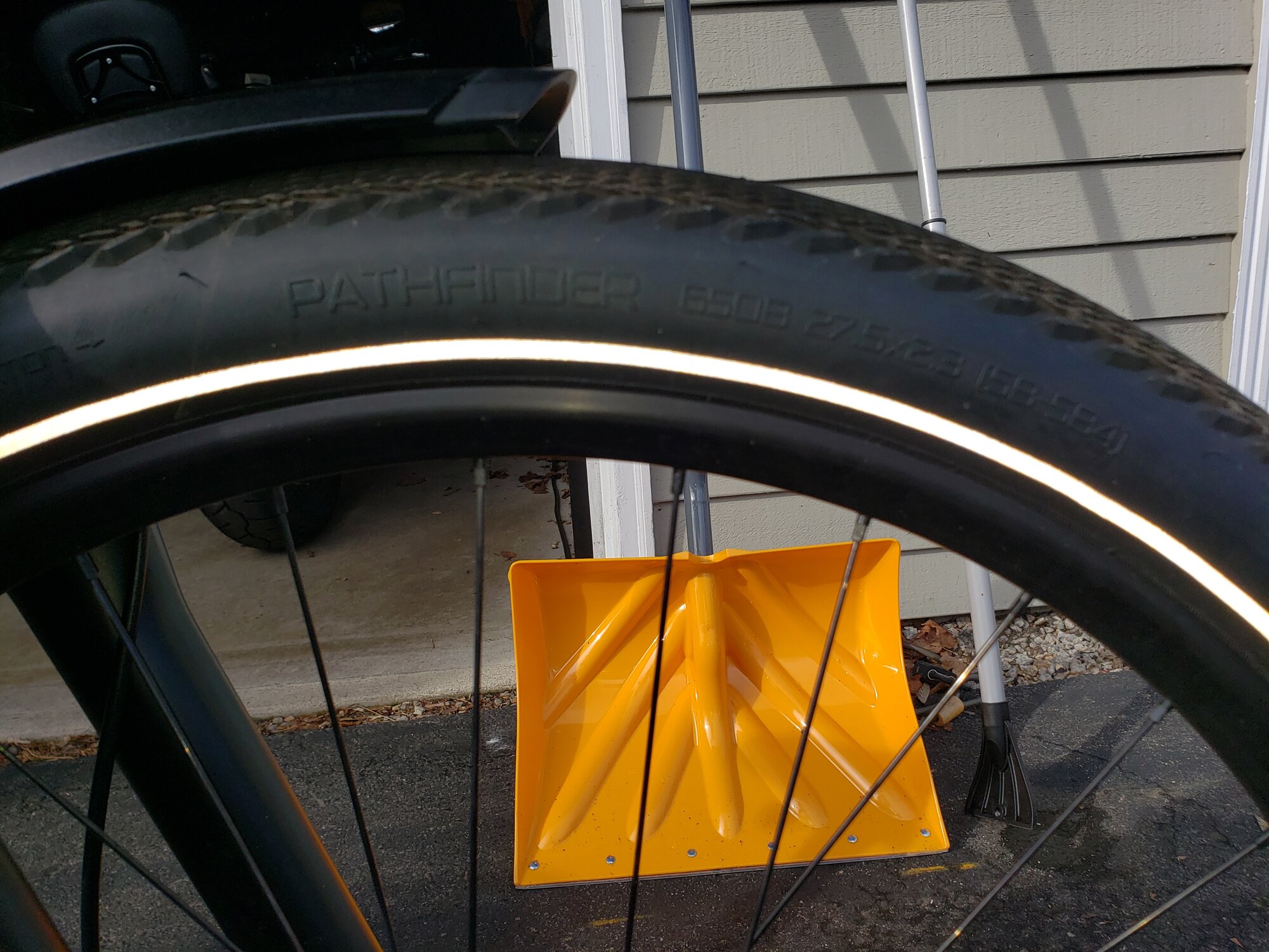

A big disappointment this Autumn. The rear SKS Speedrocker and a 42 mm Specialized Tracer Pro tyre (which has aggressive tread) turned out too be too close to each other, and the tyre would rub the fender :(
As the wheels are tubeless, I do not intend to replace the tyres and would probably go with an under saddle AssSaver this Fall...
P.S. It is an SKS S-Guard splash guard, eventually.
