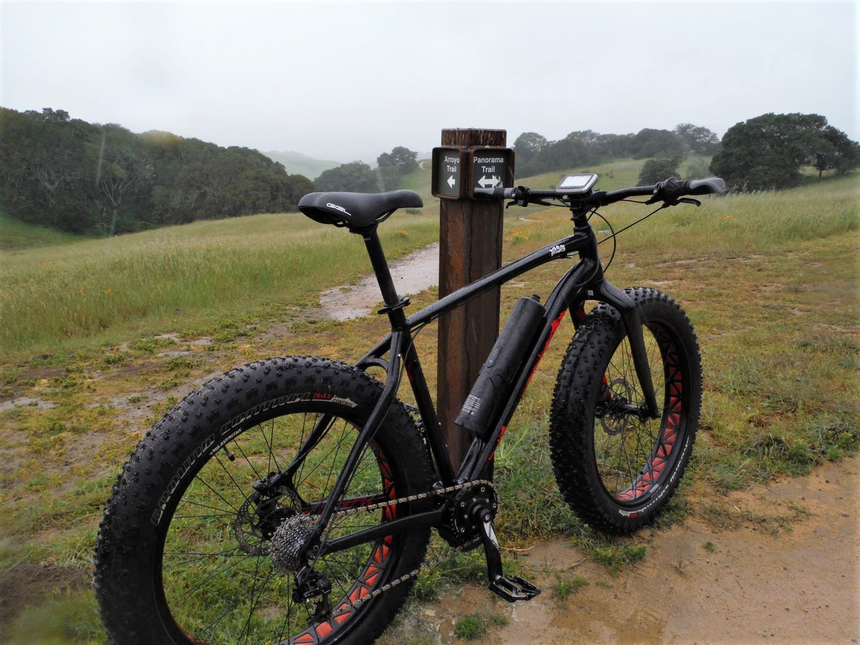

You're right antboy on my riding style. I'm pretty careful, both to protect my photo gear and my mid-50s body that doesn't quite bounce back as quickly as it once did ;) I'm moving at slow speeds (since I'm always scanning for wildlife), and for questionable sections I'm off the bike and walking it which I really don't mind doing...getting off the saddle a bit. My power needs are mainly for relatively short (and not crazy grades either...maybe 6-7% tops) runs combined with the weight of me + bike + gear. As far as stress on the bike/components, that's mostly from unexpected "drops" from weed/brush-hidden gopher holes etc., a feeling like when you hit an unexpected pothole while driving or a mogul skiing.
I'm currently running an Onyx rear hub; I splurged for a custom rear wheel build after a few months running a standard "clicking"/pawl freewheeling rear hub. Great setup! And my derailleur setup has worked well with the stress my BBSHD has put on it (I run a 40T single ring up front and very durable Shimano CS-M8000 11-46 cassette), it's only the occasional issues with derailleur-clogging and replacing hangers that had me thinking of derailleur alternatives. I'm attaching a picture of my current beast.
Going with a single-speed is another option, something available on some of the bikes marketed as "hunting ebikes." I'm not doing much hunting, but my needs/use case is pretty similar to some of these backcountry hunters. That would eliminate both the derailleur or IGH concerns. I've never ridden one so I have no idea what the riding experience is like. Apparently they climb well and handle loads great, but it looks like the top speed might be limited to 15mph. That would make for somewhat slower-going for trips where I have gravel road sections before/after my main backcountry riding, but would probably not be a deal-breaker for someone like me. And having to peddle it out if the batt or motor gives up would be no fun... Single-speeds for all-terrain/hunting seem to be pretty rare right now, and assuming there's a good reason for that, that might be a risky choice.

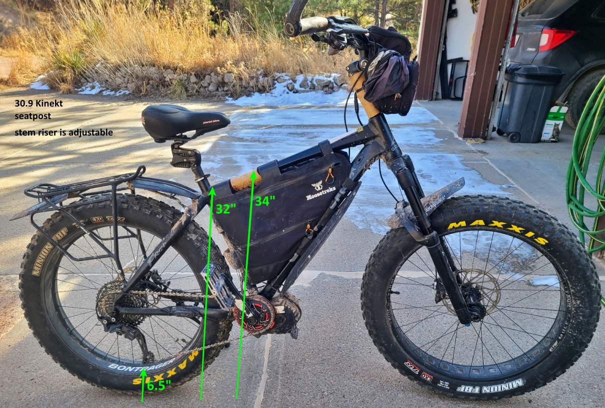

If you do a mid-drive, you will want gears. That is the main advantage because the motor is then shiftable. You could do a 500 watt motor with a Shimano 5-speed. Here is a Specialized Fatboy with a torque sensor motor. It is 750w and we went with a 9 speed for durability. The chain can be thicker than 10,11,12.

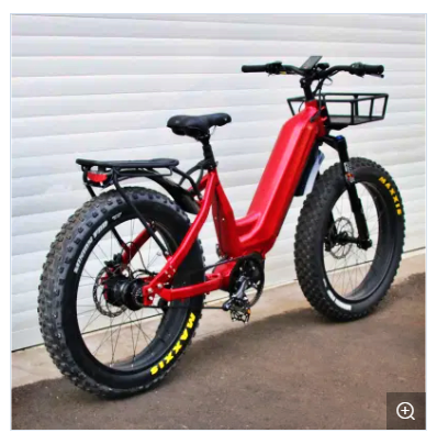

Well I’ve given this some more thought, as well as tried to research/inform myself more about what’s out there, and I’ve decided that all things considered, the advantages of a Rohloff setup outweigh the disadvantages. And importantly, after looking into the gearing issue in more detail, it seems there’s a good chance I can do most of my riding (keeping in mind the electric assist factor obviously) in the higher Rohloff gears (8 and above), which several people report as having much lower noise levels than gears 1-7.
So then the question becomes finding the best option for a step-through fat ebike with Rohloff and a belt drive. The closest I’ve found is this (I've included a pic since there are a couple of different models/iterations shown in the listing). Poking around and comparing pics/specs, I see that this model appears to be one imported by a couple of small US ebike sellers (mainly aimed at the hunting ebike market) who are charging ~ $2000 more for just repainting/throwing on some decals and perhaps changing out the headset; otherwise the specs and components appear to be identical.
I believe this bike has a 60T chainring + 34T cog combination. I haven’t found much info on whether that is a recommended combination for the Bafang Ultra being used for the off-road fat biking, etc. I'm doing. On my current fat ebike, I’m running a BBSHD + 40T Lekkie chainring + Sunrace CSMS8 11-46 cassette. That setup actually gives me more high and low than I really need; 95% of the time I’m between 32T and 15T using the electric motor assist levels and throttle. Using some online gear calculators and charting that out against the Rohloff + 60T chainring + 26T cog, it looks like a corresponding range (in gear inches) would be 6-12 or so on the Rohloff. This makes me think I'd be able to to stay 8 or above most of the time and avoid the worst of the noise--my only real concern with the Rohloff--but get all those other Rohloff benefits/advantages.
Thoughts?
Only has 265% range eg 11
Only has 263% gear range compared to 11-46t cassette which 418% and only rated for 65nm of torque. Can't lower the overall range by using large rear sprocket either as this will exceed make torque rating. These IGHs were designed for commuter bikes not offroading.
Its either Rohloff or derailleur anything is likely to break.
