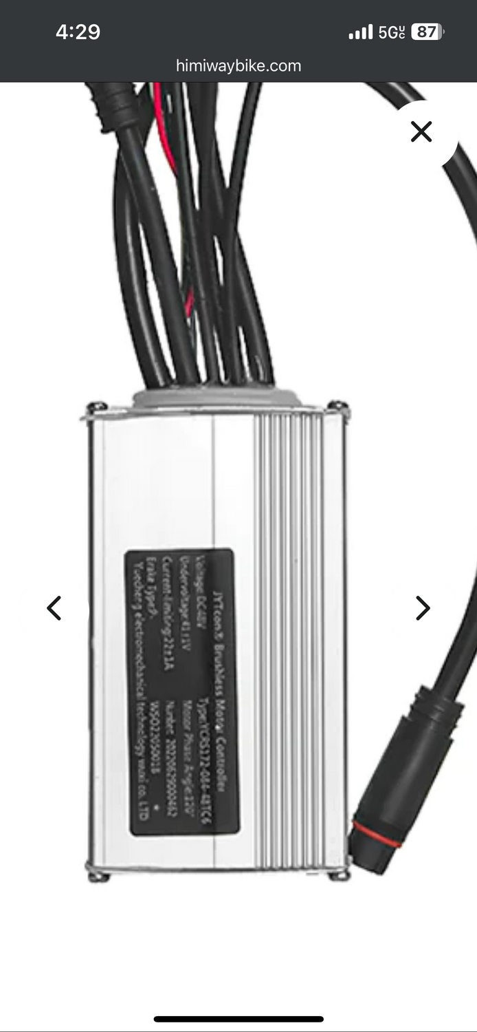

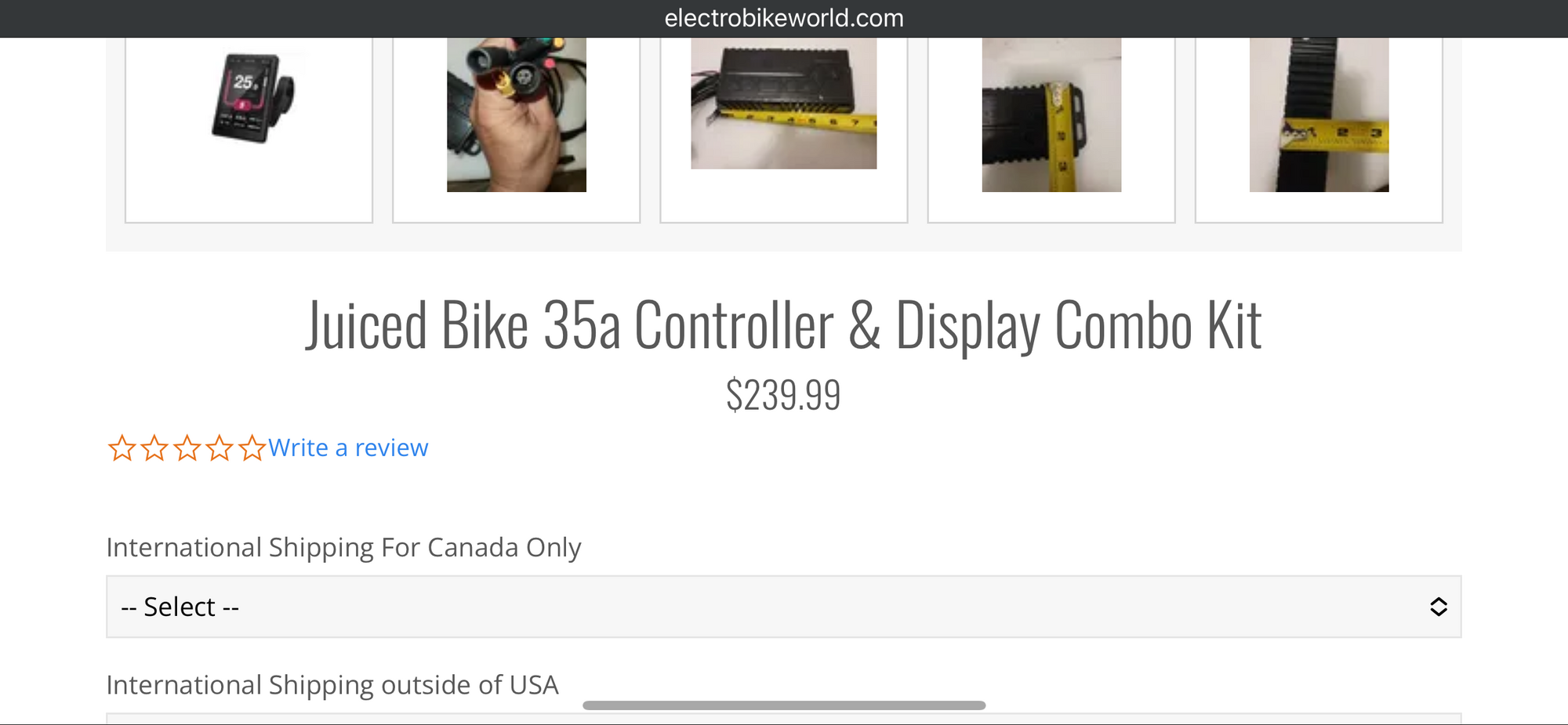

All I know is the controller is rated for 22 amps +\- 1A, but the display goes up to 25. Is anybody in here familiar with error code 24? Mine has 3000+ miles before my first error code. As for the customer service department, do not believe anything that they say. I don’t wanna throw shade at them, but they both face lied to me about upgrading the controller and display. ( see second pic)
