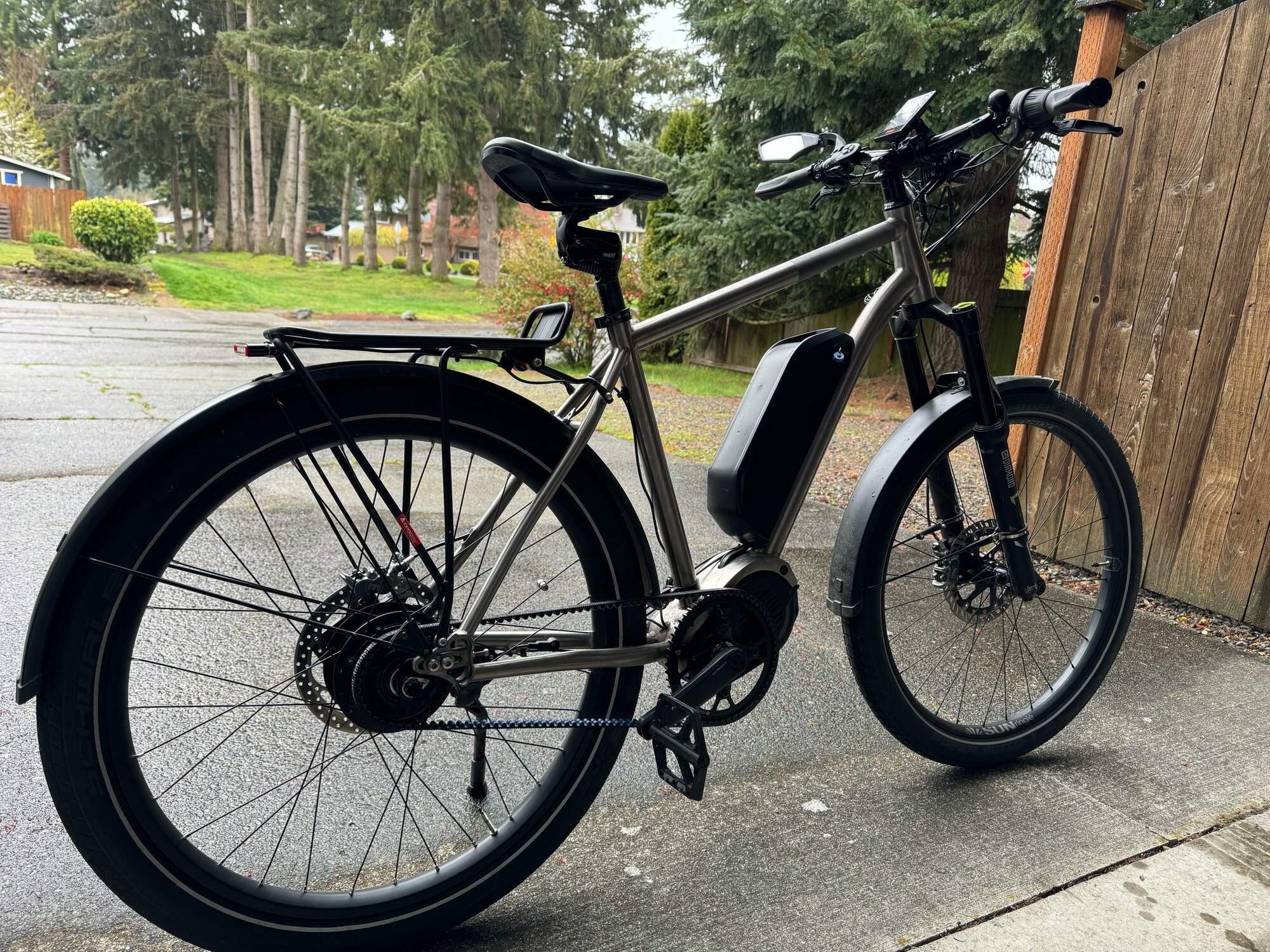

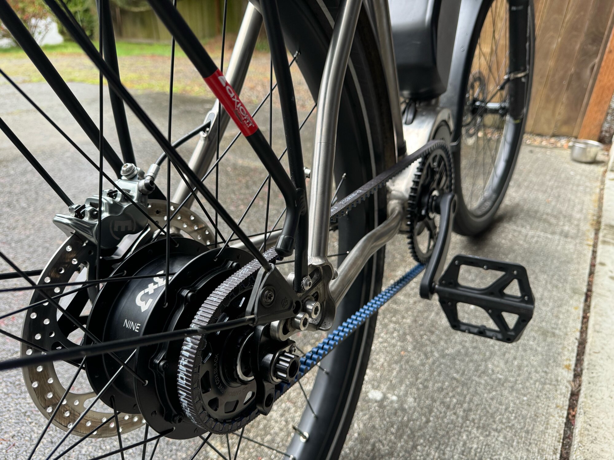

I would not recommend a Rohloff with the bafang ultra, the IGH is not rated to handle the NM of torque. I have now installed the 3x3 Nine IGH which is rated at 250 NM torque which will handle the 165 NM of the Bafang Ultra. Remember you need to add the NM of torque of the motor to the NM you pedal. The 3x3 Nine also requires no maintenance vs the Rohloff that requires annual oil changes.
