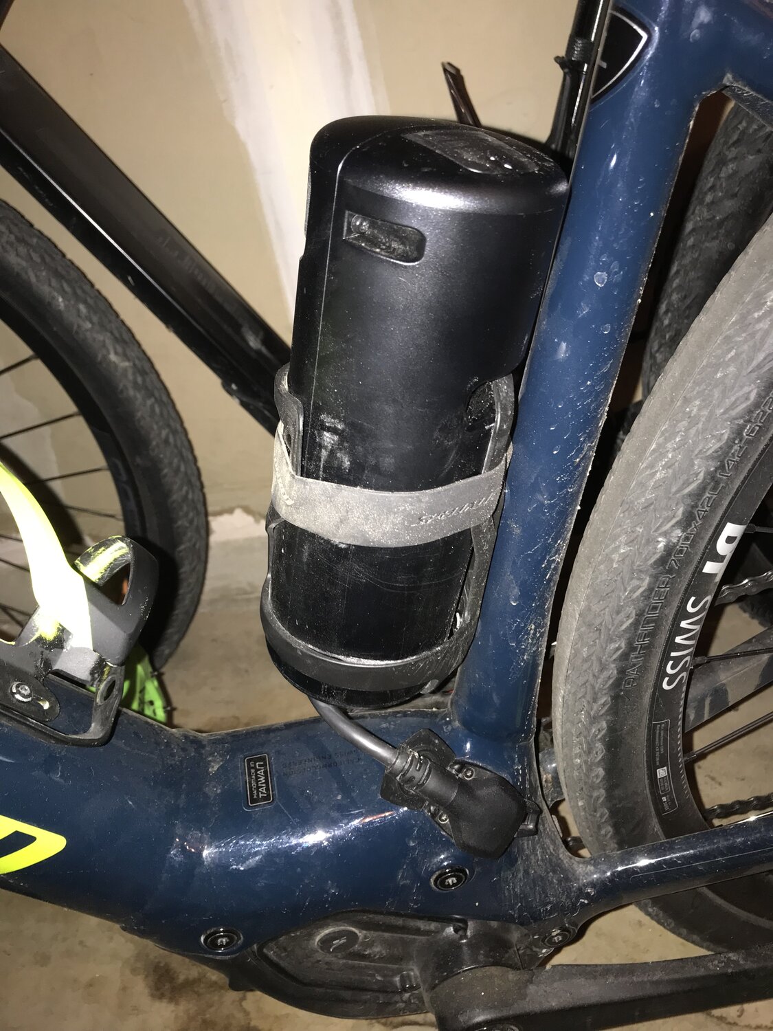

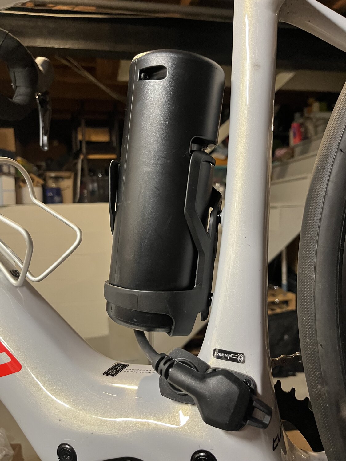

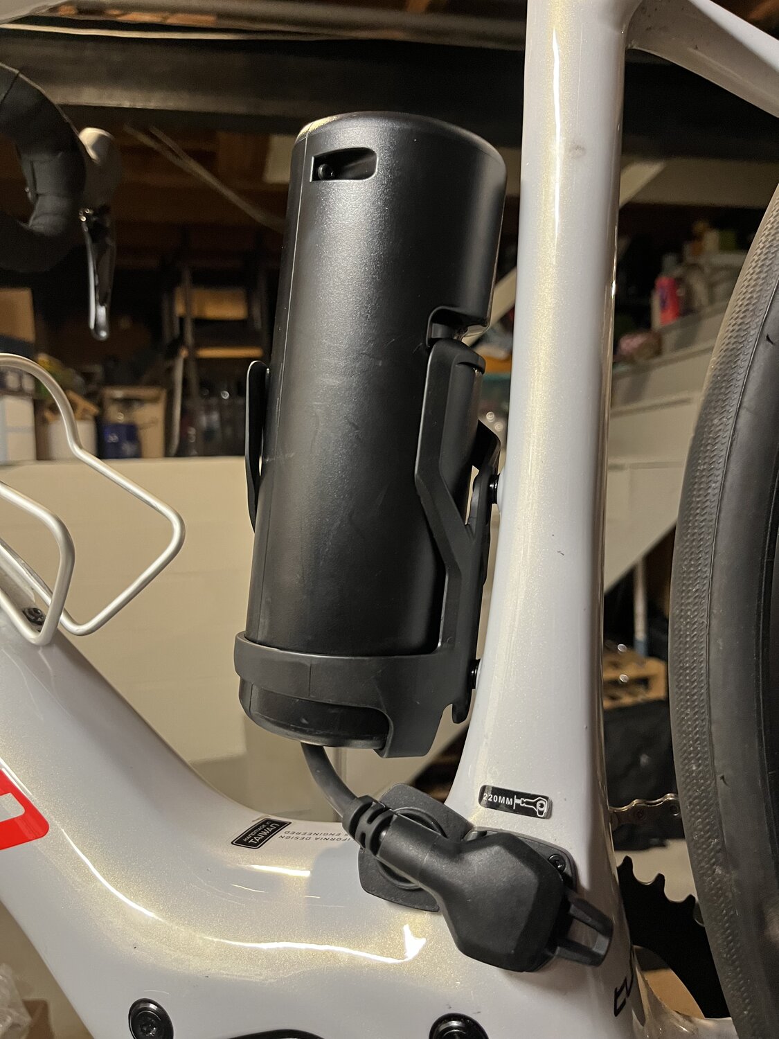

I have a new Range Extender battery and cable. Haven't used it yet but testing out how it fits on the bike. Am I doing this correctly? Reason I ask is because the cable seems extremely taut, as if it is almost a few mm too short. Is there another way to have the battery sit in the cage that doesn't put so much strain on the cable and connections? The diagram in the user manual makes it look like there is quite a bit more slack.

I am using the Zee cage that came with the Range Extender. If it is installed on the down tube, it opens on the drive side. On the seat tube, it opens on the non-drive side. The plug is just really difficult to get into the charge port when the battery is in the cage. Maybe it will stretch out over use?
Yes, I am using the 220 mm cable. I don't think Specialized makes one shorter than that. Also the user manual says the rubber band is intended to hold the battery in the cage, not necessarily to hold the plug in the battery. The diagram shows it positioned around the center of the battery.
I had never had any issues with plugging the cable into the frame port but there never was any substantial slack in the cable either.

Thanks... I just checked to make sure I didn't actually have the 160 mm cable! But it has "220 mm" printed on the inside.

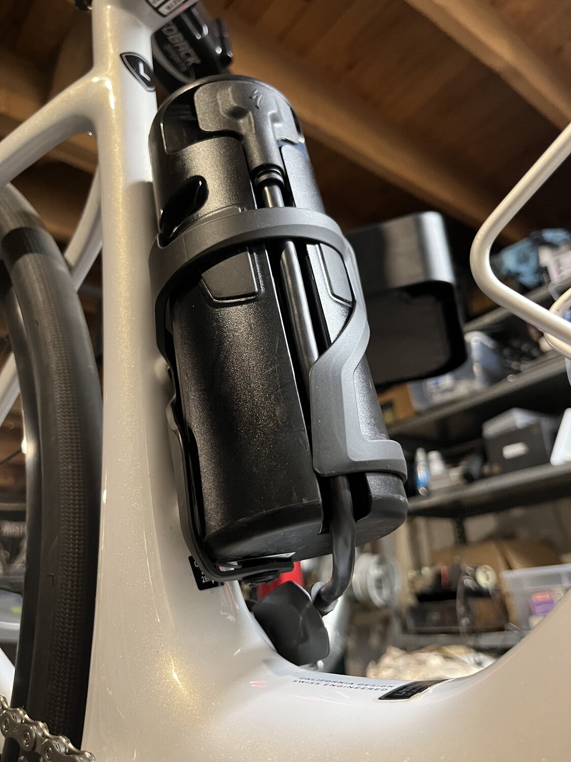

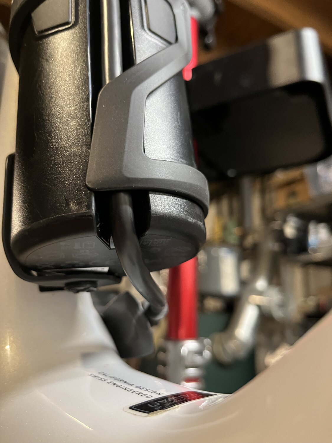

The difficulty is getting the plug inserted into the charge port. The cable needs to have enough slack to allow the plug to insert straight into the port. I am finding that with the battery in the cage and the notch lined up with the top of the cage, the plug has to go in on an angle due to the lack of length, which seems to put unnecessary stress on the plug, the cable and the port.
y4mUdbA2Um0TlQwqtlSzOLpTdexsNxIb-iiAyKqxhvgTuufIBV9BtpfPvrpnMPlif9WNvNA9uHLKLzT-frHav_0tPeSuoDdevTmY3plBfOPhz8SNIQ0Jvq4j2vEUa4KAXAnXfBFd3MW48pTgUF3dUn-NXDt-u2DpUu9stk7iOxivJyI0J7lXzIAYS1onkpx1Wlg
If I rotate the battery in the cage to have the shortest possible distance to the charging port, I then have enough length that I can get the plug lined up to go in straight. Then rotate the battery back to fit the notch with the top of the cage.
It just seems if the cable was only a few mm longer, it wouldn't require so much pulling to get it to plug in smoother.

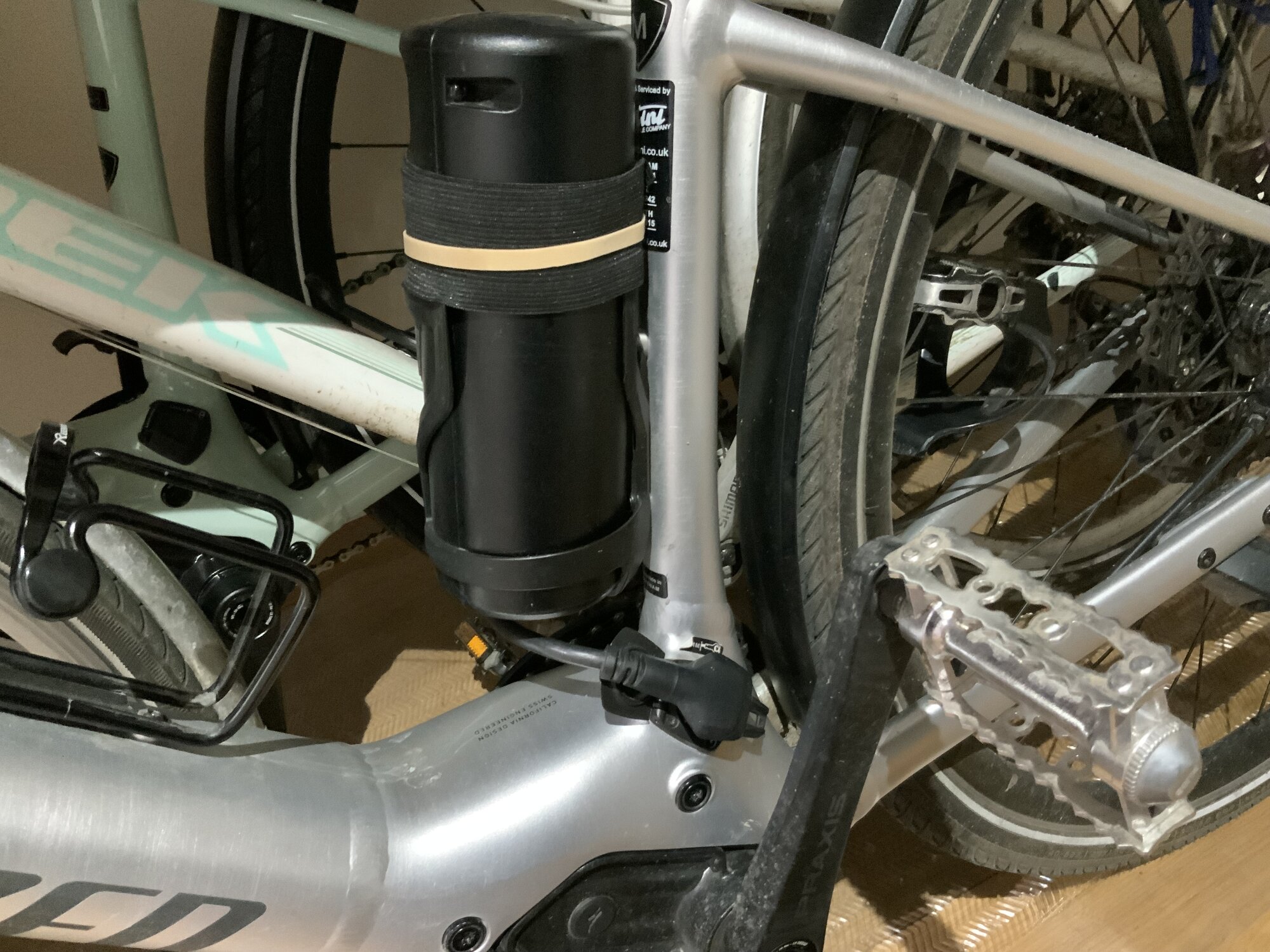

The setup on my Creo is the same as yours - just a lot dirtier at the moment! The cable isn’t stretched, bit it is pretty snug. I do sort of have to tip it into the connector. I only bought it a week or so ago, so it’s still quite new.

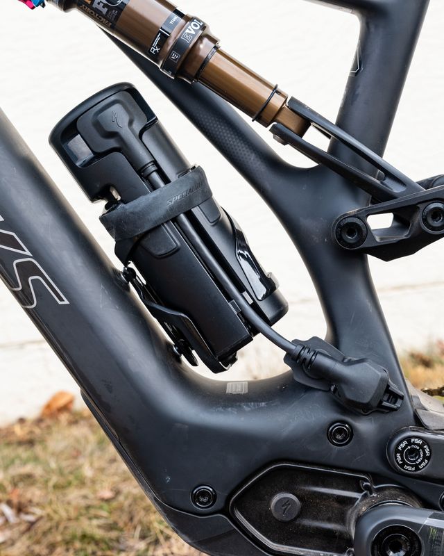

Like this is what makes sense to me (even though this photo is for a mt. bike):
View attachment 153044View attachment 153046View attachment 153047

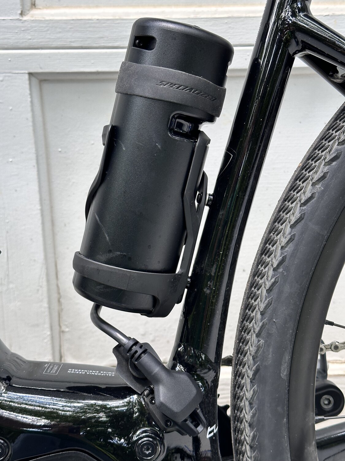

I think that looks correct. Here’s a picture of mine, there is very little, if any, slack.

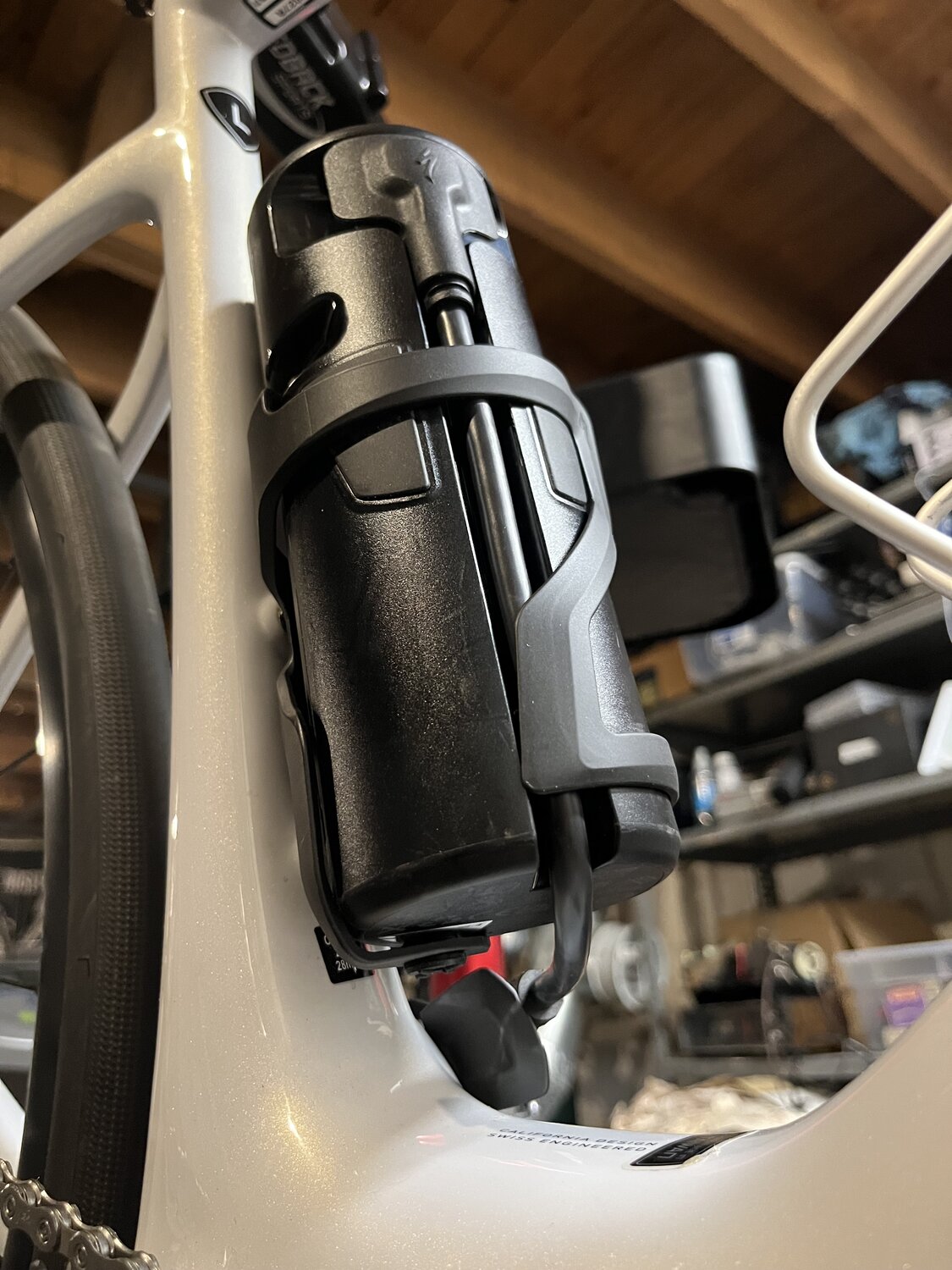

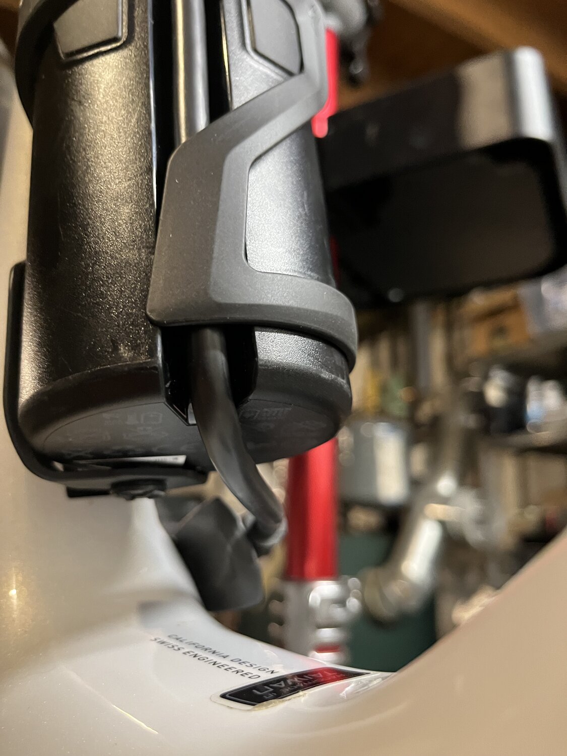

Good thought, but the battery has a notch on only one side. That notch lines up with the top section of the bottle cage, which holds the battery in place.
As designed:
y4myFtx2wIGK3AZqp49hWEkdSnwAU9BsbJ_on6b9dNybbFuuQFnprOswiXWVSzhM3uBrBEvv2upYn79gxc4SUw4yjNMfHjrERuw4BKfAFsz_z0ZOeCm6euRJdBjmfhXa6kwmt6iXS6_EEkWUJIKy6s-UwIZsYqZ5RTYYgMbaiRPWt3xl3IBKg8igS8XBKAIVBB_
Rotated 180. This doesn't really work:
y4mGDC3QOFvlh-Nh4w8Gca2Gv_h08s_KLStE8dpmRXCr9FBlIqKUVZSIGOzo78sRZsndm2DQYHgGCO61hF1713oXaJICBBDIMh9vd0byeltIIfNYqqW1ezS3-o9W1Gzy6jWvsV1v-ypnPJmjHBouEmNtXSgUSmHugxiM2_RWB_PEfZ-tCdHyfkwjKGFN-y3nf9K
One thing I noticed in your picture is that, on the aluminum frame, the charging port looks like it is positioned slightly differently than on the carbon frame. Mine looks to be just slightly lower and more on a lower angle, which might be the difference in the amount of slack needed to easily insert the plug...

ahhhh. good point on that Specialized bottle cage that makes it a big hassle to plug in the battery. That's why I could not understand the issue. I use a regular, fancy, normal bike, bottle cage and being able to rotate the battery makes it all work really easily. I do use the big rubber band to ensure the battery does not fly out under challenging conditions. Try a normal, quality, non-proprietary cage...and enjoy the ride and...the battery.
You will notice that the photo of the bottle cage above that I posted showing the mountain bike has the cage on the down tube which I think rotates the cage in the direction that makes sense but if you mount on the seat tube that turns it 180 degrees and causes issues with slack.

Burning Matches, just to add to the other replies, on my Creo Expert (so carbon frame) the RE battery and holder is exactly seated the same as yours. I too always find the cable and plug fairly snug, but I presume it has been designed that way. And I agree with you that rotating the battery is not possible in the zee cage. I note in your photos that the rubber band is not there, as others have said it is a good idea to always use that.

Thanks for confirming. Yeah, I have the rubber band and will use it when I take the bike out. Just didn't have it on when I was monkeying around with the battery trying to figure out how it should be installed.

To dispel the suggestion of carbon/aluminum frame differences, my RE cable is just fine on my E5. Sure it's not wallowing in slack, but it fits just fine.
