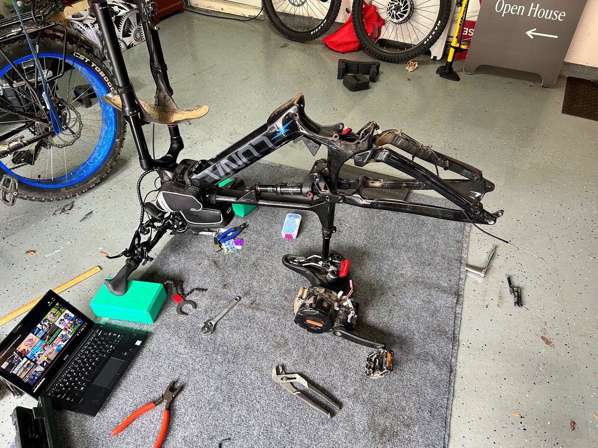

  • Removed Bafang Ultra motor, opened and checked the grease level and condition.
The twist shifter is pretty easy to install. Rohloff has a Youtube video and simple written instructions. Piece of cake.
I decided to route my cables inside the down tube. I removed the battery locking mechanism, brackets that secured the existing cables in the downtube, removed the Bafang motor, and routed the cables behind the battery, behind the motor, and out the rear suspension opening in the frame. The shifter cables will run neatly under the left hand chainstay using existing zip tie anchors.
Checked Motor Grease while I'm here:
Back in July 22', after about 600 miles on my bike, I decided to check the factory grease. I found it to be paltry at best. The motor was a considerably noisier than my existing Luna/Bafang BBSHD which seems to run nearly silent. In July 22 I installed Corn Head grease. See my thread here Corn Head Grease Install. Today, opened the motor after 2,000 more miles and I was pleased, grease everywhere. The system is well lubed, and very quiet. I slathered a few more tablespoons of grease and closed the motor.

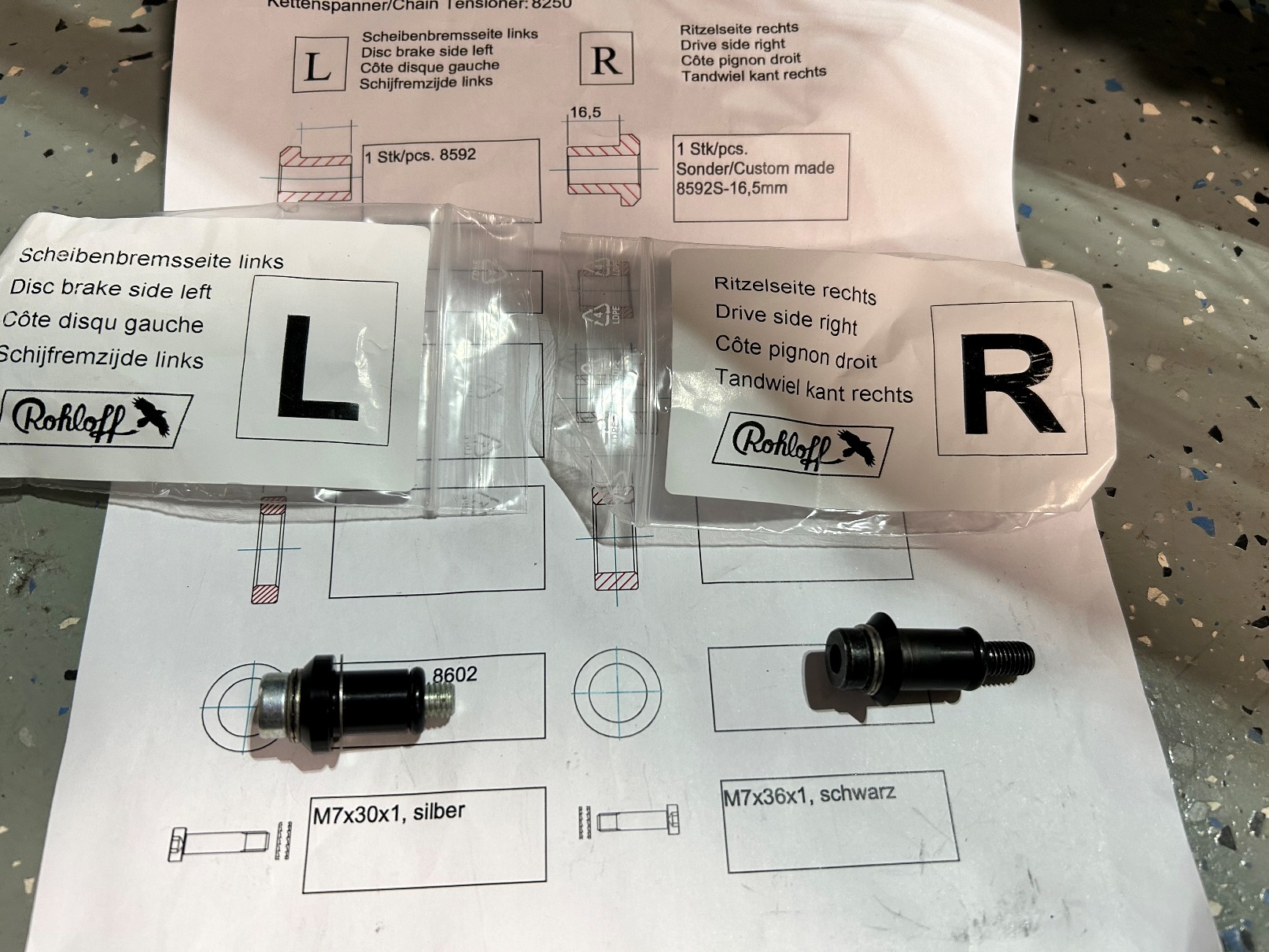

Except there is a glitch:
The left hand axle adapter is OK. The right hand axle adapter is OK, but either Rohloff or the dealer forgot to include the right hand (sprocket side) Reduction Sleeve below. The sleeve is Yellow in the diagram, but it comes in black. I emailed Rohloff and the dealer. I'll call them in the morning. Hopefully it won't take too long to get one...

4/24/23 - Machined my own adapter while I wait for Rohloff.
I figure that Rohloff and the dealer will take at least a week to get me the correct right side dropout reduction sleeve (above Yellow). I decided I cannot wait. The right hand drop out of the Luna Z1 has a threaded insert that slides into the dropout and screws into the derailleur hanger on the opposite side of the dropout. It's threaded on the inside too, to anchor the thru-axle. I took the insert to a machine shop and they drilled out the inner threads to a 12mm smooth bore, which is the diameter of the Rohloff supplied right hand axle adapter above. Screwed it back into the dropout, and slid the Rohloff axle adapter into the fitting. It fits perfectly. - Problem solved. - The Machine shop did not charge me anything. Real nice guys.
I cut slots in the top so I could screw it in to the dropout/derailleur hanger, after boring it out to 12 mm diameter.
It fits like a glove. Actually, because it's threaded, and it screws into the derailleur hanger, it's more secure than the Rohloff reduction sleeve above which simply slides into the dropout.

5/20/23 - Well, after 26 days, the missing adapter sleeve for the right hand drop out finally arrived. I will store it in my toolbox for who knows what. They even sent me a Rohloff sticker for my troubles! My adapter (4/23 above) that I had custom machined is superior because it threads into the derailleur hanger and is theoretically more secure. Thank the Lord I was able to "MacGyver" the fix. I would have been pretty angry about the delay in getting the part. To be fair, I also did not press the dealer or Rohloff for speed because I was already up and running and I let them know that.

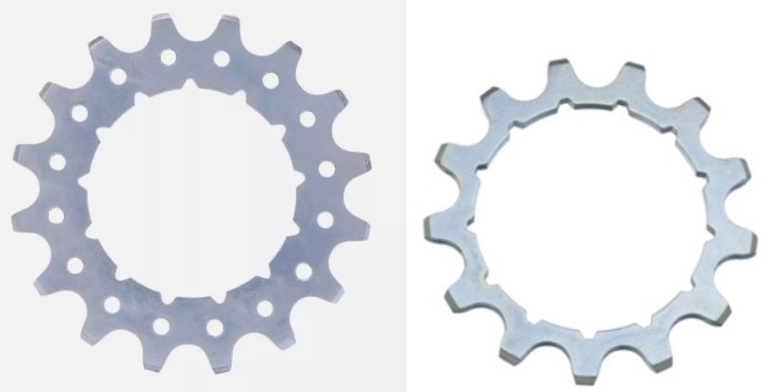

A few months ago I replaced the 16T rear cog with a 13T rear cog to achieve a more desired gear ratio. The change was nice, more top with some still serious climbing ability.
After a few months of riding, the 13T cog broke in two. I surmise that becuase it is made of much less steel than the 16T cog, it could not handle the continued stress of the Bafang Ultra. I'm going to move to a 50T chainring intead of my 40T chainring.
