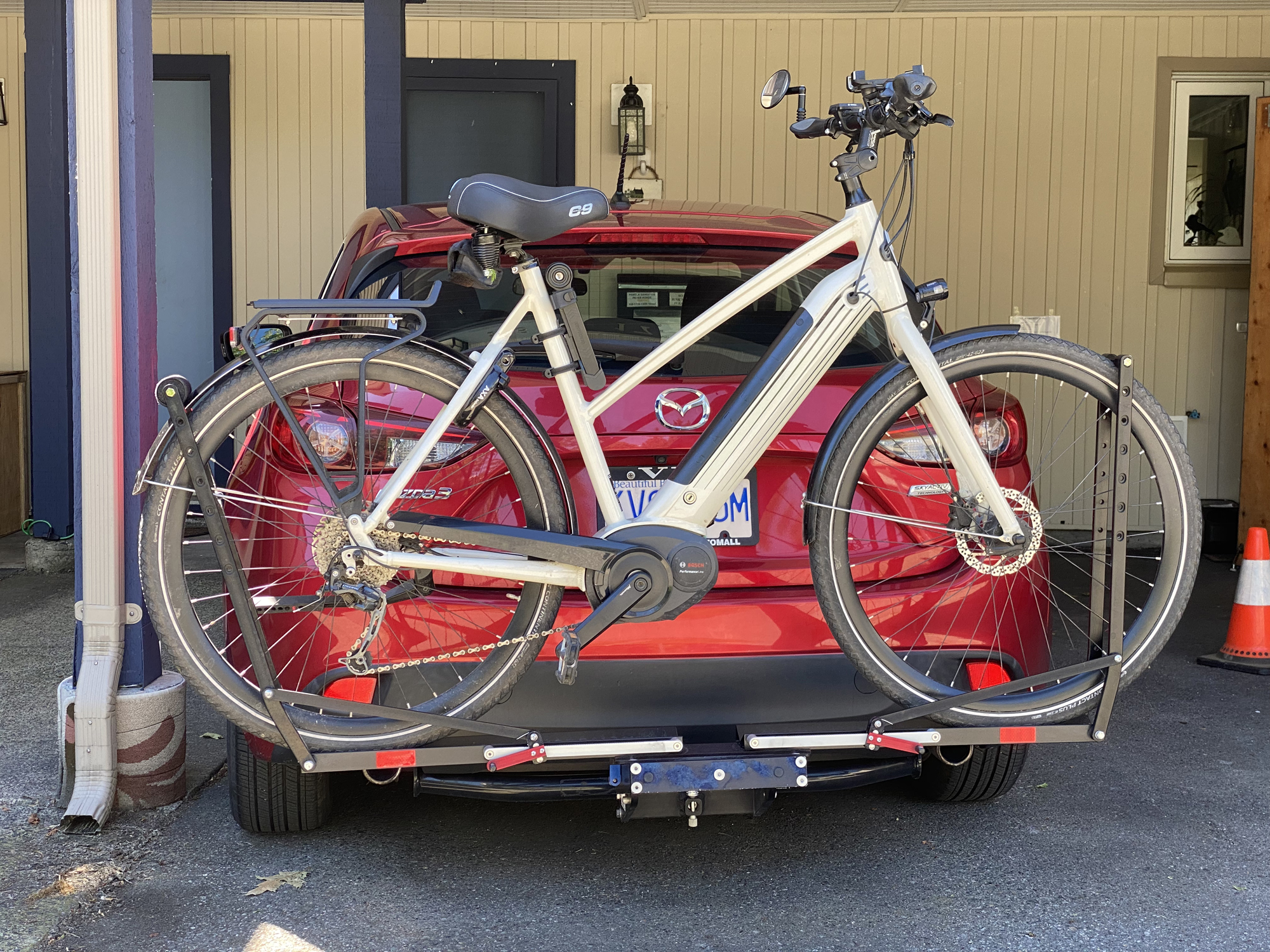

We purchased a Thule T2 Classic dual bike rack with a 2" truck receiver. Carries my low step Gazelle Ultimate C380+ beautifully. Solid, sturdy, no wiggles. I use my plastic mounting block (for mounting horses) to stand on to expend the least amount of effort into lifting the bike high enough to easily settle into the cupped wheel holder in front.
The bike is tightly and securely held by the lockable arm that hooks over and captures the front wheel. We provide extra security with straps around the bike body secured to cargo hooks in the truck's bed.

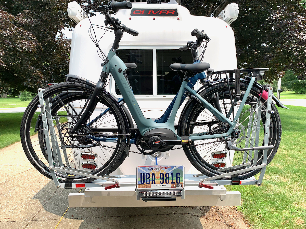

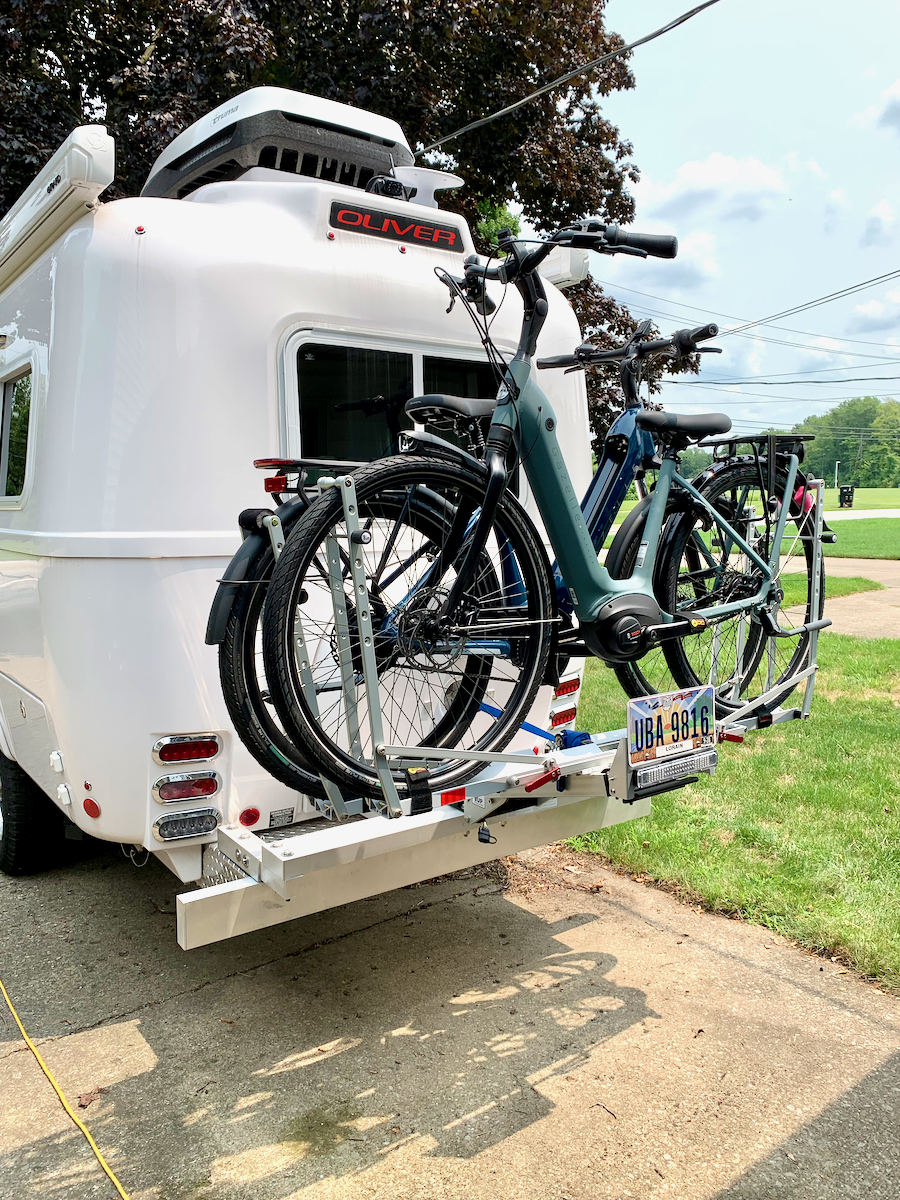

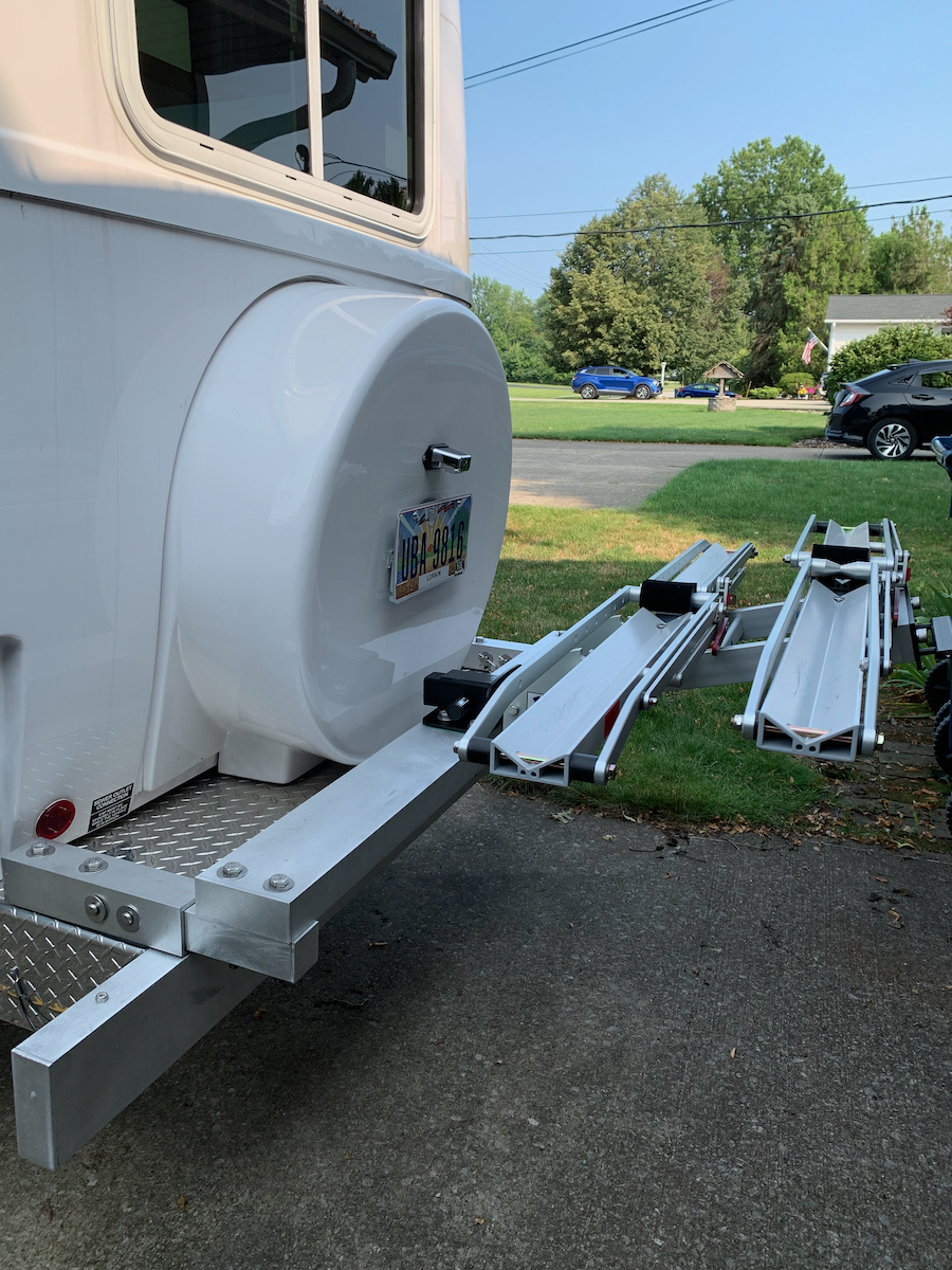

We recently bought our first e-bikes, an Ultimate C380 and Arroyo C5. In searching for bike racks that were rated for use on travel trailers and could carry two roughly 50 pound bikes, I decided on the 1UP Super Duty Double. My trailer hitch on both the trailer and my SUV are fairly high, and we're both short, so I added the long ramp to my order. I also got one Fat Tire Adaptor Kit, and mounted one to each bike rack where the rear tire would be. This accommodates the fender stays. I got the foam cushion, which works okay on the C380's aluminum fender, but deformed the C5's plastic fender. But once I added the fat tire kit, the wider aluminum tire clamp is able to slip between the fender and the tire, securely locking the bike in place.
It took a while of back and forth, and I could have saved some money if I knew up front what would work. I originally ordered the short ramp, and had to swap that for the long version. I originally ordered the matching four wheel locks, but then after later adding the fat tire kit, I had to add longer skewers for the locks. And then I added the EZ Pull handle and license plate relocation kit with lights.
The photos below were before I figured how to put the tire clamp under the C5's fender, so you'll see that U tried using a piece of split pool noodle underneath for support. That didn't really help. Going under the fender doesn't work on the C380 due to the much lower fender stay position.
