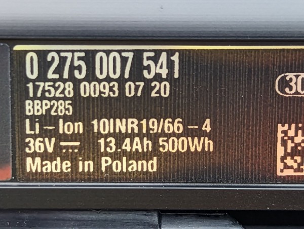

It looks like the battery is a BBP285.
If the battery is the same as my Ultimate T10+ (2022 model), you can use the battery without the cover. I got one of those neoprene covers to use while my cover was on back order, but the bike would've worked just fine without a cover.
That is very good to know.
Is was wondering if the battery cover was just cosmetic.
Thank you very much.
Based on the battery cover on my Specialized e-bike, I also thought the battery required the cover (it didn't). Still, I would feel uneasy while riding without the cover :)
Interesting to see the Bosch E-Bike battery made in my home country!
