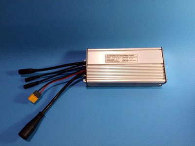

Yup! I'm a big KT fan. They are what you are looking for I believe. KT makes a 35 amp controller that is very user configurable, will tame that 1000w hub easily. It WILL need to be used with a KT display. No if's. That's not a big deal as they have some of the better displays available. This is what I'm talking about:
I am NOT promoting this vendor! I don't know them, and I've never dealt with them. It's what's in their add I'm talking about. This waterproof (WP) version of the 35a controller hasn't been available long, so not many know about it, but this IS the one you're looking for as it comes with the large Bafang end you need. I would go with one of their combo kits that include PAS sensors, brake handles, and throttle as they are super cheap and guarantee they will have the correct ends for a clean, easy, no messing around install.
I've been using the non waterproof version for the last several years running a 1000w+ MAC 12t geared hub motor. It's run flawlessly, and I can easily run at 5mph in PAS 1 if desired. Without changing a thing, at wide open throttle, I can feed the MAC about 1300 watts. All that is totally adjustable.
Regarding the display, the LCD8 color is nice, but you should be expecting some washout when riding in direct sunlight. The LCD3 model isn't as pretty, but it's every bit as functional, and is easy to see at all times. I tried a color a while back, but went back to the LCD3 as the more practical display. -Al

No computer necessary, ever! All programming is done with the up/down buttons and display. Sounds like you're after the LCD3 display.

Well, that one you posted didn’t last long. It says no longer available. Wanted to get your opinion. Will this one work?
The big difference between that new 30a style and the 35a, is the size of the case and the number of Mosfets (30a is 9 mosfets I think, and the 35a is 12 mosfets). So the 35a is quite a bit sturdier, has more reserve capacity. Would the 30a work? Probably, but speaking for myself, the reserve power available with the 35a will never be something you wish you didn't have.

35a may take a little longer to source, but with your 1000w motor, will probably be worth your time.... -Al

I did say the 30 would likely work. My logic is if he's running a 1000w motor using a 30a controller rated for 1000w max, there's no "overhead" available. The 35a is rated for up to 1500w max, would let him tow a trailer for instance, or feel free if there was a need for a little abuse if it became necessary. I think the safety margin available for the difference in price is easily worth it.
